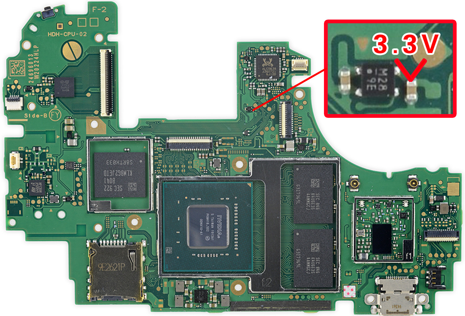

Wherre is the 3v3 point for lite?
look

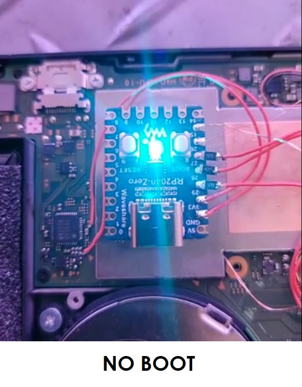

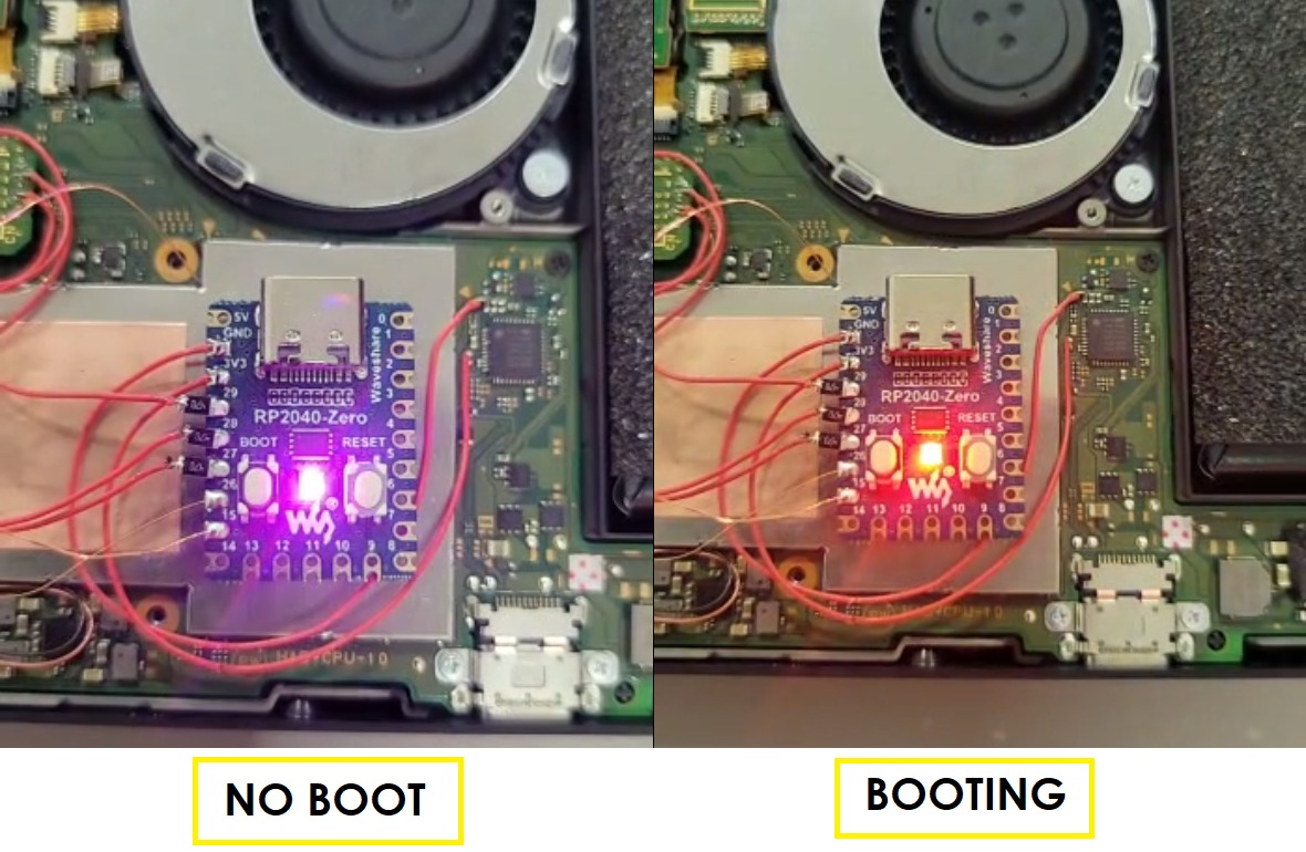

Hello Dudes!! I really don't know what to do anymore. The picofly sometimes boots and sometimes and sometimes not. I have never get the green blink.. Similarly, despite being able to get hetake to run, I am unable to run atmosphere. Does anyone have any clue as to what's going on? The device is in the latest version, 16.0.1.
  • BOOTING.mp4
    2.1 MB
  • NOBOOT.mp4
    2.1 MB
Looks like your rgb colors are flipped. Try toggling the jumper on the back
what do you mean with toggling the jumper dude? and what jumpers exactly?
Look at the installation diagrams for the rp2040, GRB/RGB jumper
If you have it bridged already like I did, unbridge it
If you don't have it bridged, then bridge it
Thanks Dude... You are the best.. Thats resolve my 1st issue... But now, i dont know why sometimes Success and Sometimes i get the code of Bad CPU pin..
I dont know what to do because of 10 attempms, 5 success and 5 bad cpu pin (without moving anyting)...
I am ussing 2 mosffet IRFHS8342 (1 per each Cap)... Should i use only one?
This is a LCD V2....
¿Any Ideas?
