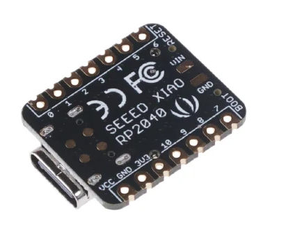

So here is summary of my experiments so far:
-two transistors, one back and one front, no SDA and SCL: glitch
-two transistors, one back and one front, SDA and SCL: glitch
-one transistor on back, SDA and SCL: glitch
-one transistor on back, SDA and SCL: no glitch
-one transistor on front, no SDA and SCL: no glitch
-one transistor on front, SDA and SCL: no glitch
Those were all with the XIAO board, so assuming it needed a second transistor I installed the Waveshare board back and all I got was blinking blue light for few minutes ending with 3 shot yellow blinks 3 times. I believe this means it ran out of attempts.
Back to the XIAO board, but this time I removed the USB port, shield and buttons in preparation for permanent install and what do you know, now the XIAO board is not glitching either. It behaves just like the Waveshere did. What the hell.
Does the heat from disordering the unnecessary parts messes up those board somehow, they seem to be functional?
One more observation. After removing the APU heat pipe, the Switch now glitches with the XIAO. May not be board flex; I placed back the 3 screws that hold the chiller and it still works. Maybe the APU side MOSFET is shorting somehow?

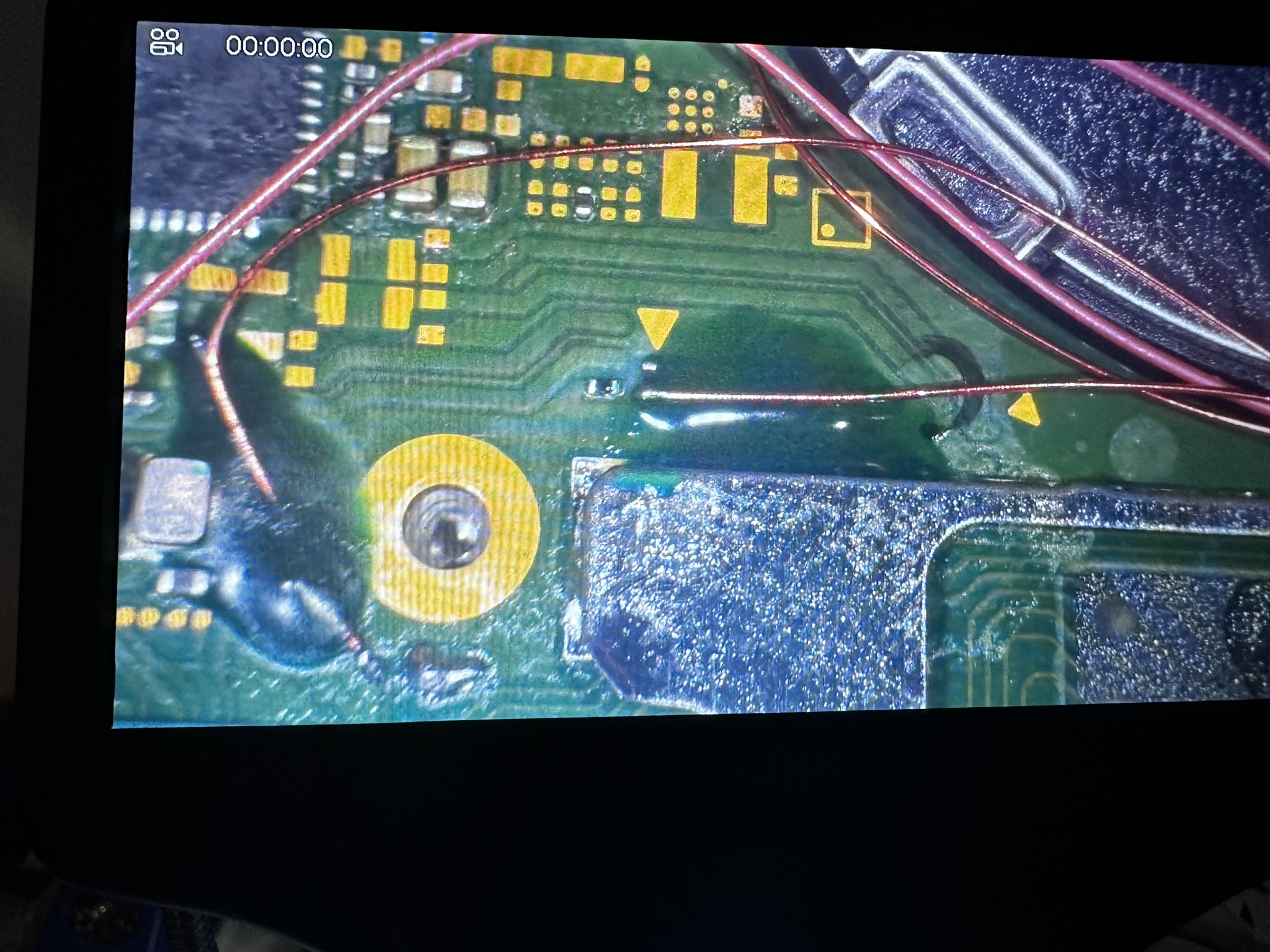

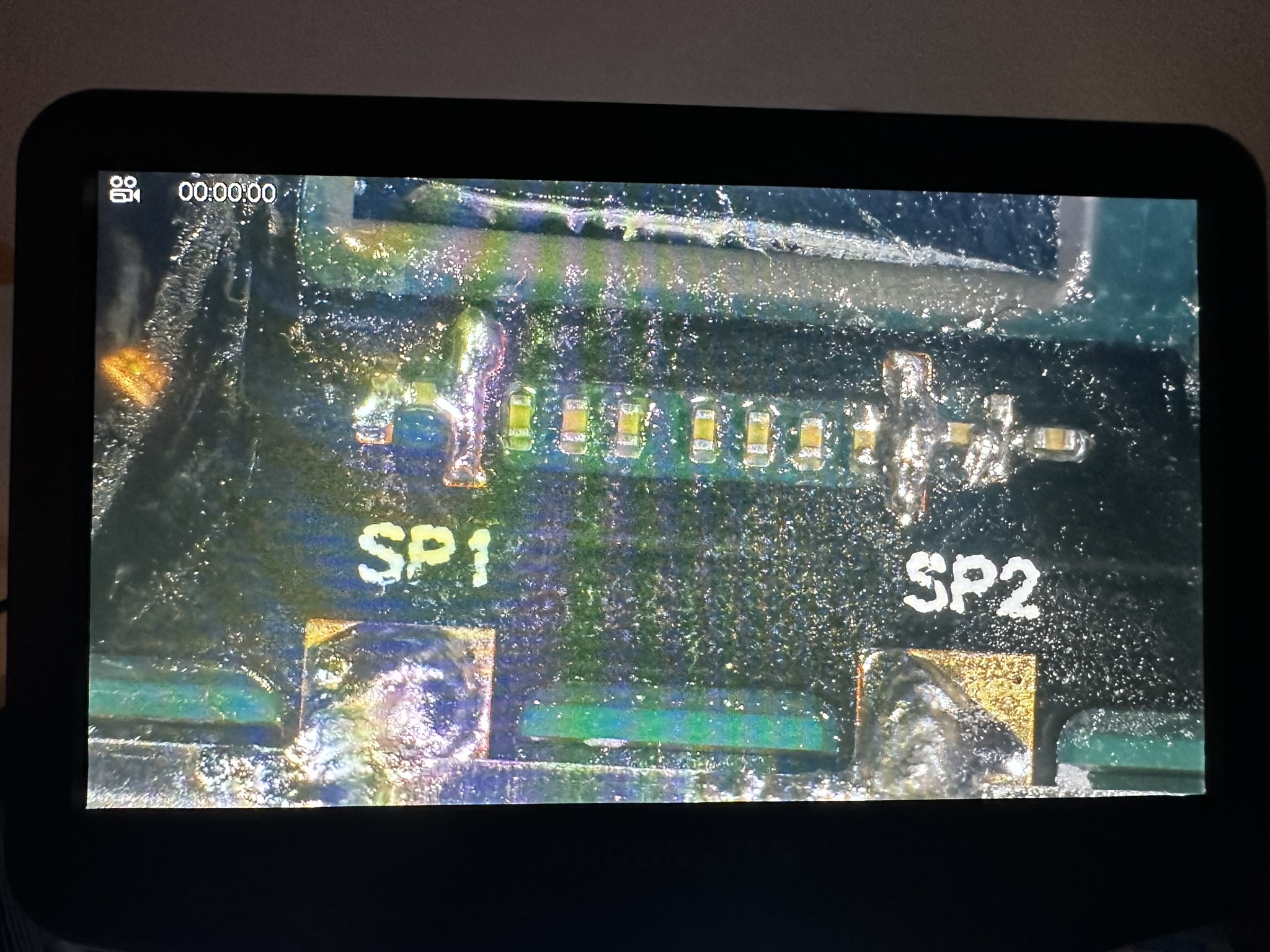

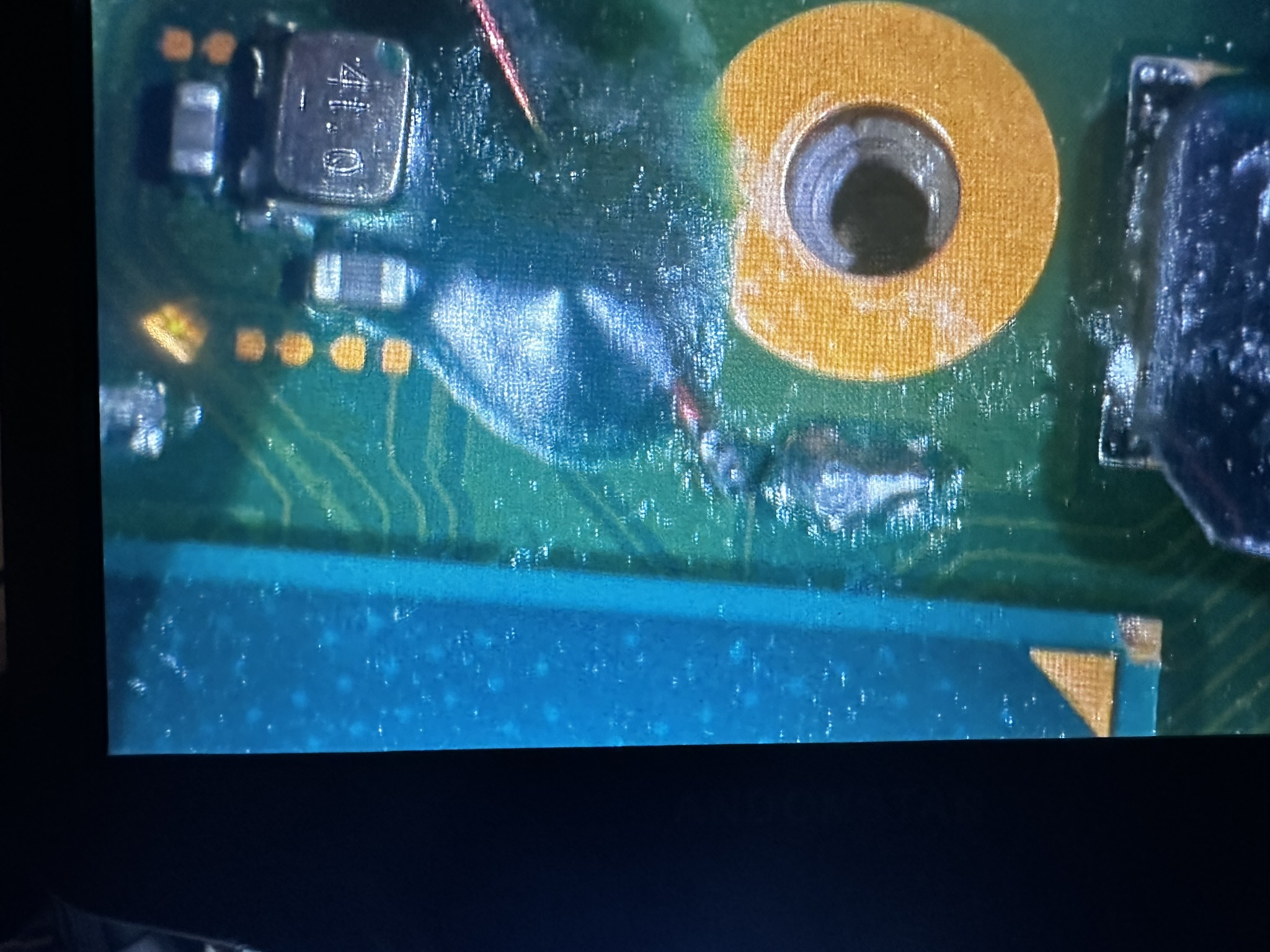

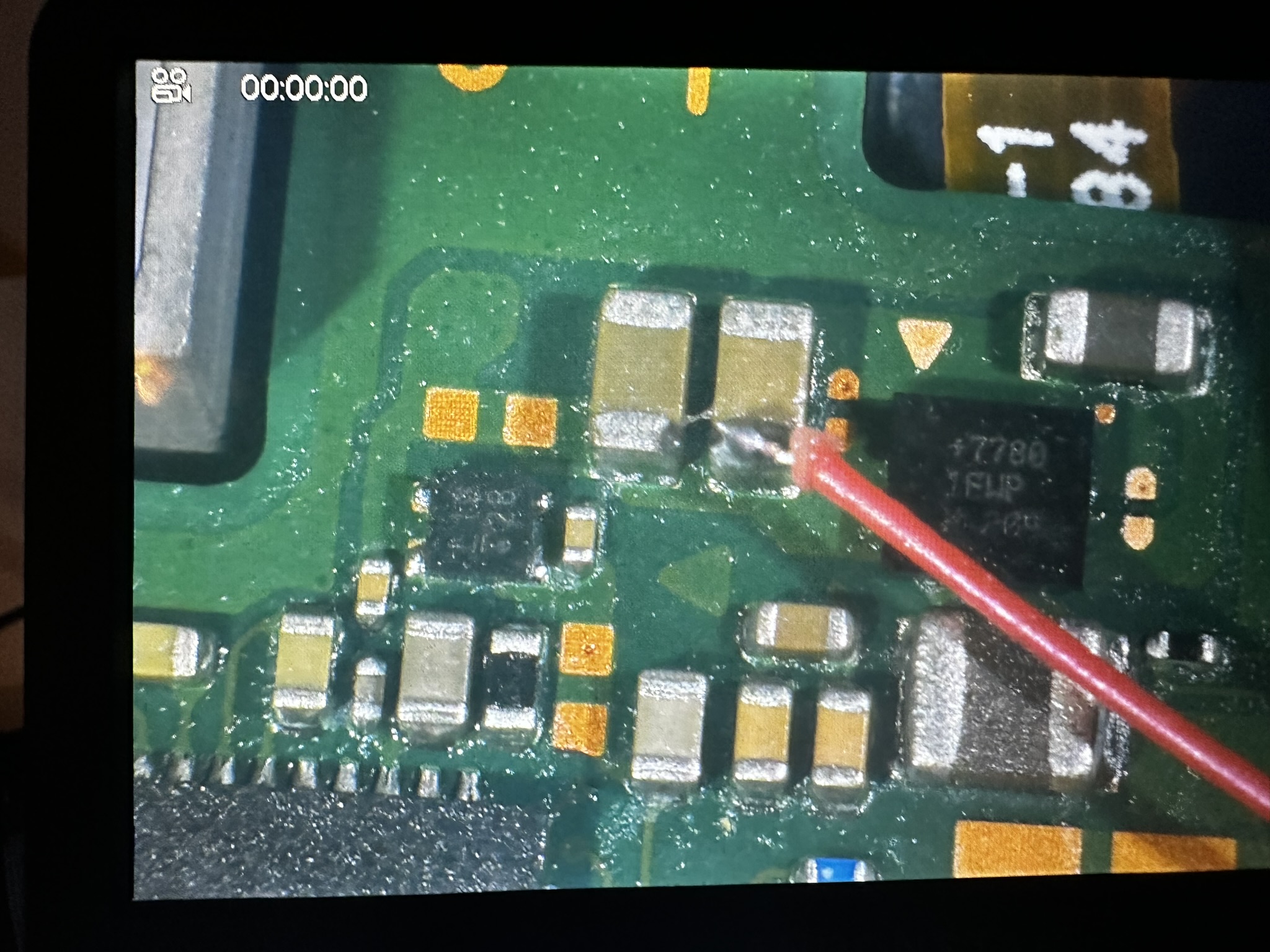

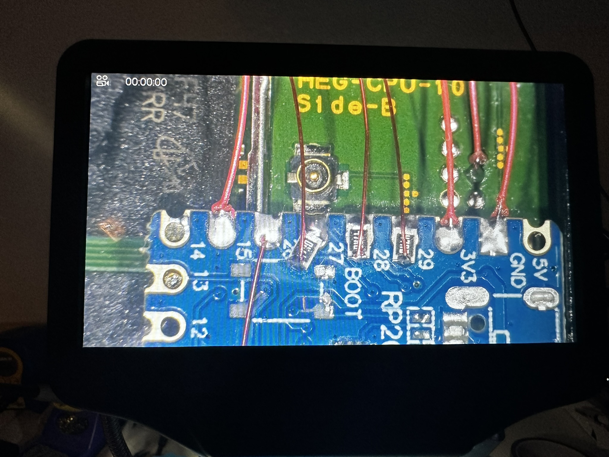

Getting No eMMC CMD1 request, what should I do to try and see if I could fix it? i made sure my install was pretty clean so I'm wondering whats going on. It turns on most of the time, but sometimes it doesn't. Any help? Thanks
Edit, rewired the clk and seemed to fix it

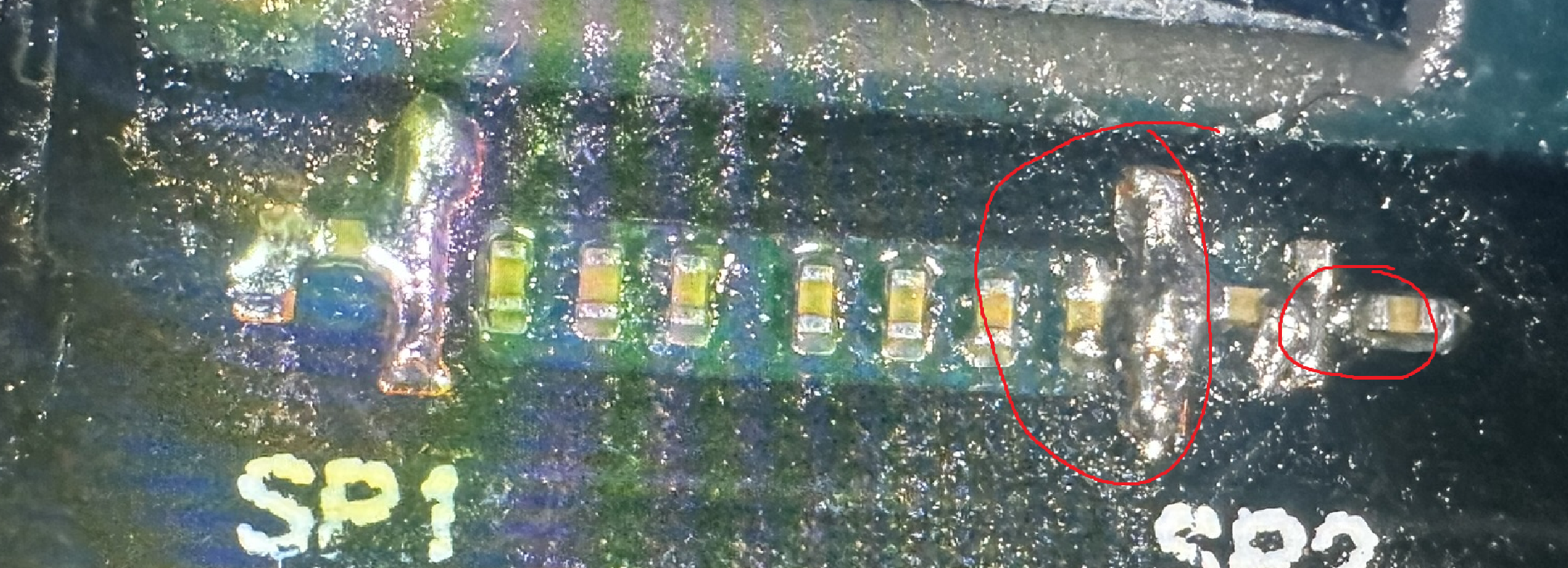

SP2 looks bridged
edit: didn't see your edit :P

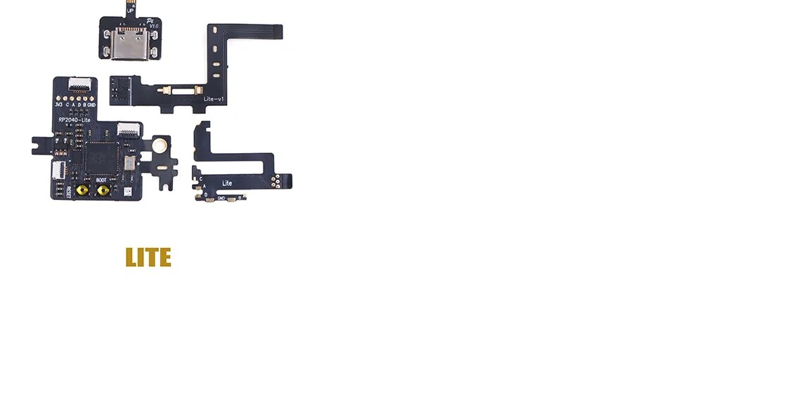

WIll be trying my first switch lite mod in the coming weeks. Got a switch lite (in a few days)
Is there any consensus if a flex install such as the full flex solder version for the lite is easier that a generic rp2040 +resistors with or without flex CPU cable / mosfet, is easier or more successful.
at glitching, I assume the flex versions have the correct resistor value already installed.

Cool, Is there any consensus to the mod type, as per the above (full) flex or cpu flex or fet. I have found a good and cheap source for Rp2040 in Europe (radionics) so should be able to attempt that method faster than I can get one from ali etc. Just not sure if all adapters follow the same pinout
