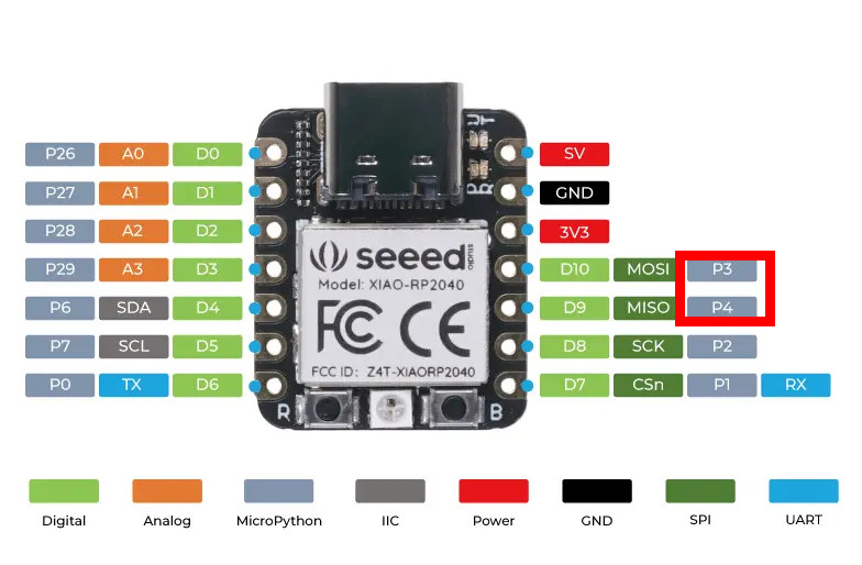

I guess I got lucky with just the one and perhaps the SDA and SCL connections were helping too. For a while at least. Unfortunately, no one seems to know where are those on the XIAO.
I prefer not to have to touch the MB and the APU if it can be avoided, those ribbon cable connectors are one snap away from biting the dust.

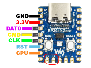

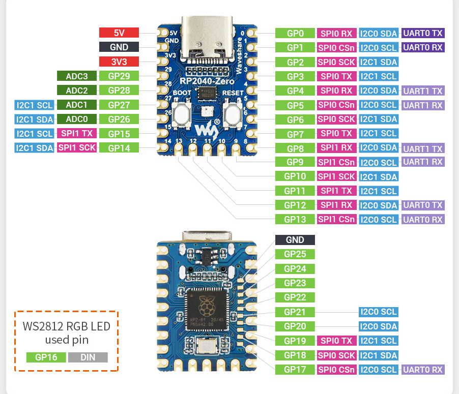

Thanks again! Now I wonder if I had those incorrectly connected on the original RP2040, though there should be no ambiguity with those I think:
I do believe rp2040-zero SDA SCL been confirmed working already on those pins.

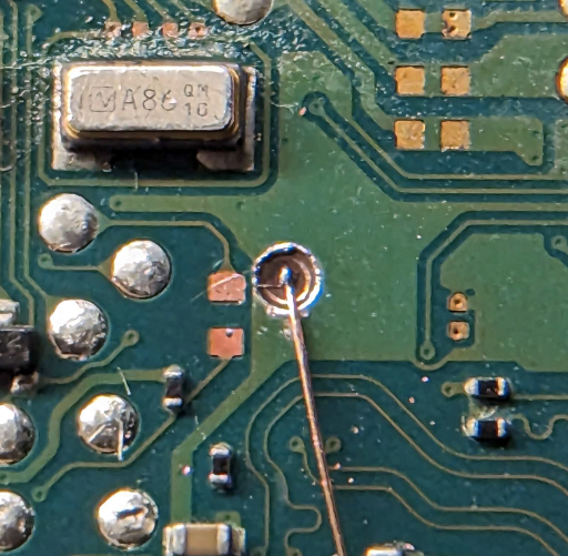

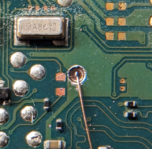

This is no secret since the schematics are all over the web. I'd suggest you go with the back point if you're into this since that one has clear area.
So, finally, we've got the alternative DAT0 point no need to dig into the motherboard?
Why doesn't this important discovery get enough attention already?

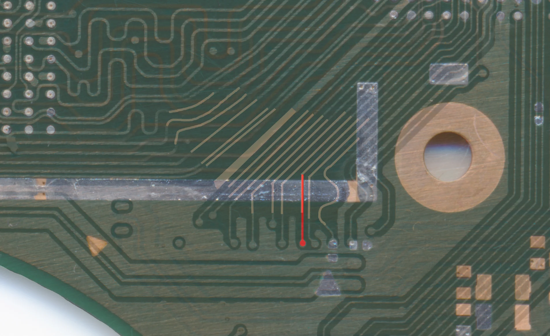

Does this point really work? (dat0 oled)
I ve looked at schematics on the back of the board and these traces are not exposed. on what layer is this? Looks like you still have to dig for them
Its on 3rd layer so yes you need to dig through 2 other copper layers.
Like I said, its no secret some already did it months ago you people are just slow.
i only know about emmc point, and the front drill thing:
I assume its the same spot? Idk i havent payed attention to schematics since they load really slow in my browser.
I havent touched this subject to do my research bcs i did not care for oled until now, but now i have oled and i wanna do it. I think ill still go with emmc reball method since i feel like its safer. Whereas with this if you re in the wrong spot by 5mm you re kinda ruined.
