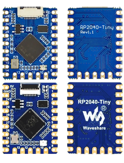

Anyone have tried some RP2040tiny clone ?
I have trouble with programmation, no led reaction on last FW and led stay green on an old one.
If some have a solution ? :)
Thanks

The LED signaling seem to work ok on clones as long as they are on fw v.2.67.
So I would suggest that you flash v.2.67, finish the installation, do the troubleshooting (if needed) and then, after you confirm that everything is working, flash the latest firmware from the toolbox in Hekate.

I got a batch of those. The led doesn't light up with 2.75 for some reason. Another user suggested using 2.67 for the troubleshooting codes. If it checks out ok and glitches, just flash the latest firmware through picofly toolbox.

In 2.67 the red/blue flash led and finished on green and remains on green ( does not turn off ). And flash with pico toolbox in 2.73, no more led.
And In 2.67 I encounter a problem with the sd card detection boot.
Does the glitch work though? Using 2.67 is more for troubleshooting. Find the color codes if there's an error. If you can get into Hekate you are golden. And yes the LED won't work on 2.75. You don't need it if it's working, it's just the to look pretty and show off lol. I thought my install was bad cause I had no lights, but got the no SD screen.

Well, green is for success in 2.67. It might not turn off because as we know these clones don't communicate well with LED.
The main thing is, as @bvang913 stated above, does the glitch work (does it show noSD screen)?
In 2.73 works fine, but in 2.67 I had SD card boot initialization errors. I check the SD card connector.
