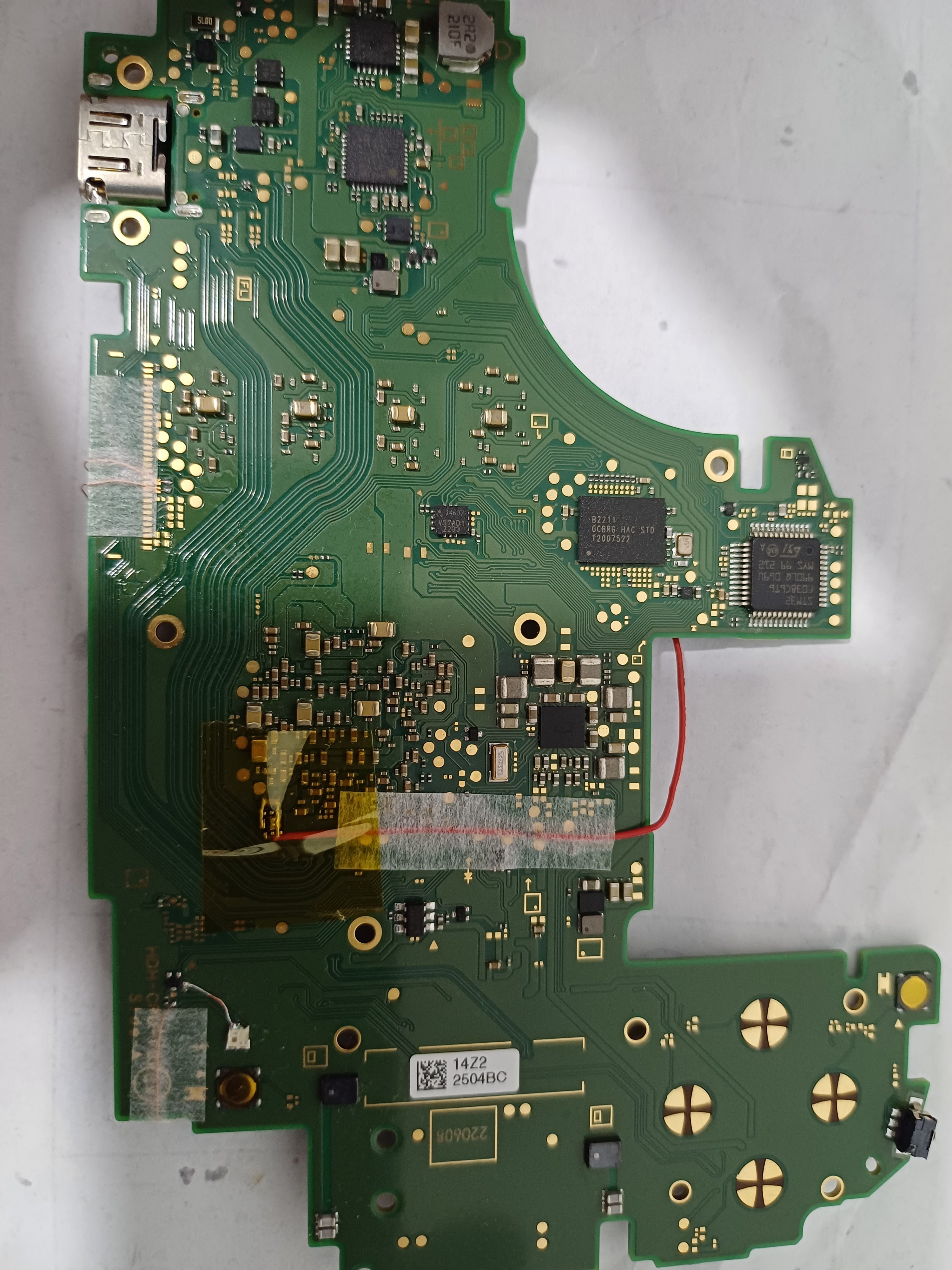

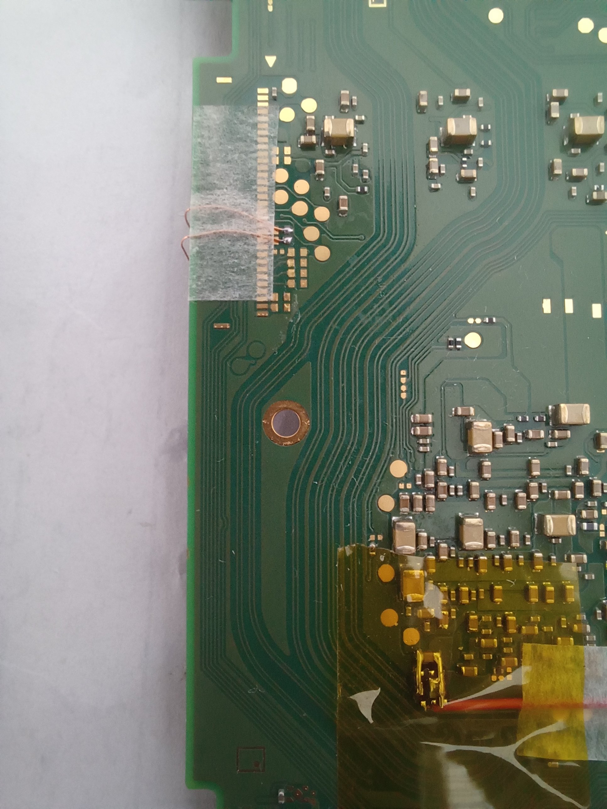

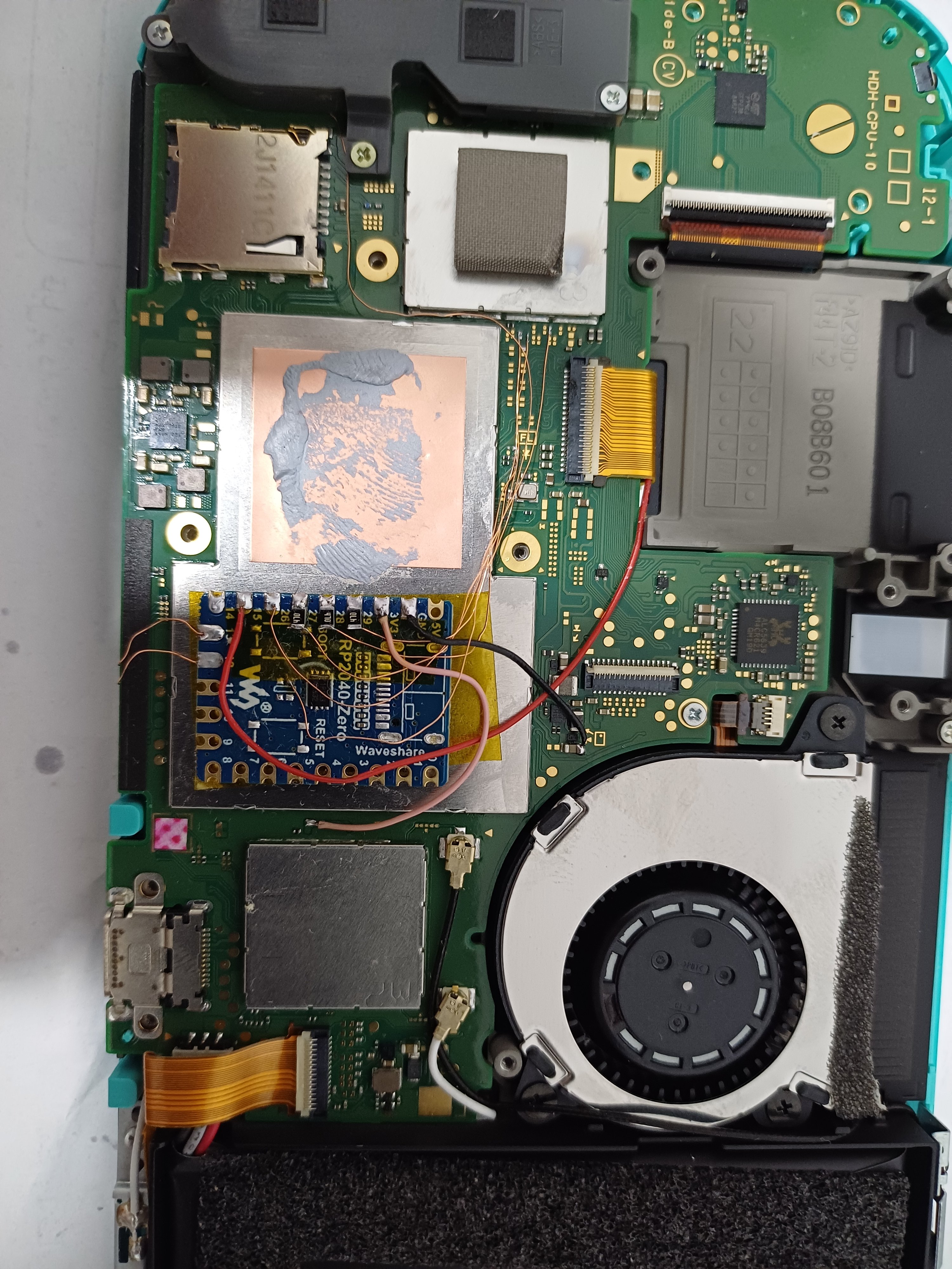

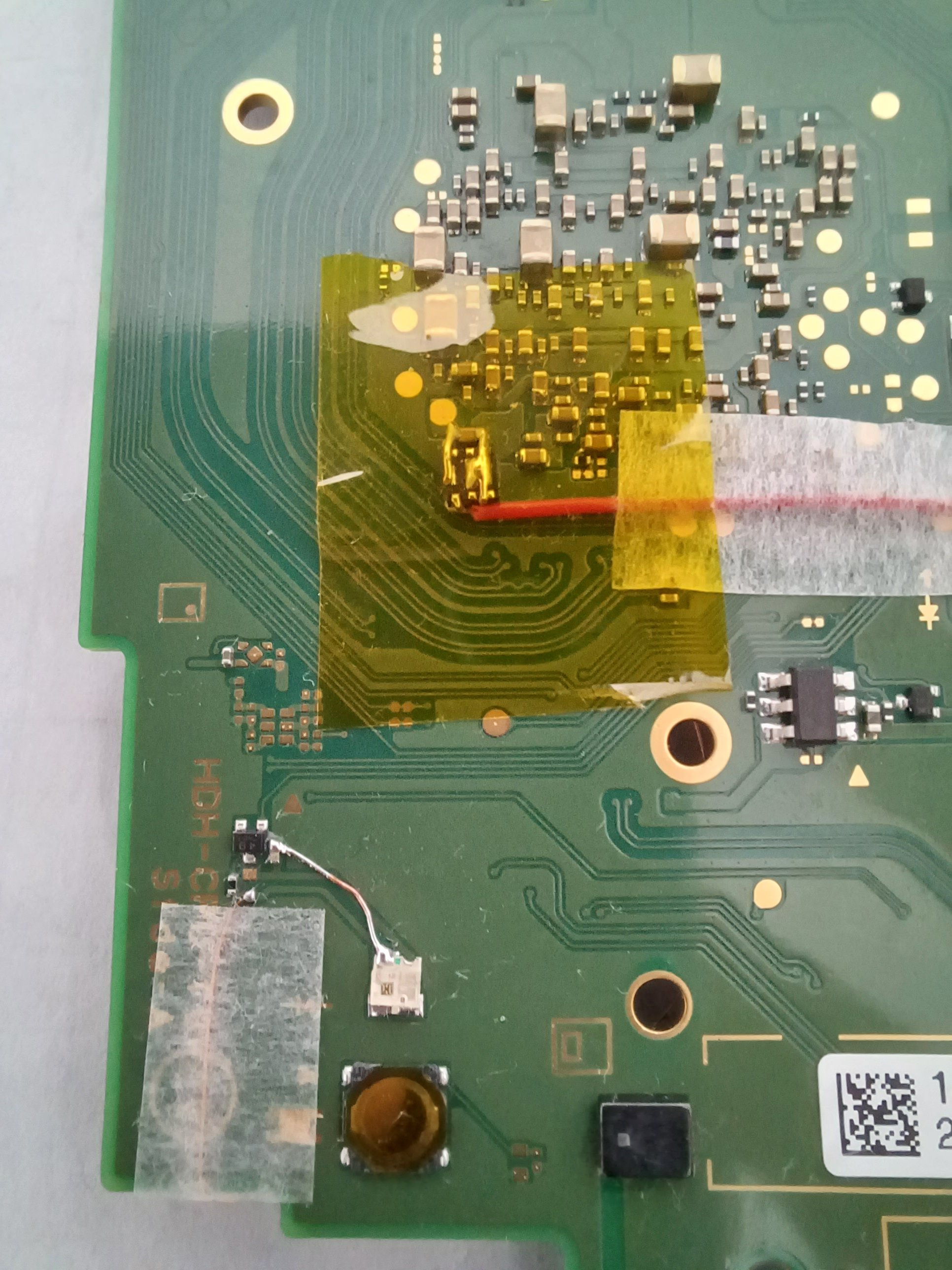

Hey all - so I've done the mod on a Switch Lite -- and there is good news, and bad news.
The good news: the switch turns on and works as intended still.
The bad news: the RP2040-zero doesn't seem to turn on?? It's getting 3V's though (measured with my DMM), so it's not for a lack of energy. There's no indication from the RGB-led on the front of the board, and the Switch just goes straight to the regular OS, no error-messages or anything.
Where should I start to look for the problem? Could it be that my flash of firmware to the RP2040 didn't stick? Or I managed to ERASE it somehow??
Here's some pictures of my mod, as it is currently.
not sure why you prefer led side facing down and red cable/3.3v line seems easy to contact to metal shield ground.
What is that wire jumper you made on the left side of the pico between USB and some point at the bottom of it?
