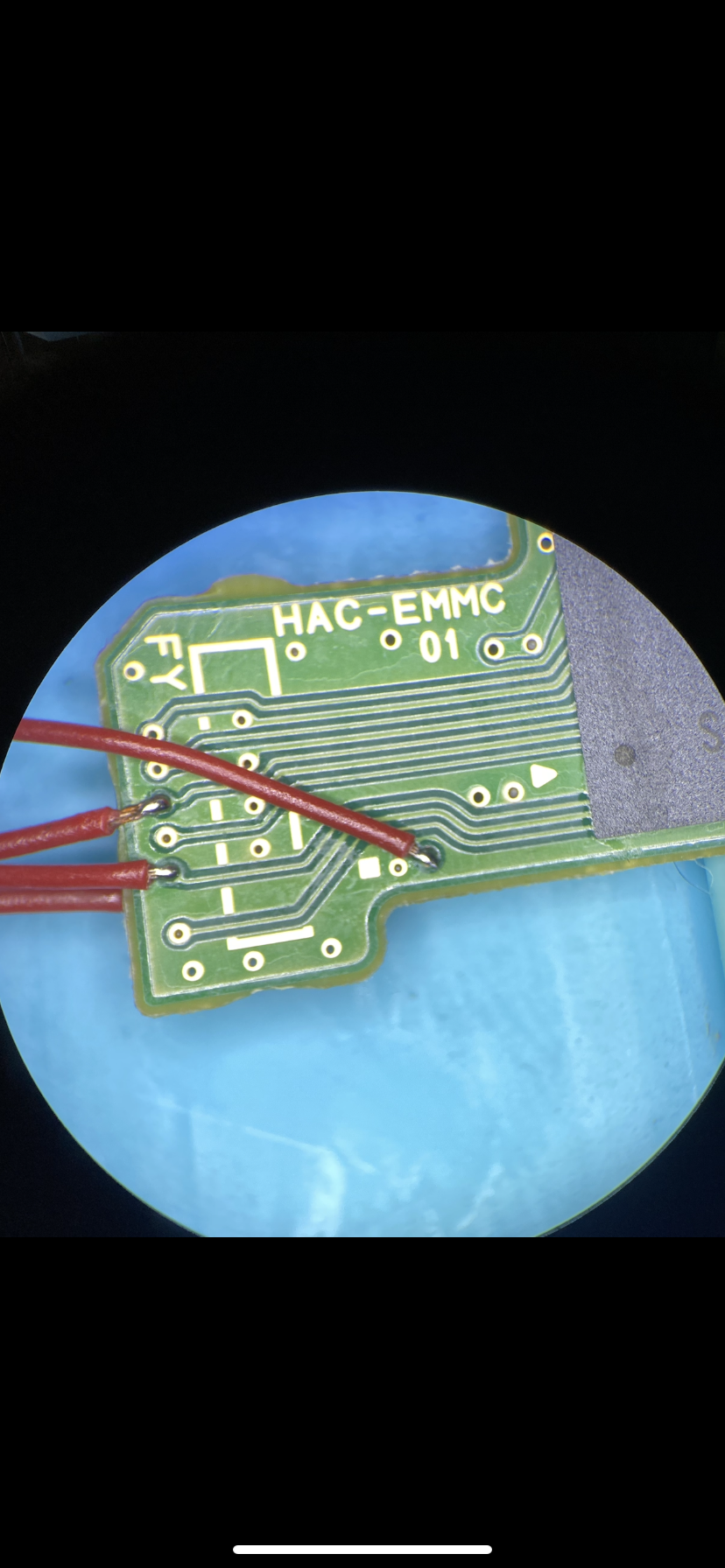

Ok so I'm a bit lost with this one so I removed the chip and all wiring.
I've just checked the tiny caps on the APU and the almost the entire row is showing continuity accross the caps.
I've turned the board over and found that many of the big caps on the other side of the APU appear to be shorted too.
I'm confident that all my solder work went according to plan while installing the mod so I'm a bit lost as to how this could've happened.
Is this a dead APU? If it is then I can't understand how that could happen during a straight forward install and I'm hoping someone can point me in the direction of a fix.

So, anyhoo.. after thinking anything and everything else was wrong with this board and assuming the worst I decided to bite the bullet and try reballing the eMMC again..
Please see attached pic and promise not to laugh!!!!!!.. 😅
Hahahahaha
Its pin 3 not 4 ;-)
U wanna hear something funny I've done the same thing on my first reball :-)
But I saw it right before I reflowed the chip :-)

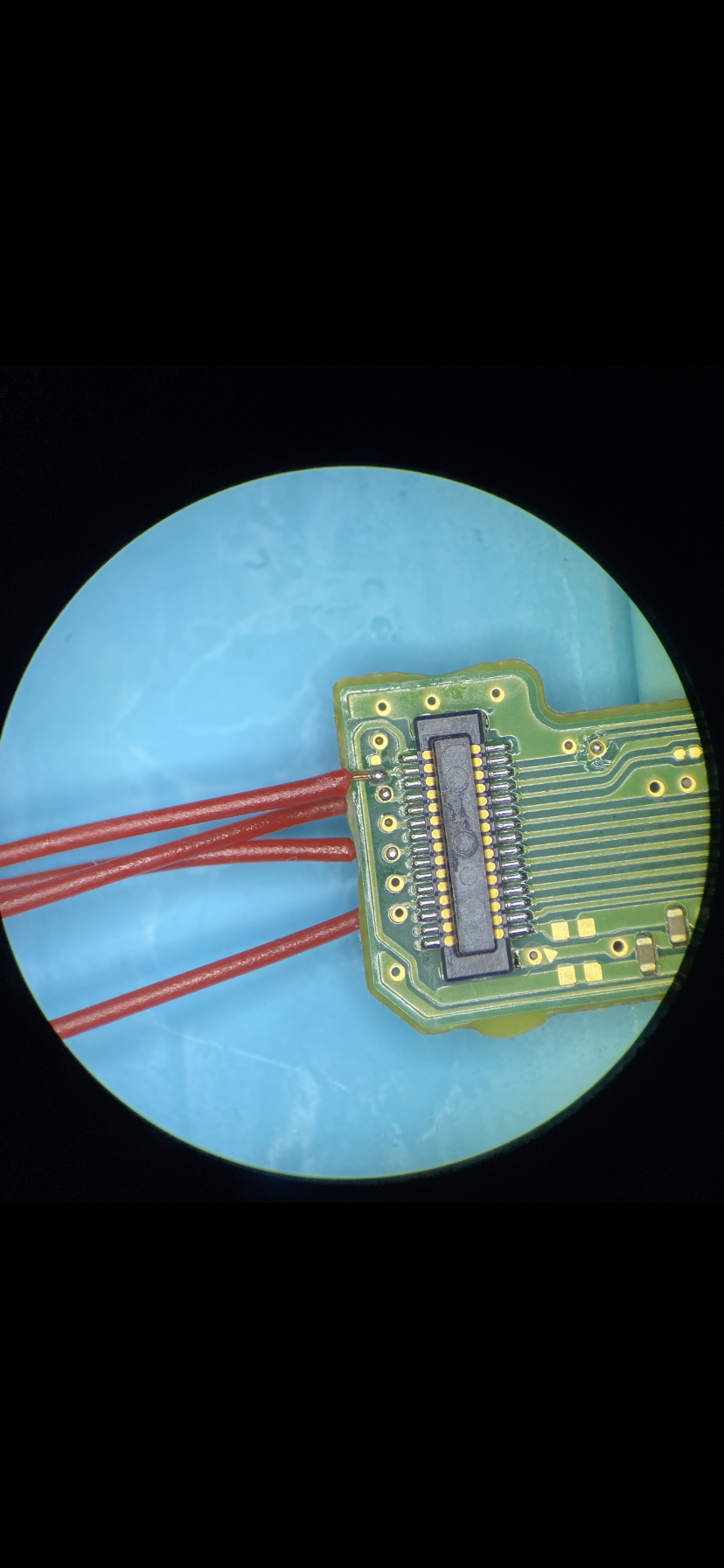

Hey, I have the same error as you. Did you get it glitching?
Yes, I reballed it after correcting the DAT0 point and all was well 👍🏼
Edit: I've just seen your other post on the other picofly thread..
When I reinstalled the chip I found the CLK line also could've been better.
If you're having issues try taking it off and replacing it with a thin enameled wire. I find it to be lighter and puts less stress on the CLK point.
I realise you've sealed it in solder mask but that should come off fairly easily if you poke at it gently with a needle. Don't push too hard or you could damage the connection. Just push hard enough until you see the solder mask begin to flake off.

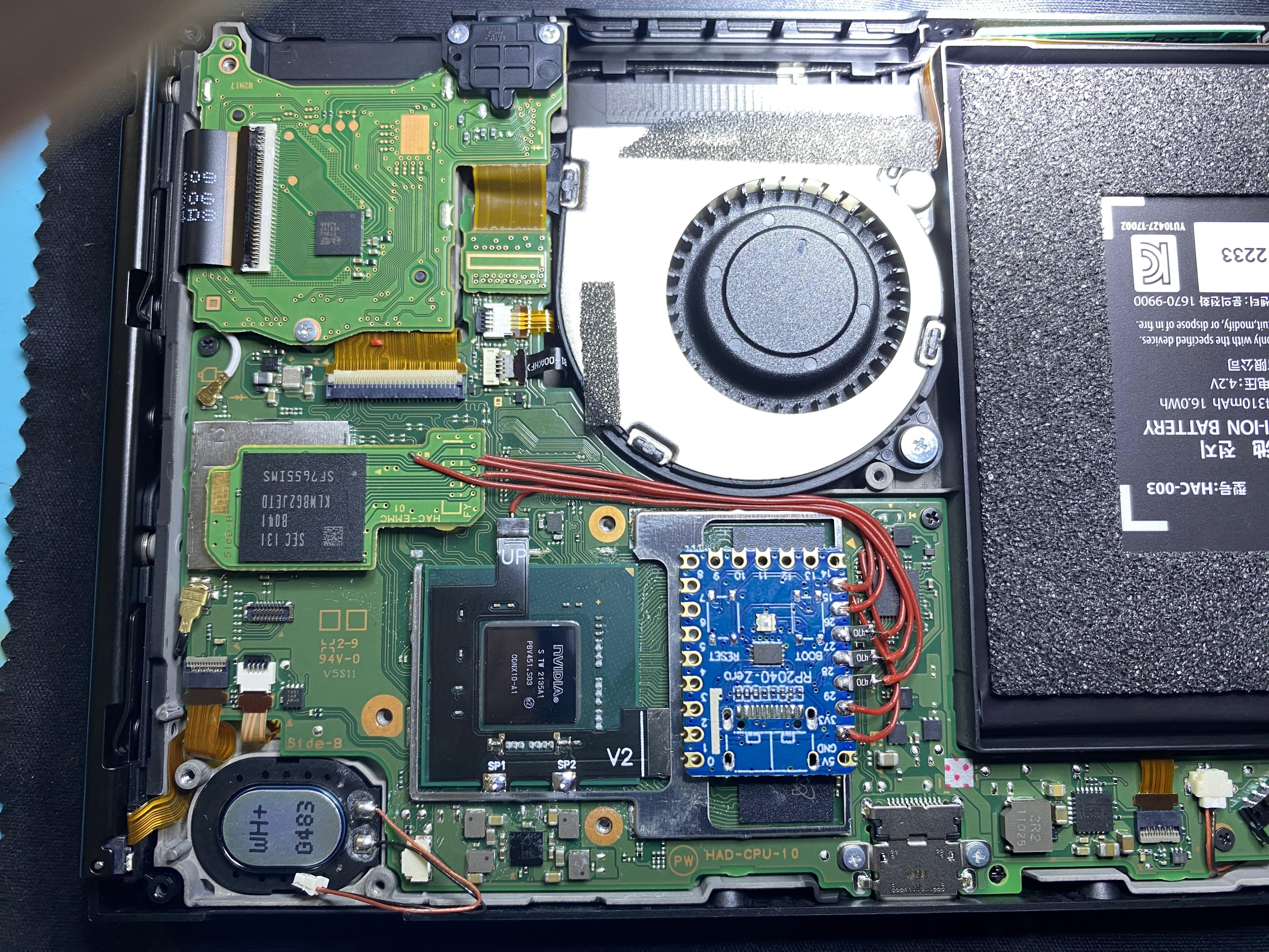

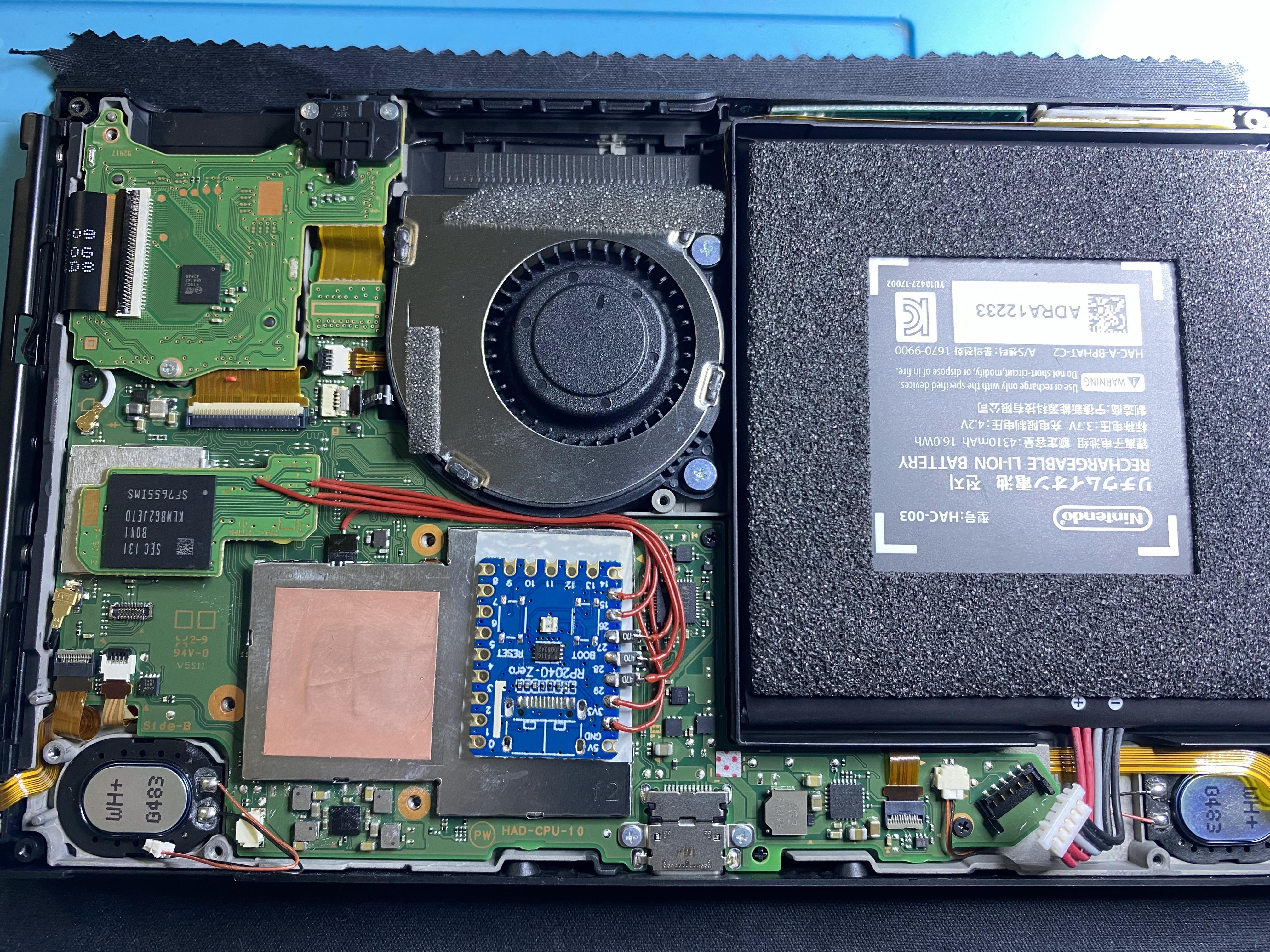

Where's the resistors? Or the lite doesn't need? More pics of your entire install for me?! Pls? :). U could pm them would be even better 😊
All picofly installations need to have resistors on all the 3 lines. He is using the RP2040-Tiny which has the resistors included (3pcs of 47r0).
The installation is the same as RP2040-Zero so you can use the same pictures from any previous installations you find here in forum.
Reactions: O_xTanjax_O
Oh okay I didn't even realize. I have the guide with the install n such. Honestly wish I bought the tiny now. Looks cleaner (obviously(
The installation is the same as RP2040-Zero so you can use that same pictures from any previous installations you find here in forum.

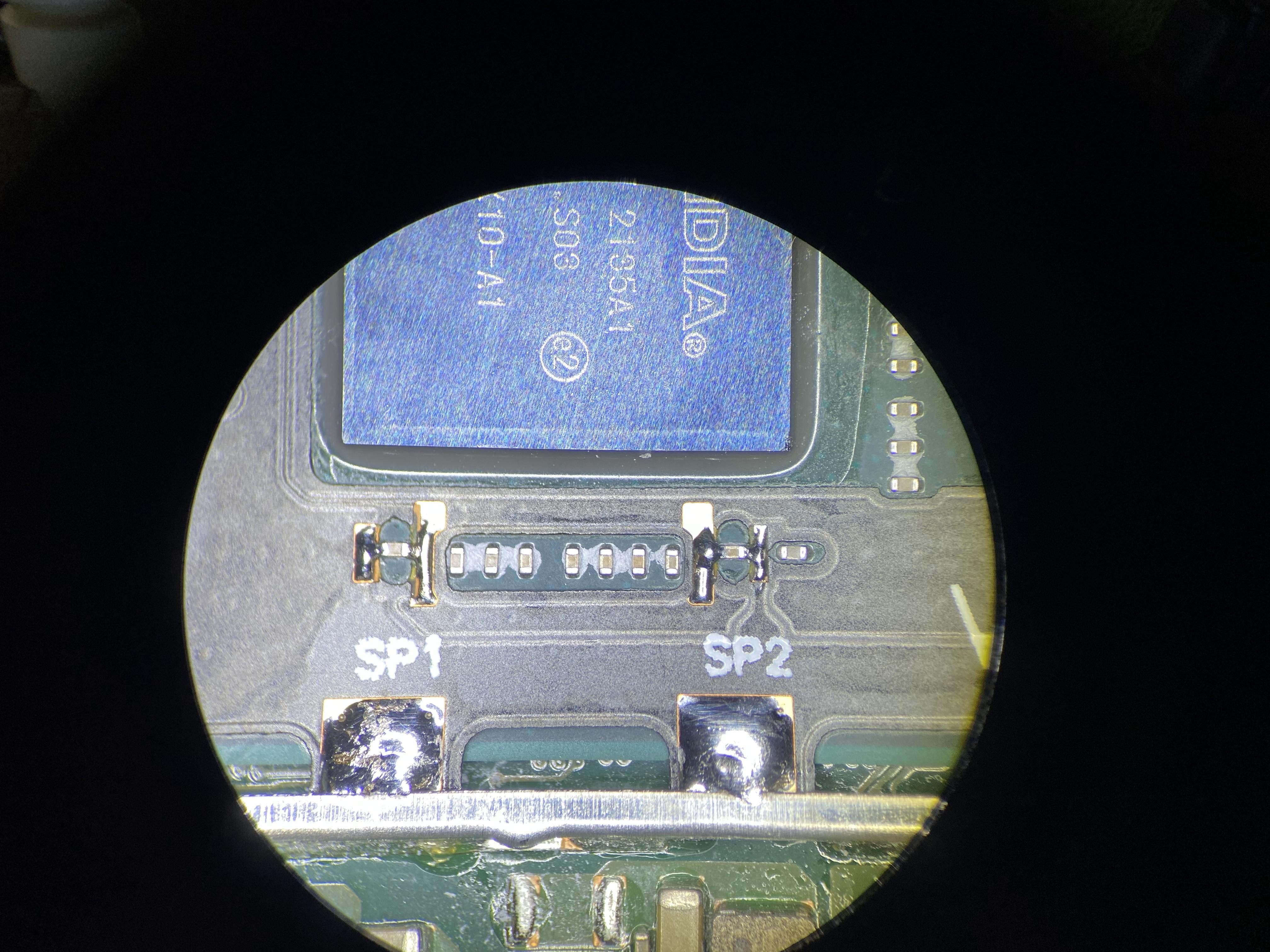

Hi.
Some time ago I had a problem with a V1 Switch that had the Orange Screen error after installing Picofly. If I launched atmosphere, it displayed the 2 Atmosphere screens (text and logo), and then Black Screen, and after some seconds, Orange Screen. If I booted System Firmware bypassing picofly and hekate pushing VOL+ & -, black screen and then Orange Screen.
I've made quite a few successful installations before and never had this problem. I also have 20+ years of microsoldering experience, so I can make clean installations and clean soldering points.
I thought the orange screen was a problem with the Wifi chip, even if I didn't damaged any traces or pads making the installation.
So I desoldered everything and tried to boot the switch. It was kind of weird, now with all the hours I've been in front of this console, I can't rememberif it booted or not. I think not, but it booted into Recovery Mode. Under recovery mode, I made a "Reset preserving saves & accounts" and it did it successfully. Then I entered recovery mode and did a system upgrade. It searched for all the wifi networks, I connected to mine, and it downloaded the firmware with no problems.
I did a couple of bootings / powering offs of the console and everything now looked fine and working properly.
So, discarding the wifi chip, I made a new picofly installation, triple checking every single solder point. So, I prepare the SD with all the updated files. Hekate loads up fine. Atmophere shows both screens, and then the Nintendo Switch & Logo screen appears, and it hangs there. No black screen, no Orange Screen. I stays there.
If I boot System Firmware bypassing Picofly, the same happens. Nintendo logo, then Nintendo Switch & Logo screen, and it stays there.
Under Hekate, I went to Nand Info and everything looks fine, BUT, I clicked on "Benchmark", and it starts benchmarking, but halfway it gives an error and forces me to press any key to exit.
So, is the eMMC the problem? Can it be fixed? I saw a program called EmmcHaccGen that I think it can rebuild and flash a new nand. Should I use that?
Thanks a lot for all the help you can provide me. I'm desperate with this console.
EDIT / UPDATE: I tried another MicroSD brand and now after the Nintendo Switch Logo, instead of hanging there, I get an Atmosphere error with Error Code: 2002-3539.
I looked for that error, and I read that 2002 is a Filesystem error. So maybe I'm right and the eMMC is corrupted? Should I try to flash it with any program?
