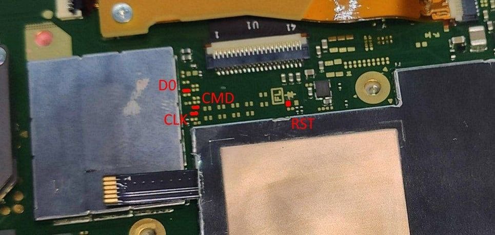

i damaged the right pin point of Dat0. Accidentally pulled the wire with the right pad of dat0. Where is the alternative dat0 so i can connect the left point which still exist? or where is the alternative dat0 for lite, i saw it here but can not find it anymore...

thank you. its turning on now...i was cleaning the flux with cotton buds and pushed it hard and the pad came off😥
I think everyone have this kind of experience before :D
Especially when its still hot. Alcohol cold and the pad hot, it will make the pad easier to be ripped of.

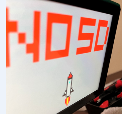

Hello all. I just installed a chip in my guy from aliexpress...RP 2040 core , for my V2 Mariko non OLED just regular.
When I booted it up, I didn't get the NO SD with the cool pico fly logo, just NO SD in red with a rocketship. Does this mean i'm not using picofly firmware?
I ran the toolbox, and it just says
Reading firmware info...
Press any Key
and when I press any key nothing...
Not too concerned, because everything seems to be working, but wondering what version of firmware this indeed came with.

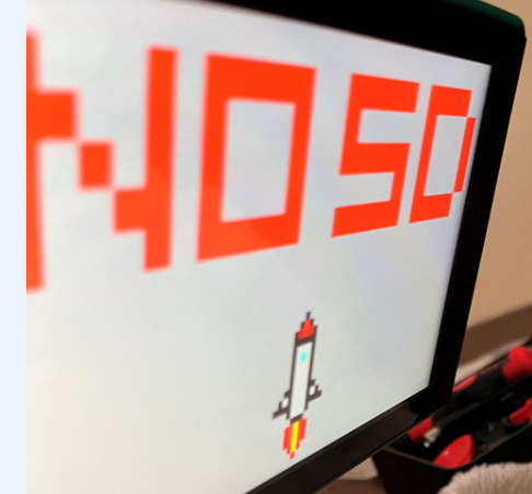

Press any Key
That is InstinctNX firmware if I'm not mistaken.

That is not an original picofly firmware.
The firmware itself is opensource.
So anyone could modify it by themselves.
It seems it modified the code using spacecraft-nx.
