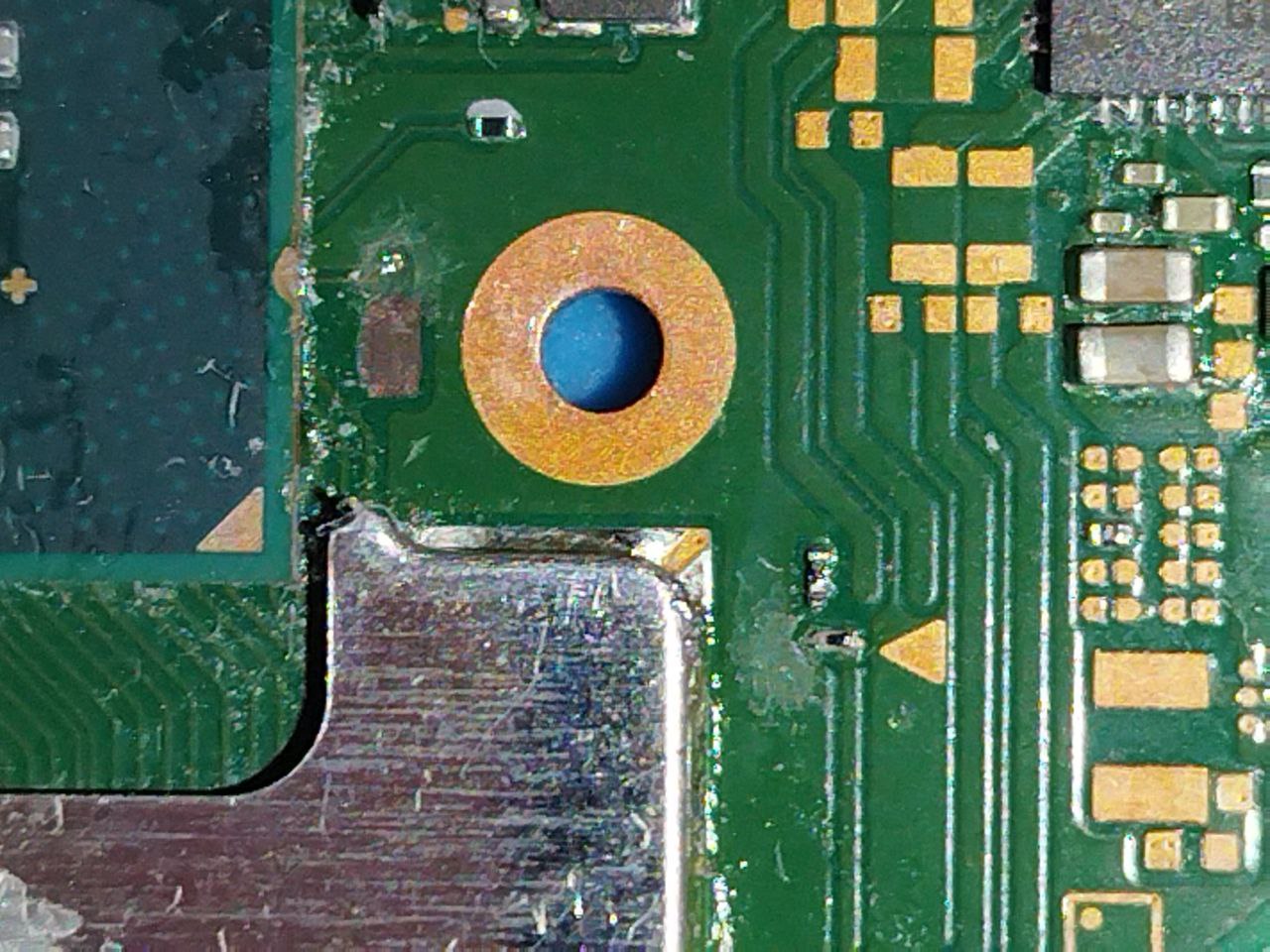

Okay there are the pics:
This my poor attempt at re-soldering a resistor that I grabbed from the 2040Zero, but that thing is so small I don't know if that did something honestly.

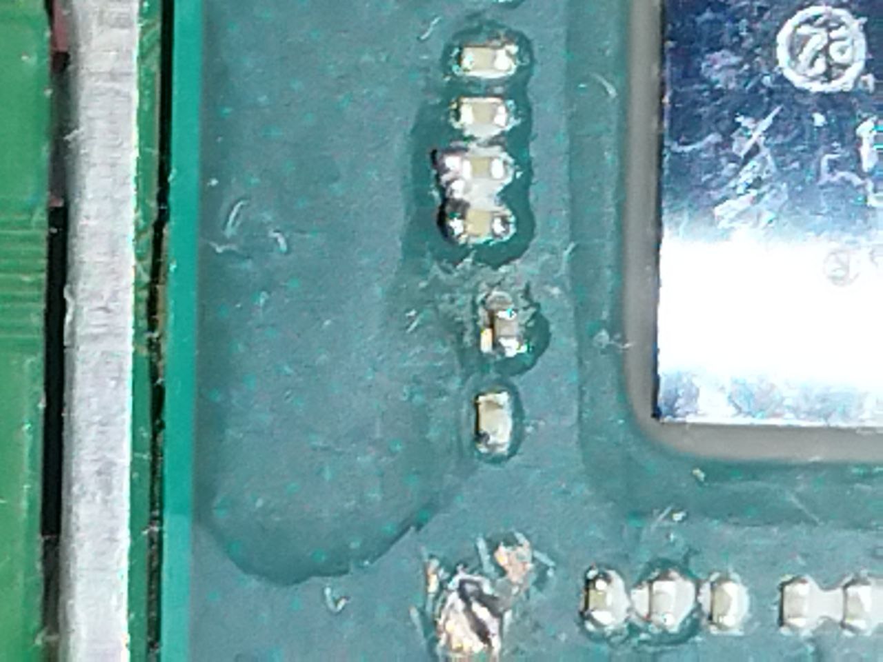

Below is my CMD + exposed CLK point:
From what I can see, I probably fried the CMD resistor. Can i use a 0805 one? I have a lot of them around.
Edit: I was dumb and tried the mod with a larger tip than I should've used, I have some good ones here that are very small so hopefully these will help.

well u can use a smaller on but u need to be able to make a connection between both vias.
why did u rip if that ground pad? poor switch .
u can use any size of resistor u just need to get then to fit and make proper connection
u need to be a bit more carefull with the pads around ur solder use a finer tip and flux .
