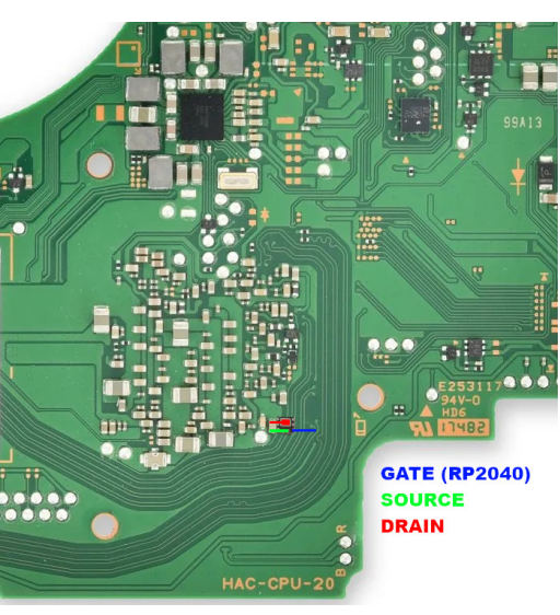

Any problems with the front MB mosfet mounting so far? Im going to finish a V1 , 1 mosfet, 0.1 enameled wire tomorrow. hope it will work and there will be no problems in the long run.
I did it for V2, Oled and Lite. There are no problem but 0.1mm is kind a thin. Side note; you can use test point near that capacitor to mount mosfet.

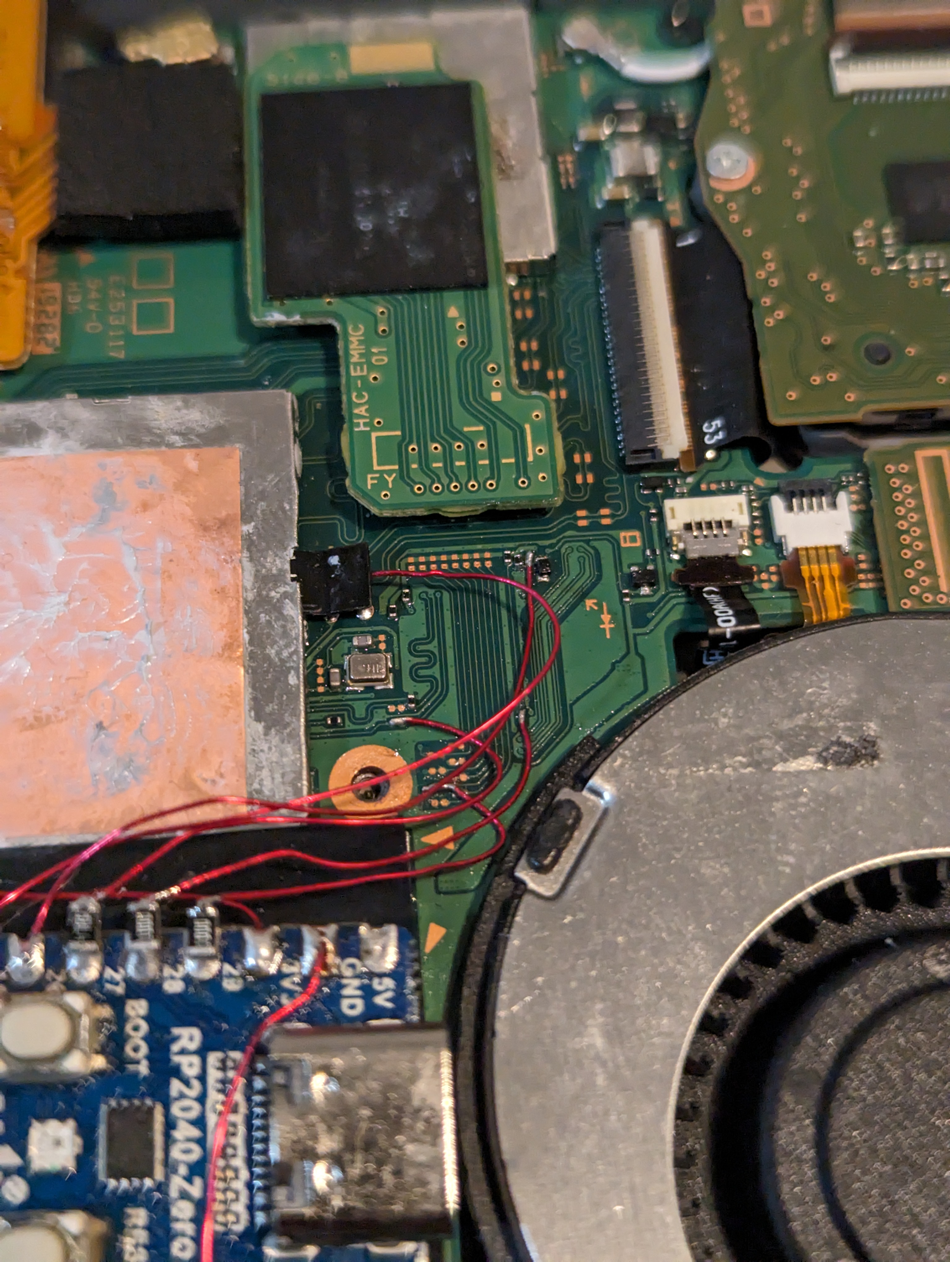

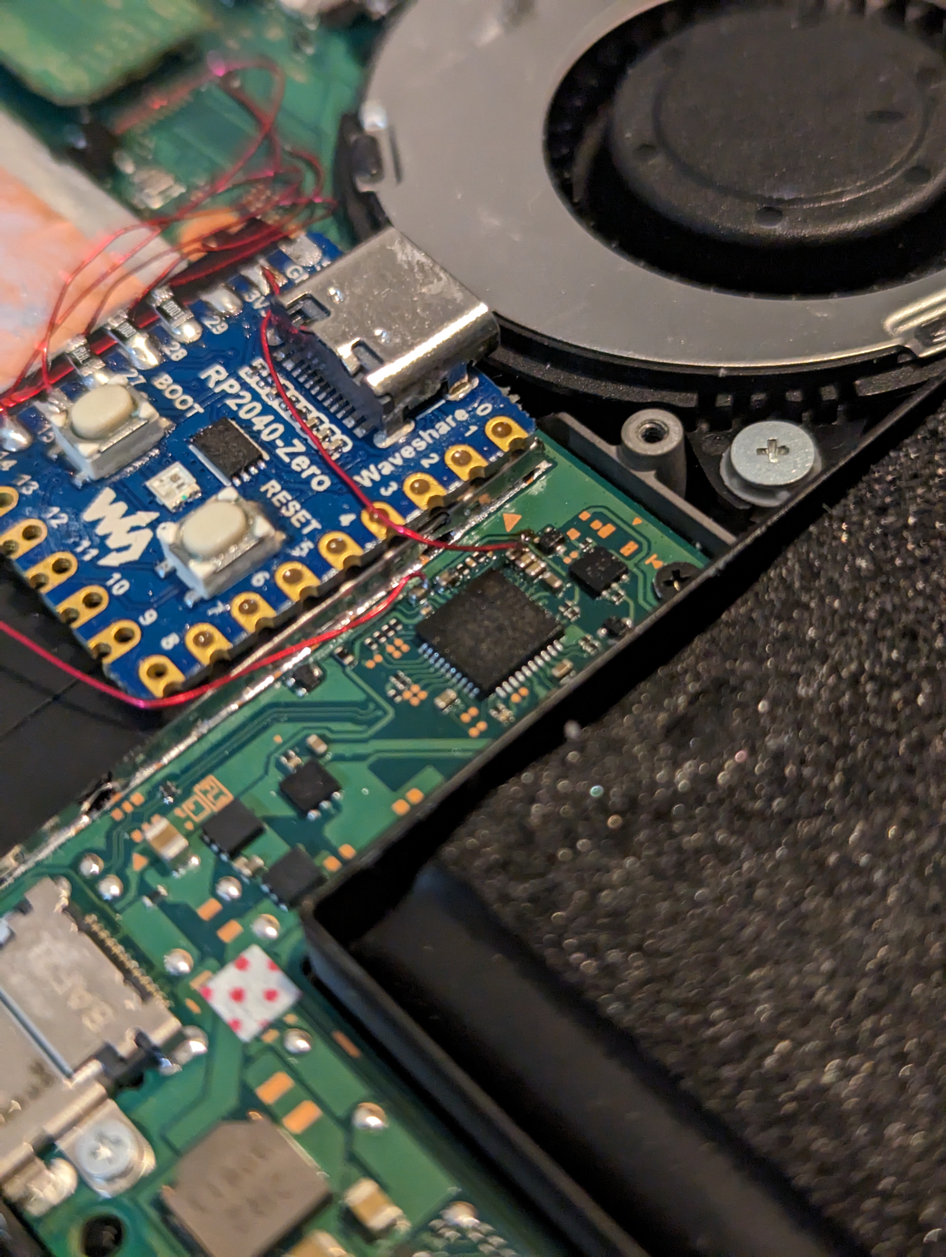

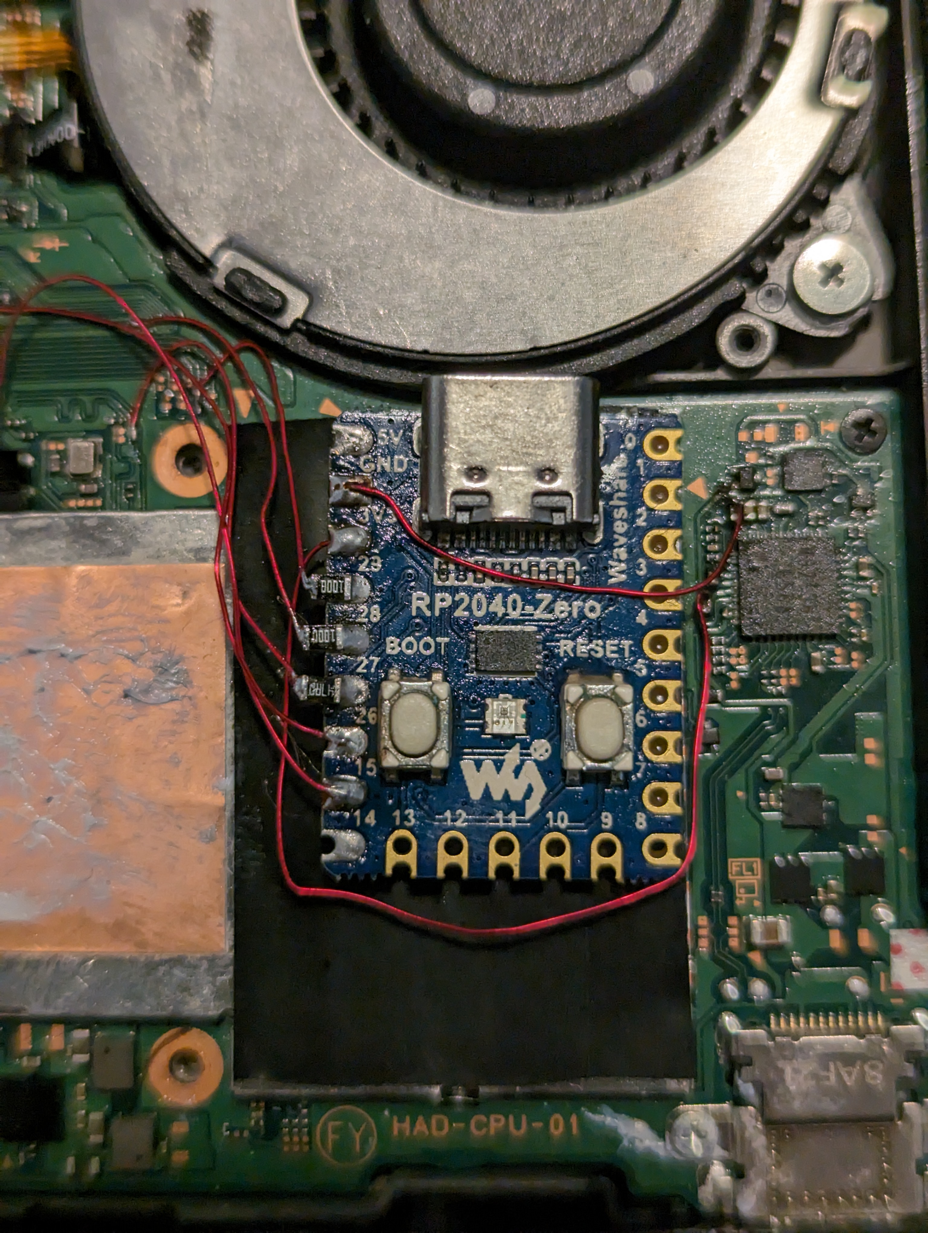

Hi.
I made a Picofly installation today on a V1 patched. I've made 4 or 5 picofly installations before with no problems. I always use the proper flex cable for cpu points, enamel wire for board pads, and a plastic insulated thin awg wire for VCC and GND.
But after installing this one, the console didn't power on, and the chip didn't show any light. The CPU was warm, so something was wrong. I checked everything and realized the GND wire broke just at the GND point of the chip so it wasn't making contact.
After resoldering it and check everything again, I tried to power on and the chip glitched ok and loaded hekate. The problem is that after loading fusee payload for atmosphere (with all files copied to sd), I get the Atmosphere screen, then the "triangle" atmosphere logo, but then, black screen and after some seconds, an orange screen.
If I boot up with both VOL buttons pressed to load OFW and skip the chip, I get the Nintendo logo, but then black screen, and after some time, orange screen.
I saw it may be due to the wifi chip under the Nand board, but I didn't touched that or solder near that chip. Also, Hekate loads, and the info screen shows the MAC Address, so I think that wifi chip must be ok.
I checked every point with a multimeter and everything looks fine with no bridges. I also checked the board with a the big magnifying glass I use for installations, and I can't see any bridges or damage to any trace.
What can be the problem of the menu not loading and displaying an orange screen? I can only think that powering on the switch with that GND point disconnected due to the cable break caused some damage, but I don't know if that can kill a board.
Any help? Thanks a lot!!
Hi.
I had precisely this problem a few weeks ago. Same version console, same version of events exactly as you described.
https://repair.wiki/w/Nintendo_Switch_Orange_Screen_On_Bootup
I took the WiFi chip off with hot air, reballed it a reinstalled it (I've added pictures in one of my previous posts a few pages back in this thread).
In hindsight I could've just saved myself a huge amount of time and just reflowed it with hot air and plenty of flux but in any case it worked and hasn't been an issue since.
However, I also found it odd that it came up with this error right after I modded it but since you're here a few weeks later with an identical issue then perhaps there's a cause.
