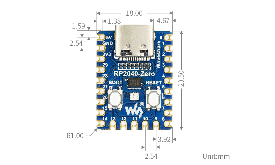

Hi guys! Was getting rid of usb port and buttons on rp2040, did i blew off some resistor/whatever that is? Circled in red, second element on elements row just under the usb port pins. Is it ok, or do i need a new board now?
Hi guys! Was getting rid of usb port and buttons on rp2040, did i blew off some resistor/whatewer that is? Circled in red, second element on elements row just under the usb port pins. Is it ok, or do i need a new board now?
your fine there is nothing on that spot ;-)
Reactions: Corwin13
