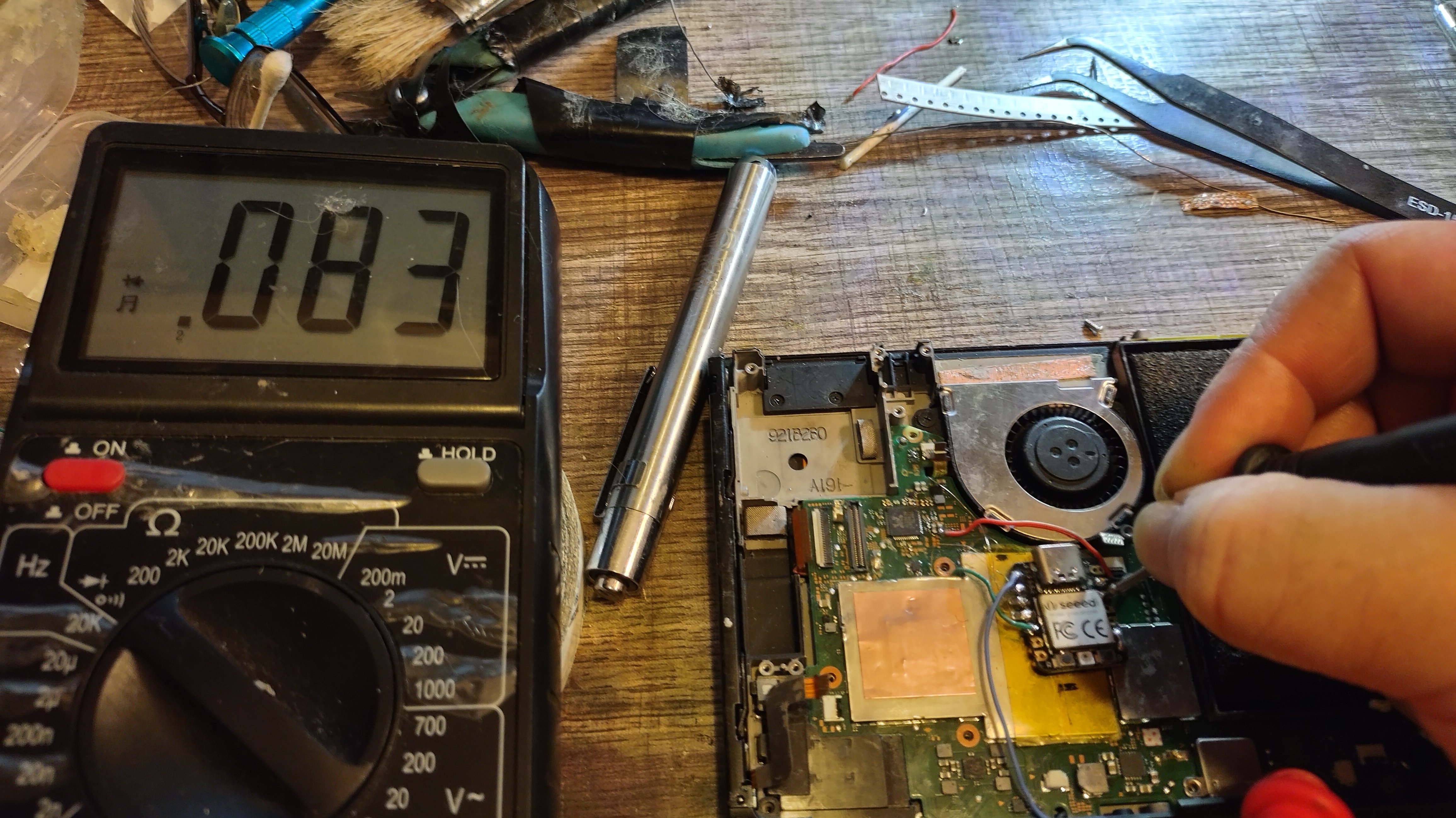

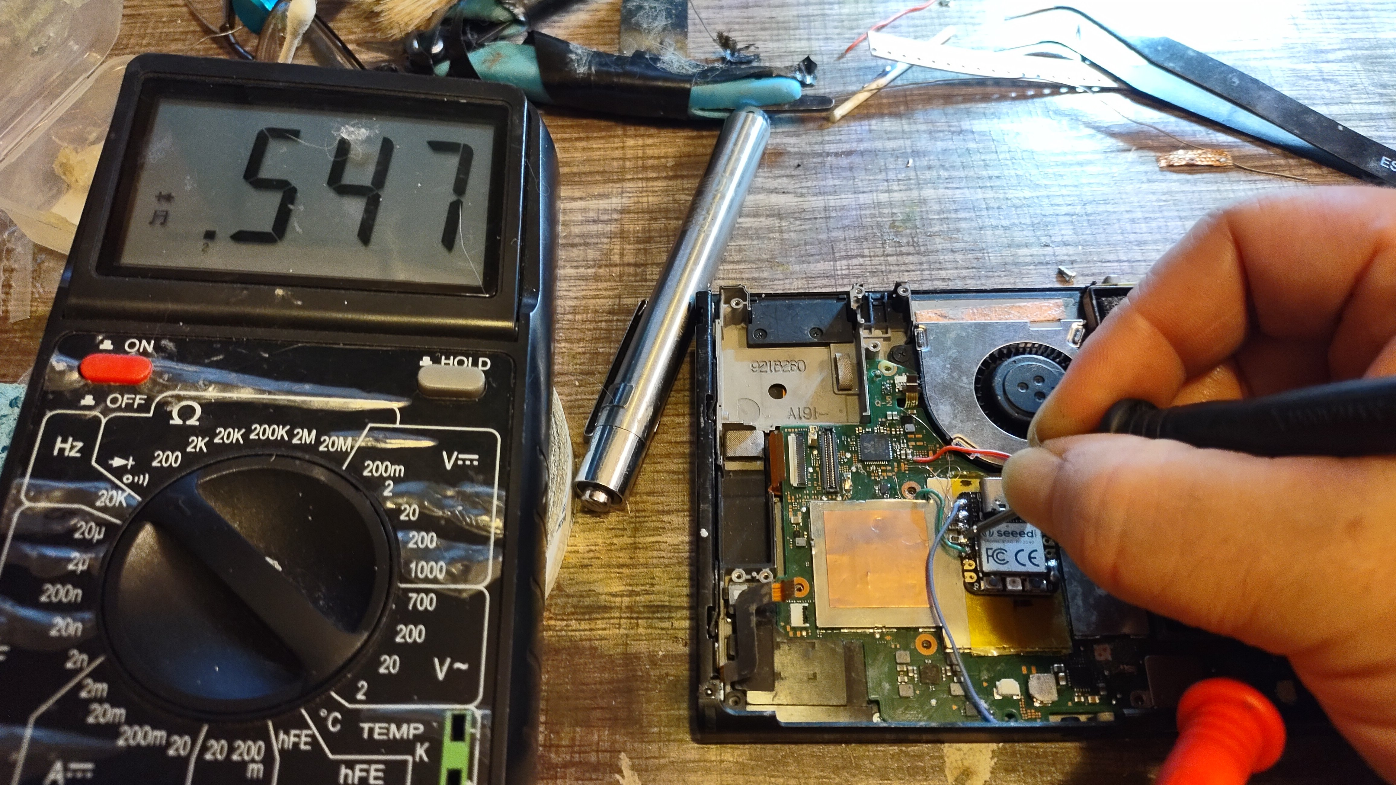

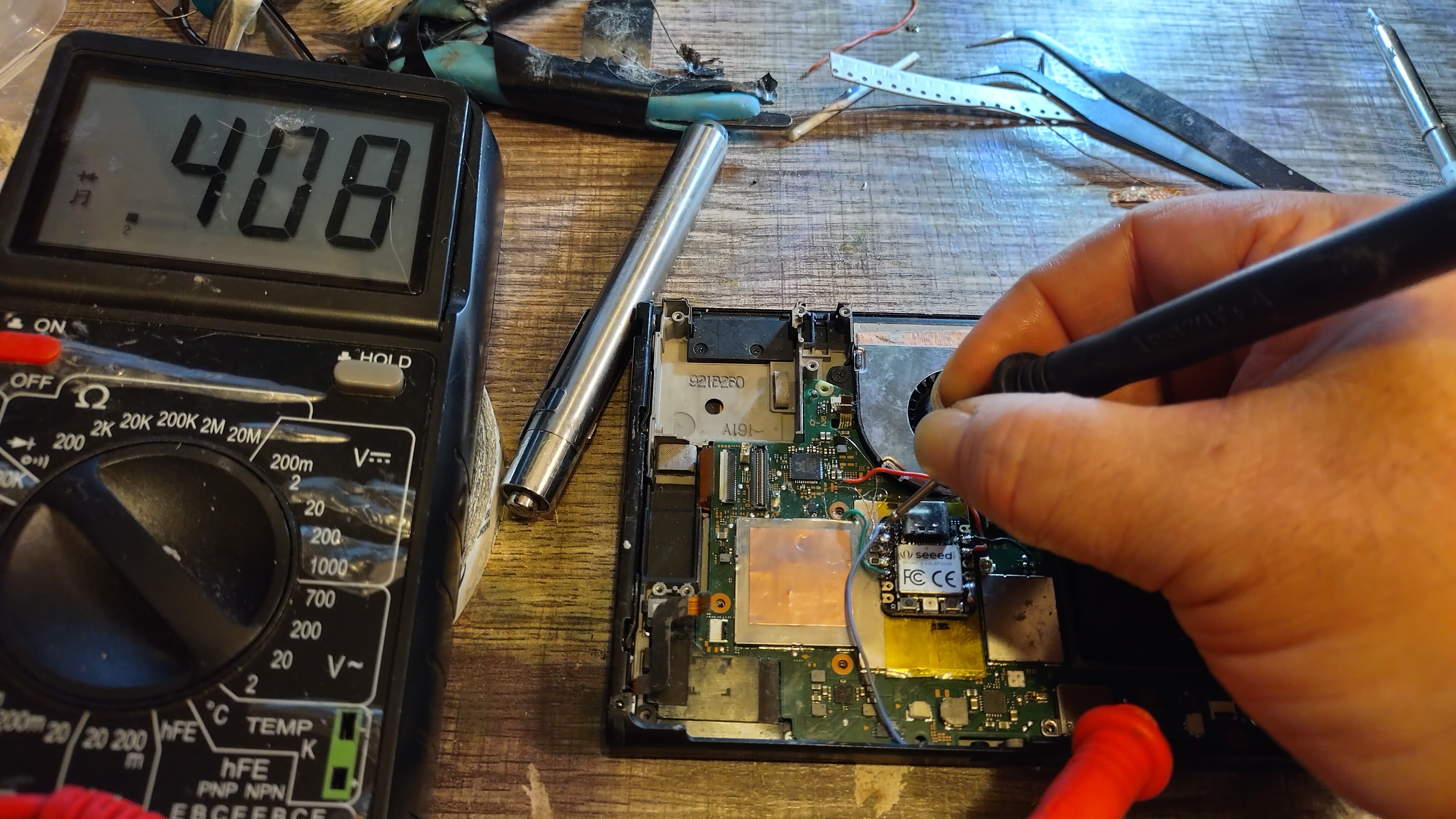

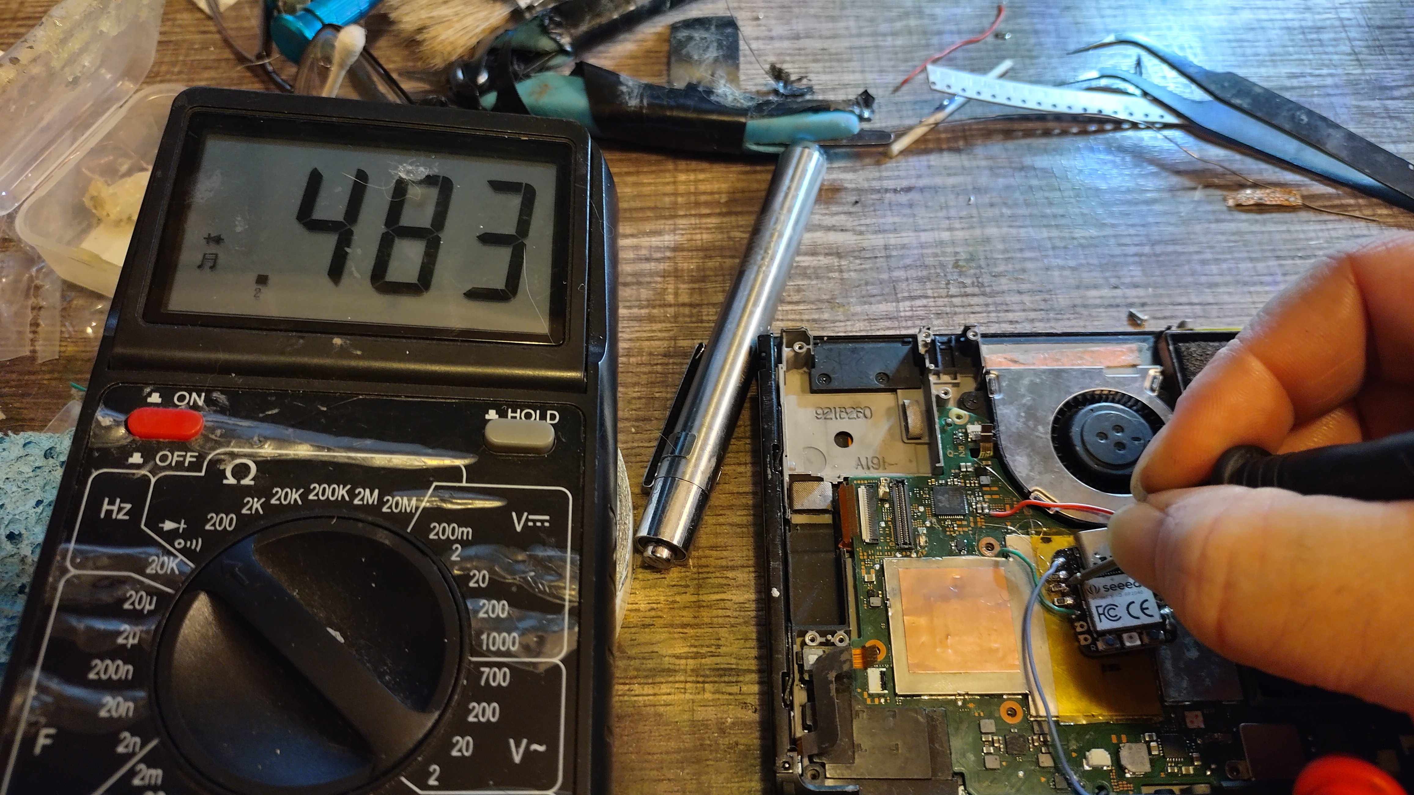

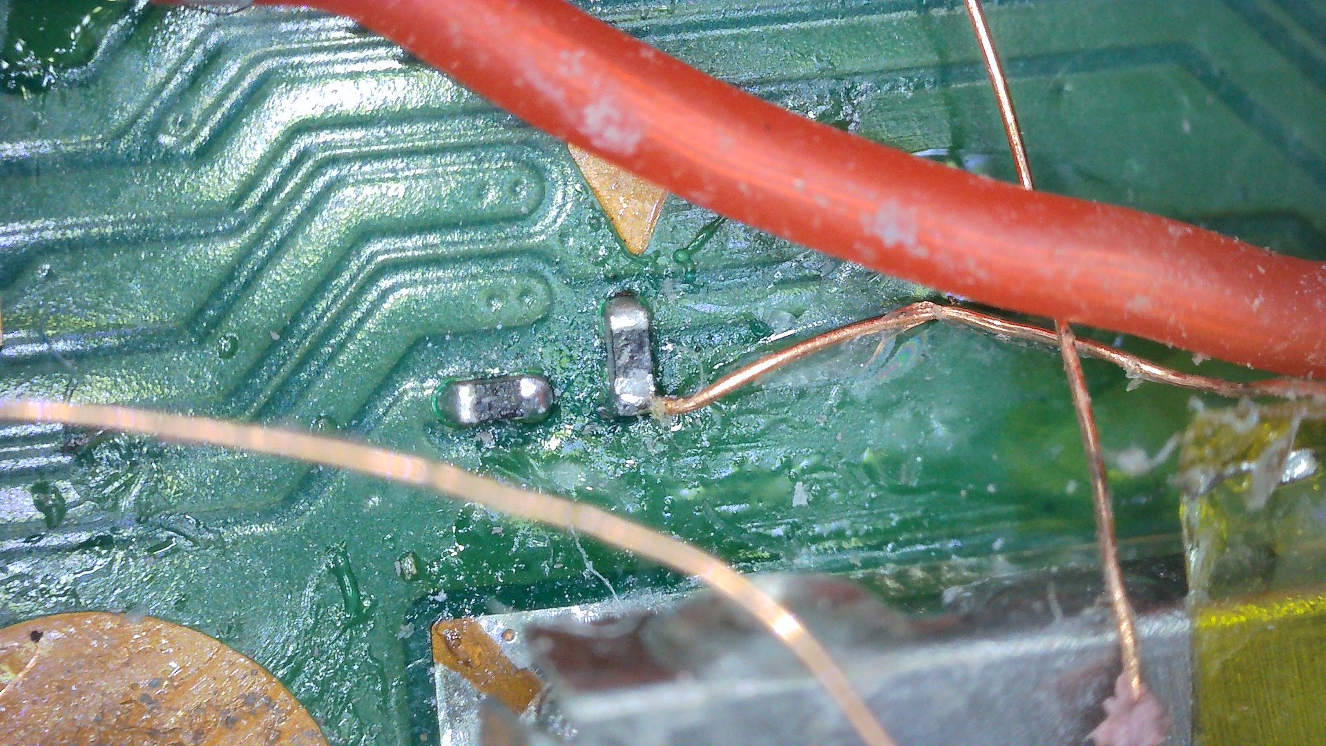

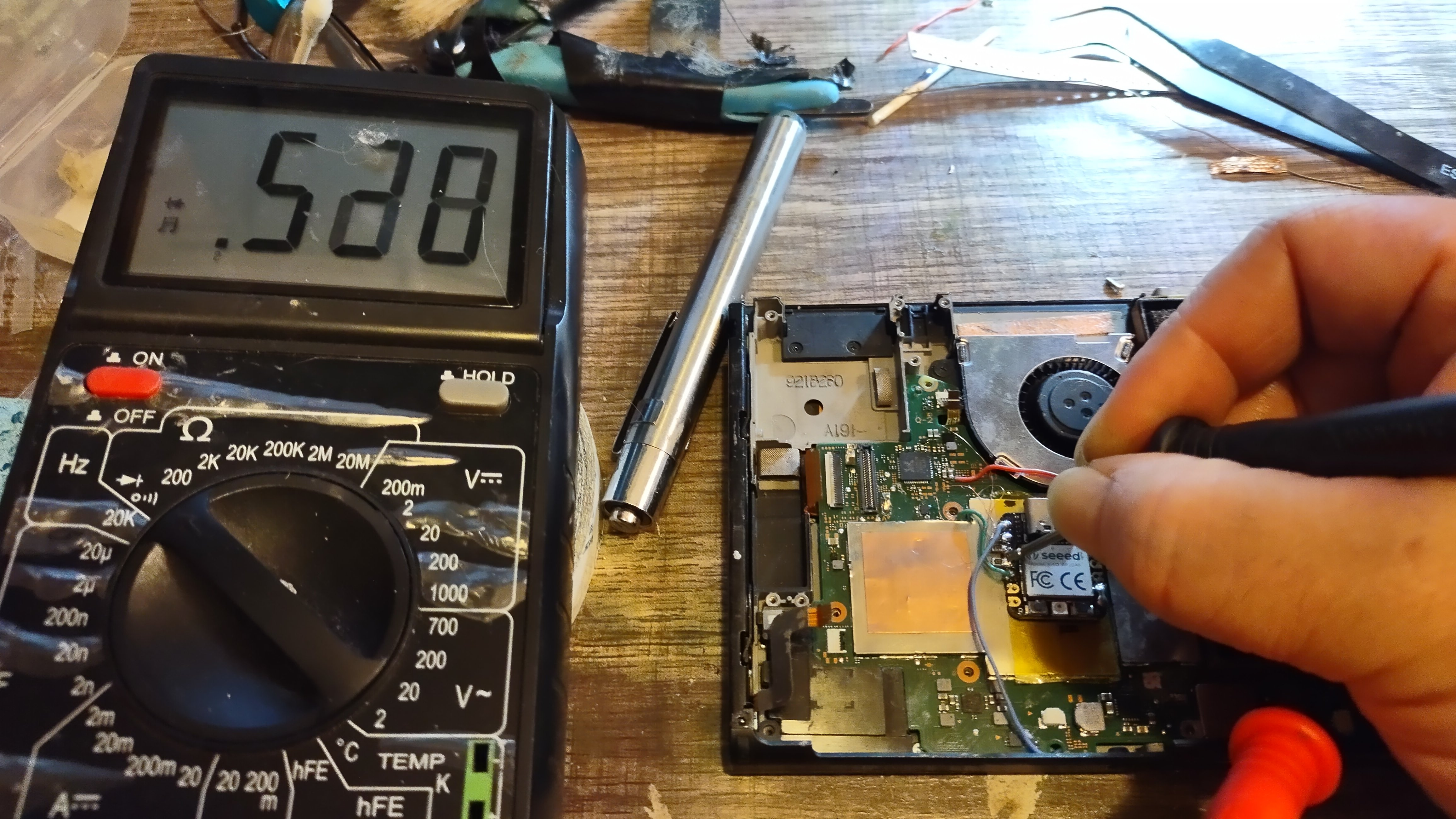

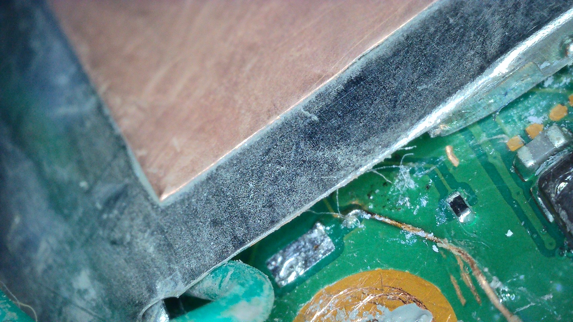

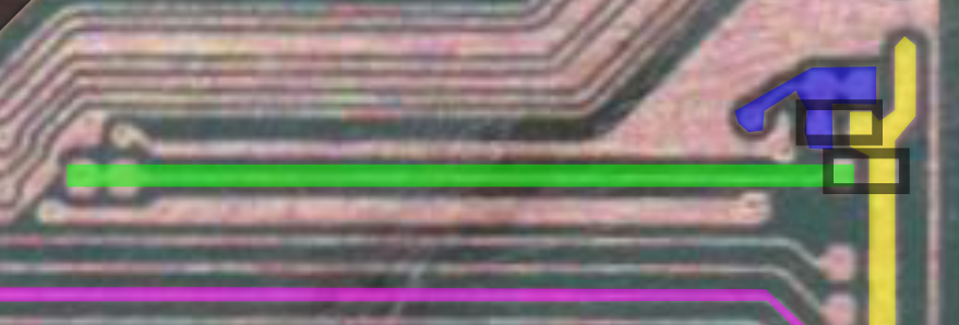

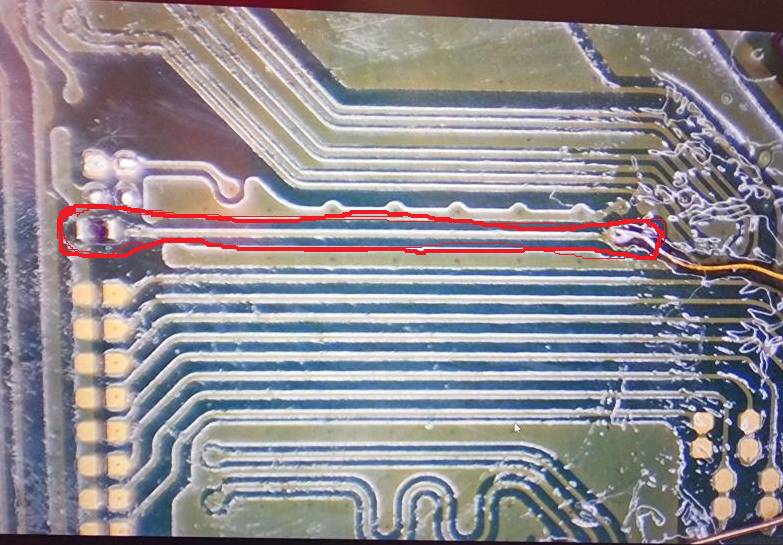

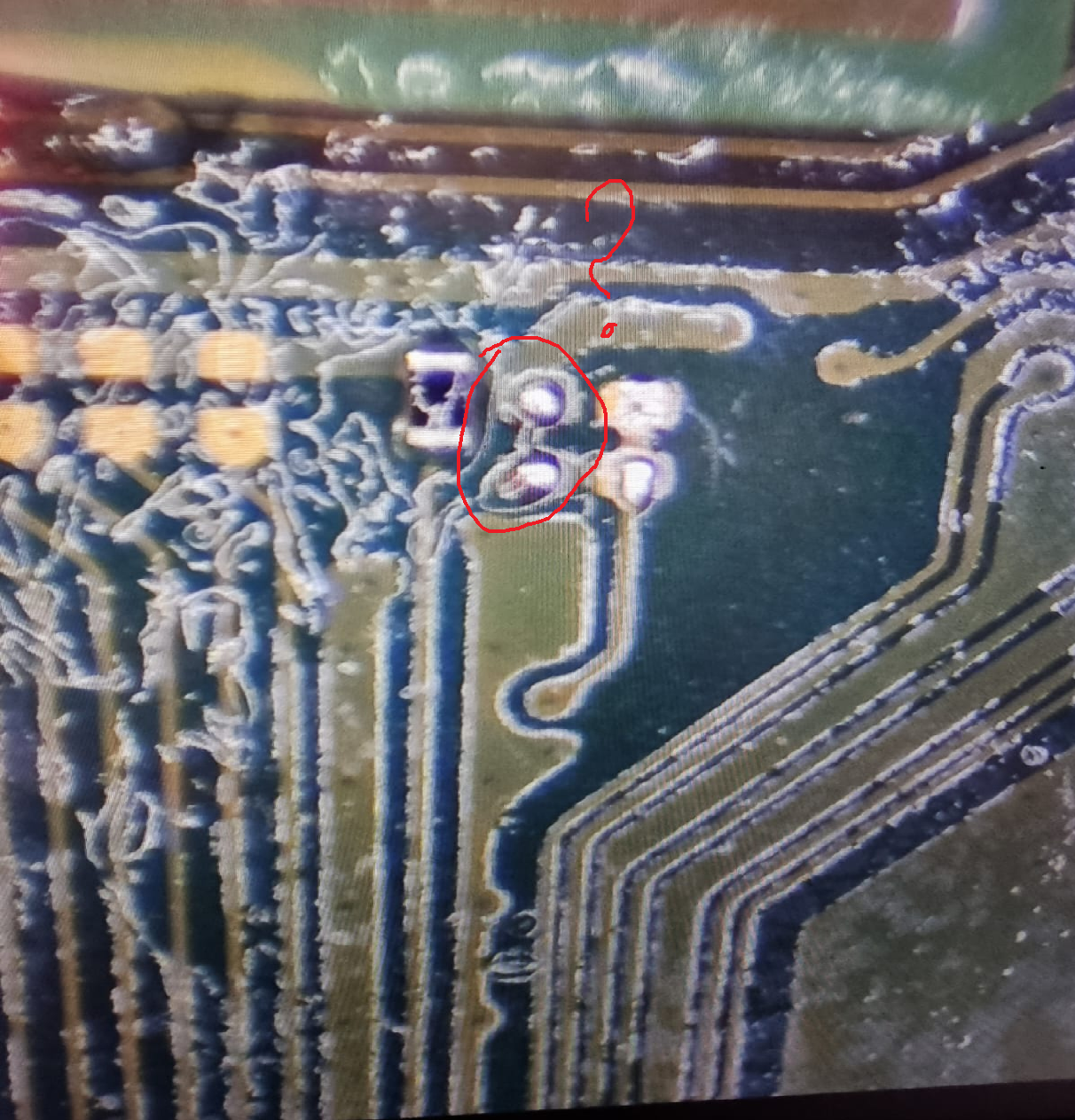

Um . Did an oopsie? I have no ideea if by mistake i took out that resistor or it never was there. I searched for it everywhere and it seems like it went into 9th realm or something. Its nowhere to be found.
i know something is different on the rst point on v1/v2 on some of them. BUT i really dont remember if this one had the resistor .
This console is a V2. Excuse the quality and flux but i just cleared it a little just to not shine too much.
So i did a little bit of looking around it it looks like this resistor is for a test point. In theory i should be able to snatch this one, move it below the RST point, and use the CMD on the NAND point righhhhht????... I dont have a donor board and i dont have these resistors in my possesion.
Update on this part: Found out that this is a REALLY bad ideea.These are pullup resistors between 1v and cmd/rst. (Special thanks to @abal1000x for educating me)

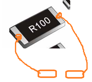

Also from what he told me, you could also put a 4.9k ohm resistor. I have not tryed that yet and im scared? Im still leaning on putting a 4.7k . If however you find yourself in this situation, and have a spare picofly, you can steal a 4.9k(or 5k im not sure,my multimeter is not great. It also reads the 4.7k to 4.6k) from near usb C (i think they are the same size aka 0201)
I found the 4.7k resistor and i struggled to solder it back on. Ended up ripping the pads FROM underneath THE RESISTOR (not the board) so now i cant connect it properly from underneath the resistors. I think i will have to connect it from the sides with jumper wires........... so that s that.............. What i tought about doing from the first place was to use hot air and just let surface tension do its job but then i looked at that plastic emmc connector near it and i went "nope".
Ill do this tomorrow since now im on 24h of no sleep >.>

Got a wierd V2. So i lost the 4.7k resistor near RST. Replaced it with a 5k resistor as adviced (that s what i had on my hands).
Went ahead and completed the job. Then it worked.After a couple of boots, i get ** check RST. After some digging out, i think i found the problem. CLK wire (enammeled wire) got really hot while soldering and lost its insulation, and was shorting the RST on picofly? Went ahead, fixed the job, put solder mask on it to keep it nice.
Also did i2c low voltage on it since it had terrible boot times. Now its fast. (but i dont know if the low voltage technique fixed the boot times, or the fact that i fixed the CLK possibly shorting the RST)
All good , did a lot of power ons. Went ahead and proceeded with securing everything into solder mask. And when i tought that everything was nice and fixed, i got ** RST again X_X one time. But now i cant get it to do the error again. WHAT THE FFFFFFF
Edit. After partial reassemble, it get ** rst perma :)
Update 2: it turns out i did a pretty shitty job of resoldering the resistor. i did not have any low melt solder or paste. It was somehow not properly connected on 1 pad ,however making contact. I resoldered that point and it seemes it went away for god? We ll see.
