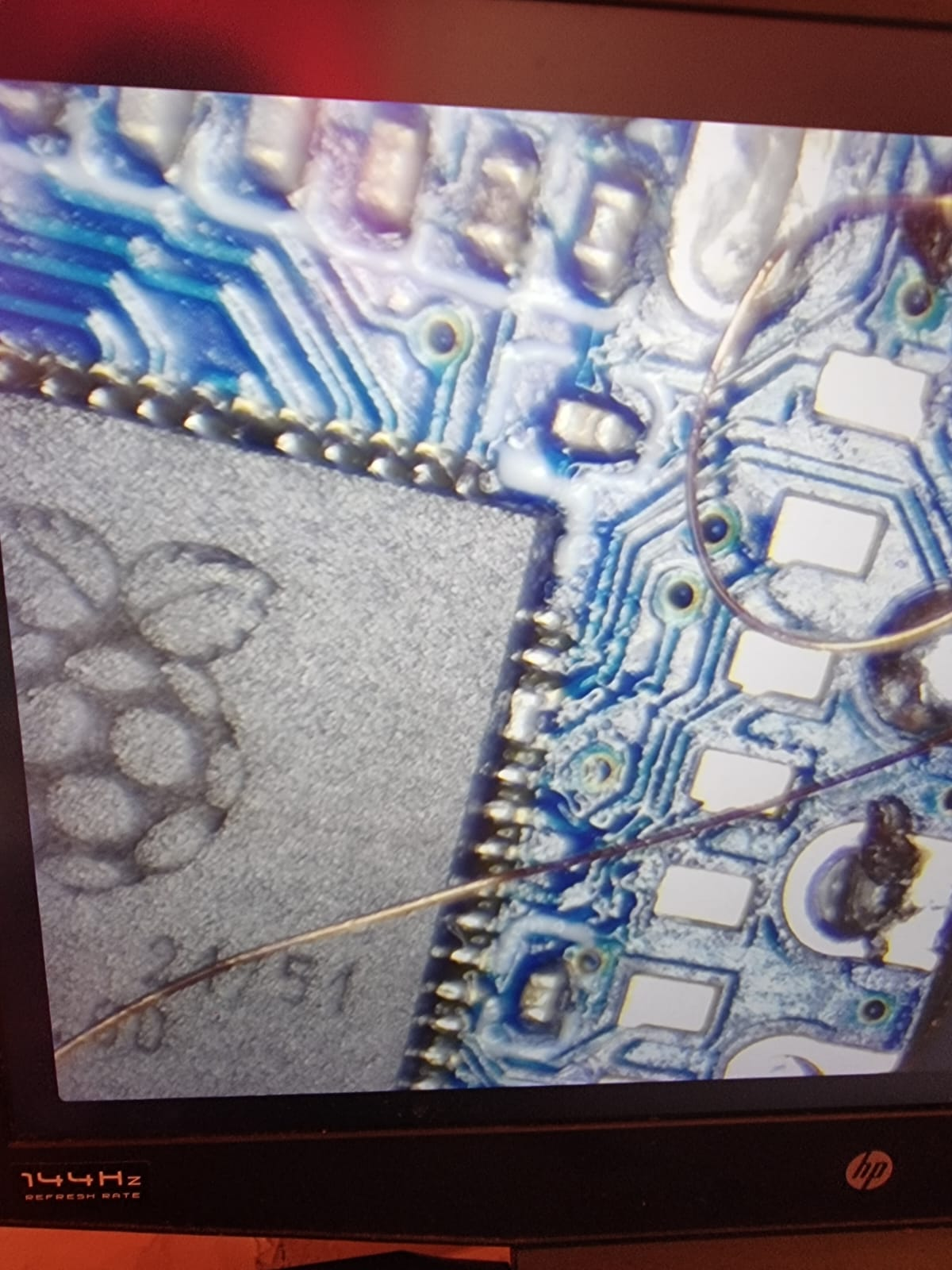

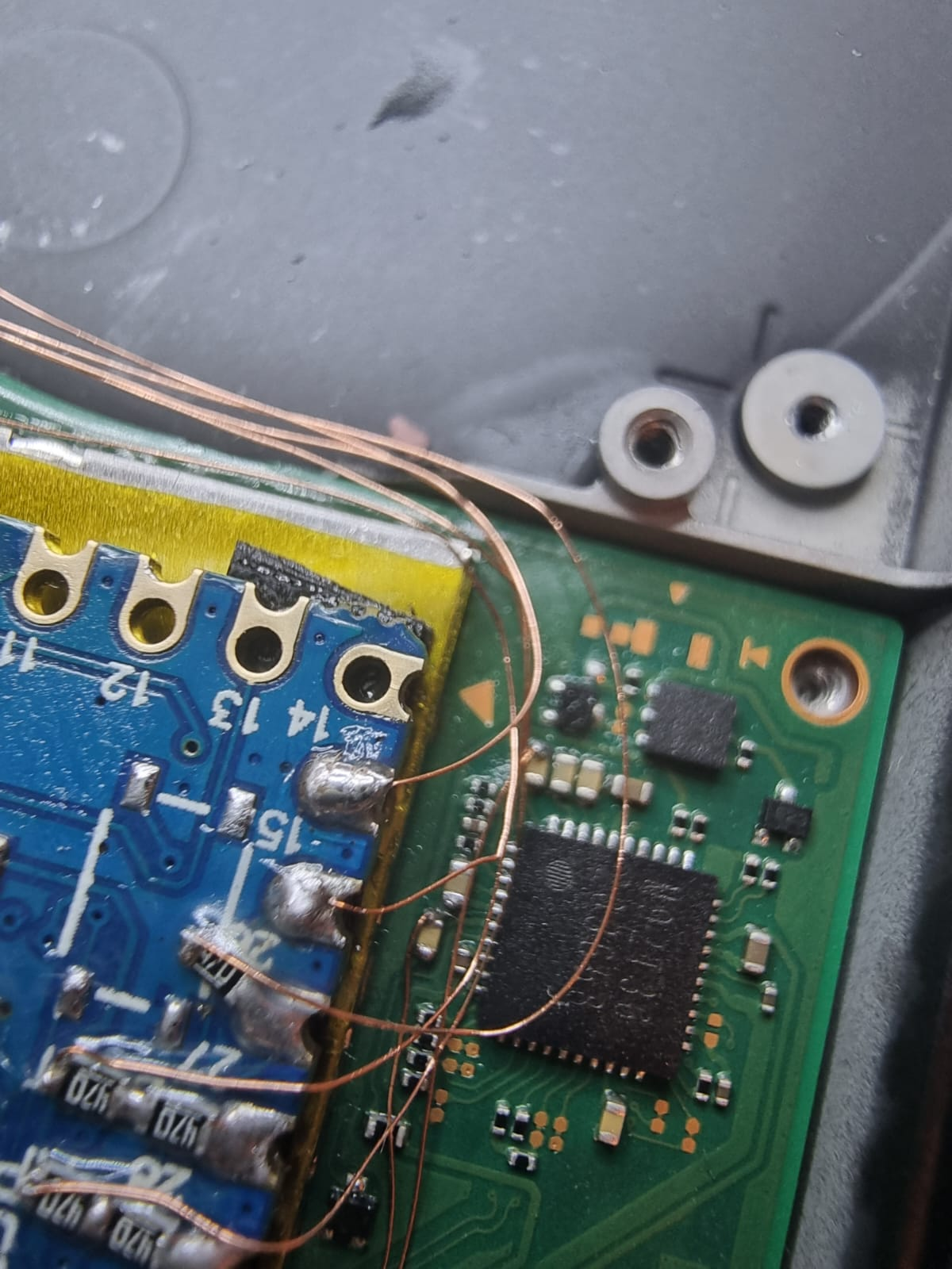

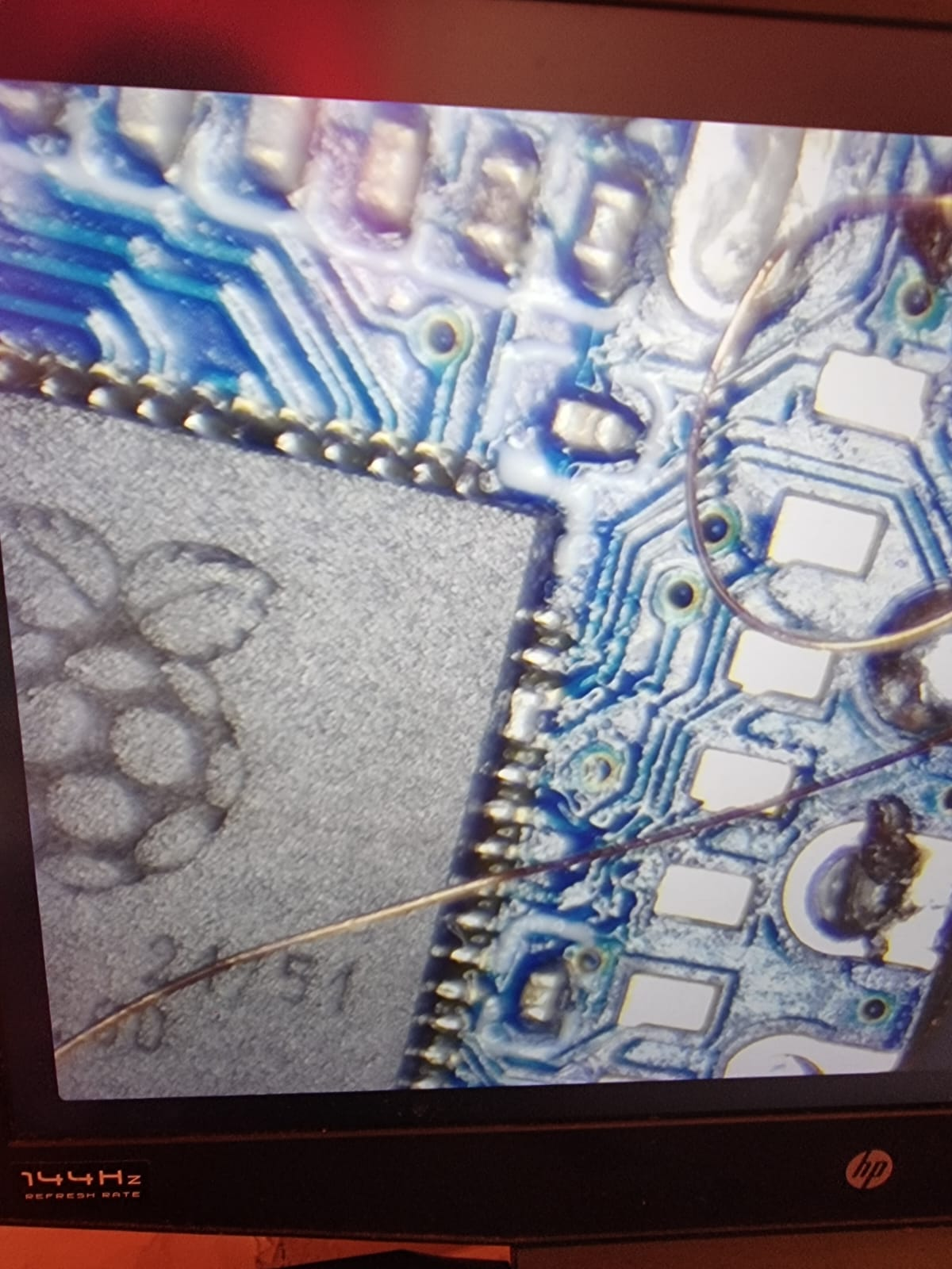

Do you guys see anything unusual with this install? I get error ==* CPU always reach BCT check (no glitch reaction, checkmosfet) , and a black screen (the backlight lights up for 1 second). Also i have checked for loose connections. I get continuity from pico to mosfet, and continuity from caps to mosfet
HM. wierd thing is i ve done it before ,same setup and it was ok,it worked. I use these wires for everything.
Do you refer to the mosfet to cap wires, or mosfet to picofly wires? Or all of them?
They are 0.1mm wires. What size do you suggest?
Stupid question,i dont have another wires right now,will it work if i put 2x0.1 mm wires like in picture? To imitate i bigger wire?
Also i had a mosfet i was using before so i did some continuity tests? Dont know if they are worth anything. They seem to be identical on the layout. When i test source and drain in continuity, on old (known good) mosfet i get 447, and on new i get 577. I dont know if this means anything. I am very stupid about this subject
Stupid question,i dont have another wires right now,will it work if i put 2x0.1 mm wires like in picture? To imitate i bigger wire? View attachment 394996

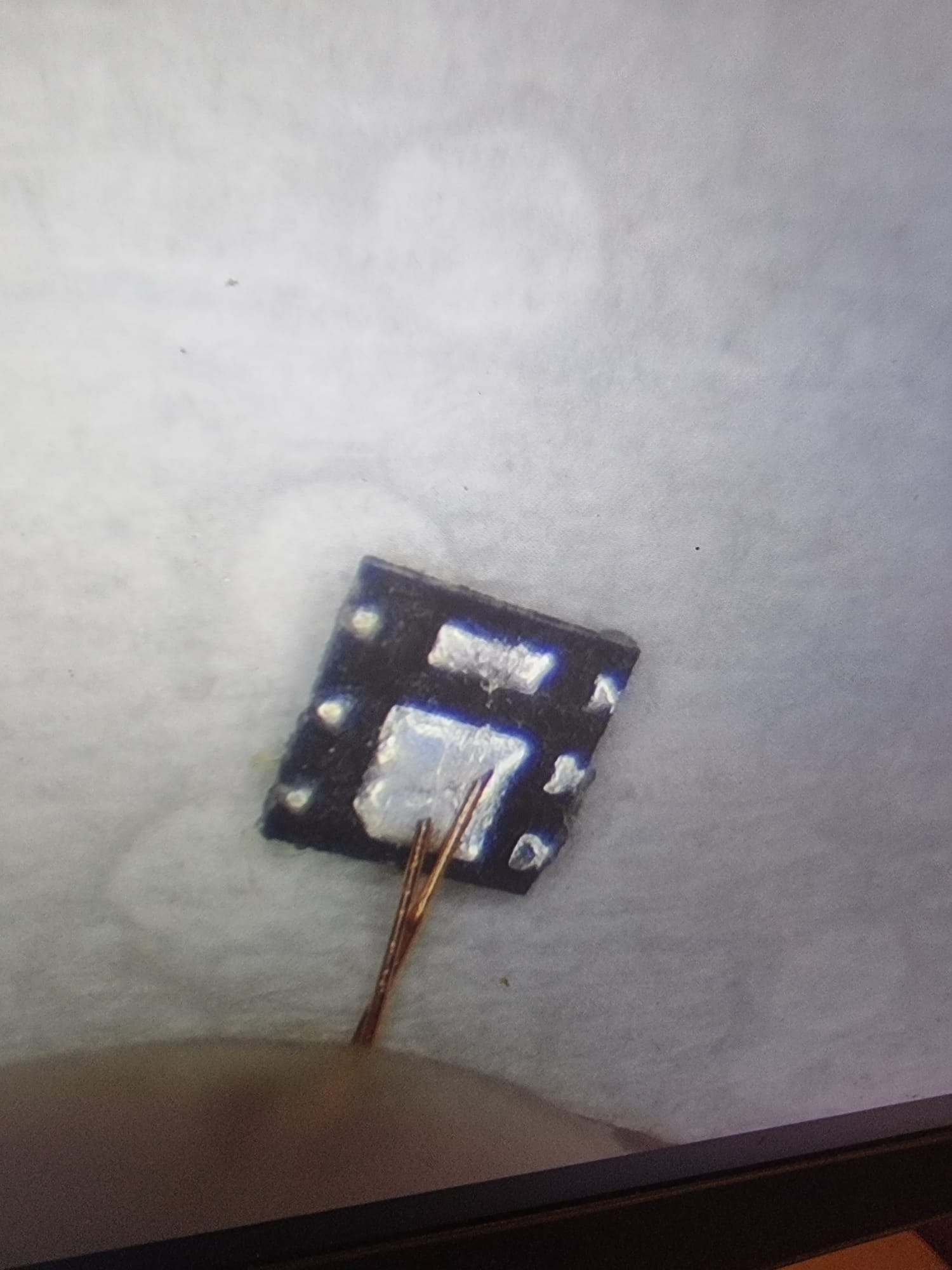

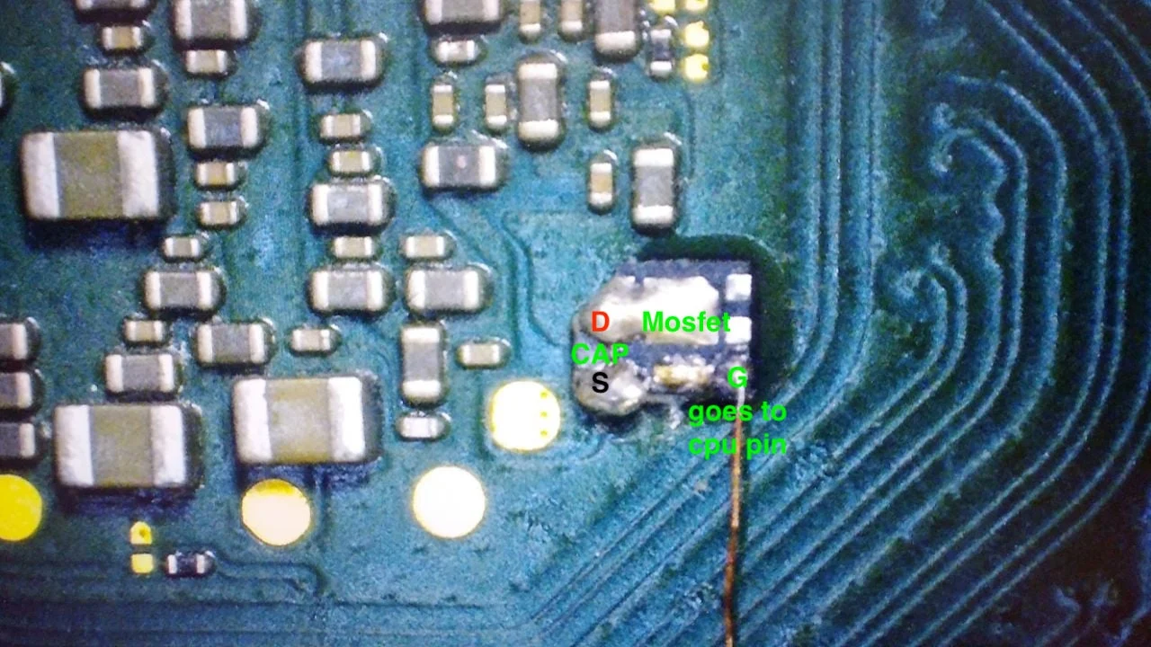

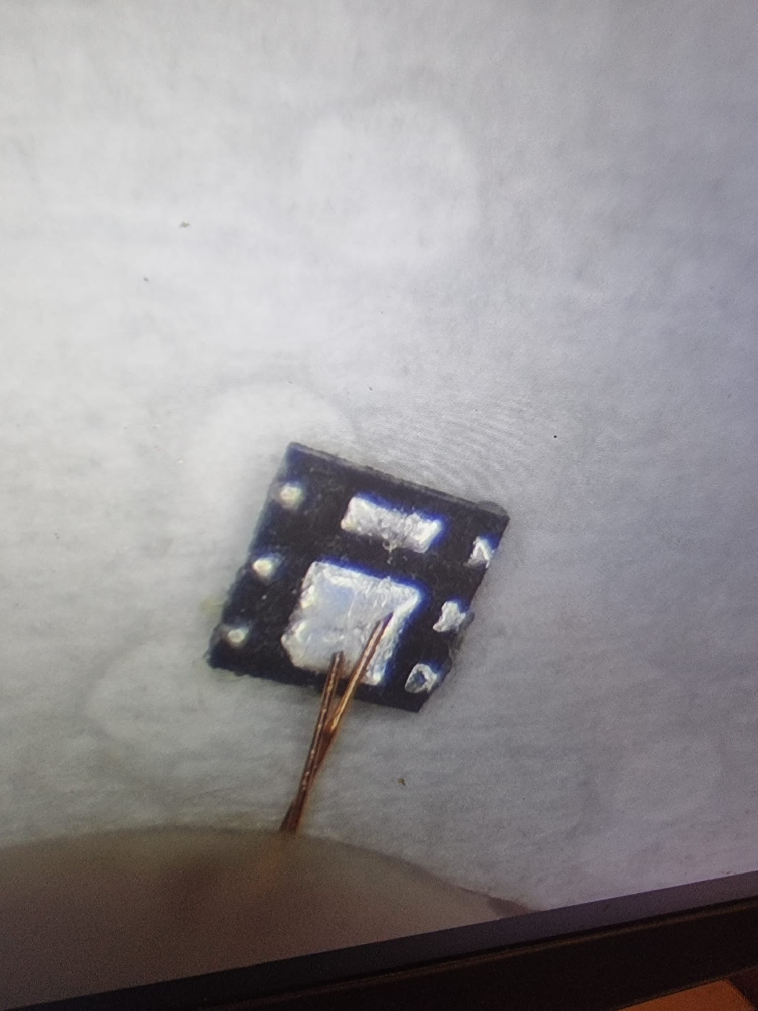

Well i ve just been trying to solder this god damn mosfet for the past 3 hours. Tryed the version where you just brute solder the mosfet to the cap,that did not work because solder just tends to get together in balls if you use flux, and if you dont use flux good luck soldering anything. They probably used a wire as core for that path of solder. Tryed that but failed bcs god knows why i either dont use good flux, good solder, or the right temp for this. So that s that. Then i tryed grouping 2x 01 mm wires. Spent 1h trying to solder the source and drain, I even named the wires. Drain was lil Timmy, and source was lil Billy. They even have a story behind. Anyways, that obviously failed in the end (the soldering part) because why would it work .
Any suggestions to ease my suffering?
I found an old known good mosfet (before i bought this new shit that im getting errors with). It works PERFECTLY WITH THE OLD MOSFET. (the good ones were stolen from V2 flexes)
This is the new problematic mosfet.Garbage. I can only differentiate it by multimeter giving 570 value between source and drain, where the good one gives 470. It was advertised as with the same name that is recommended in the picofly document.
Why did it not work? Is the resistance too big and the current cant pass?

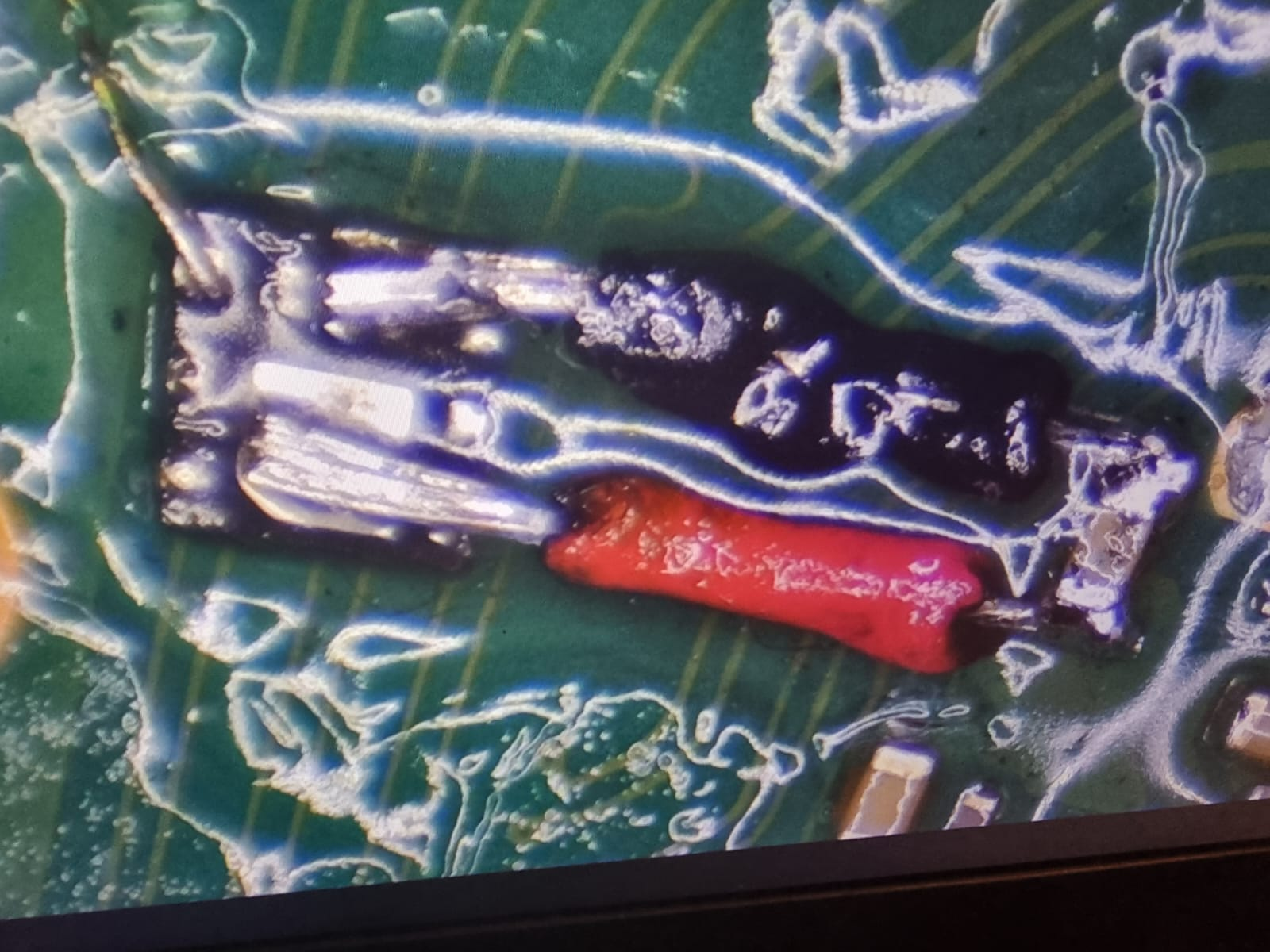

What do you guys think of these wires that i ended up using? Are they ok?
I tested and it works with the good mosfets
Why did it not work? Is the resistance too big and the current cant pass? View attachment 395055
I tested and it works with the good mosfets View attachment 395058

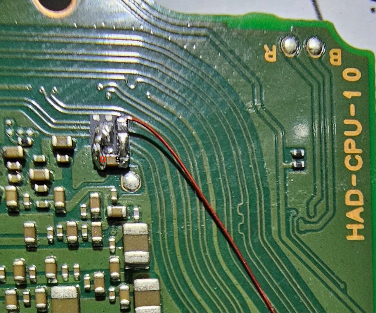

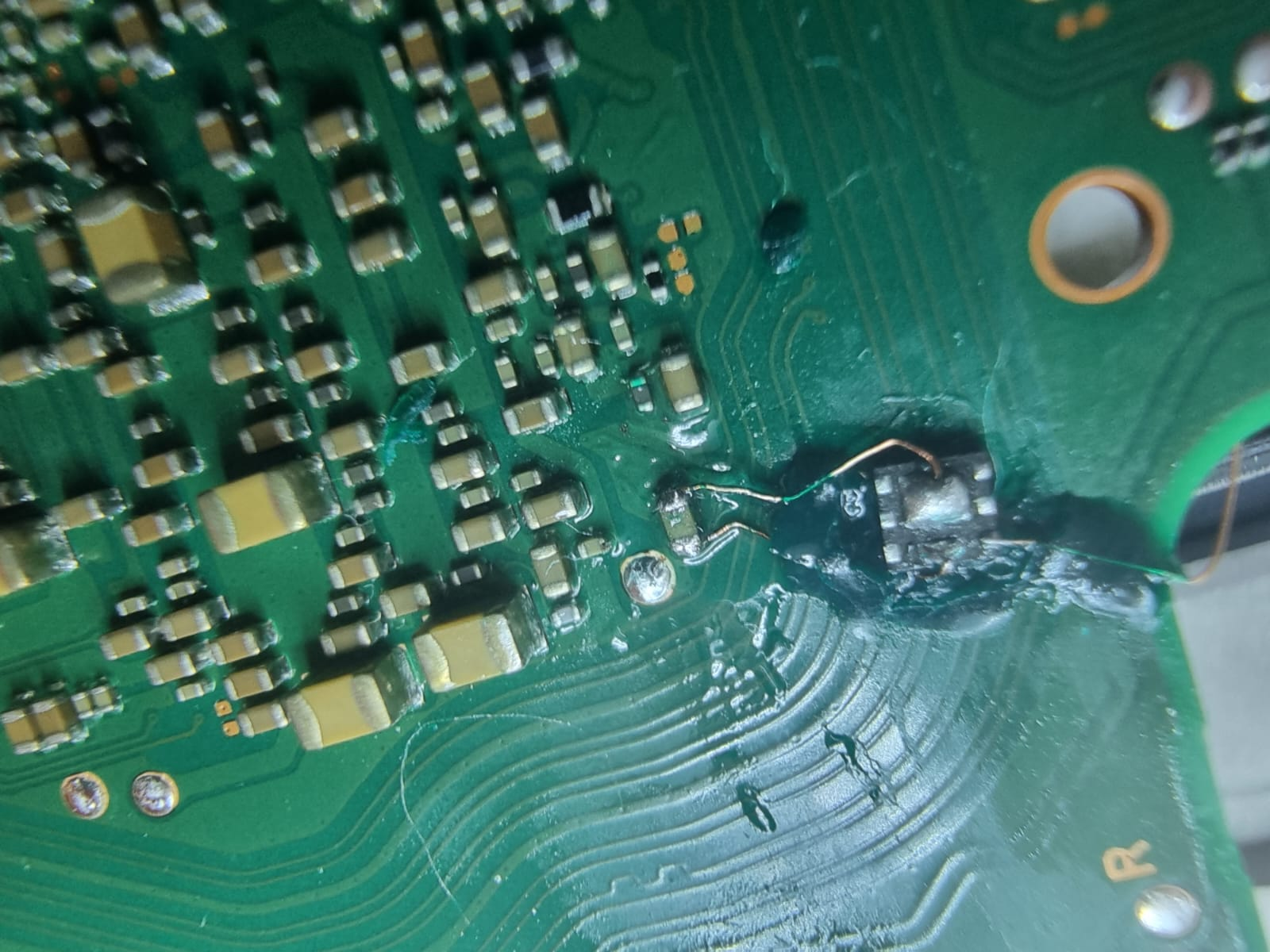

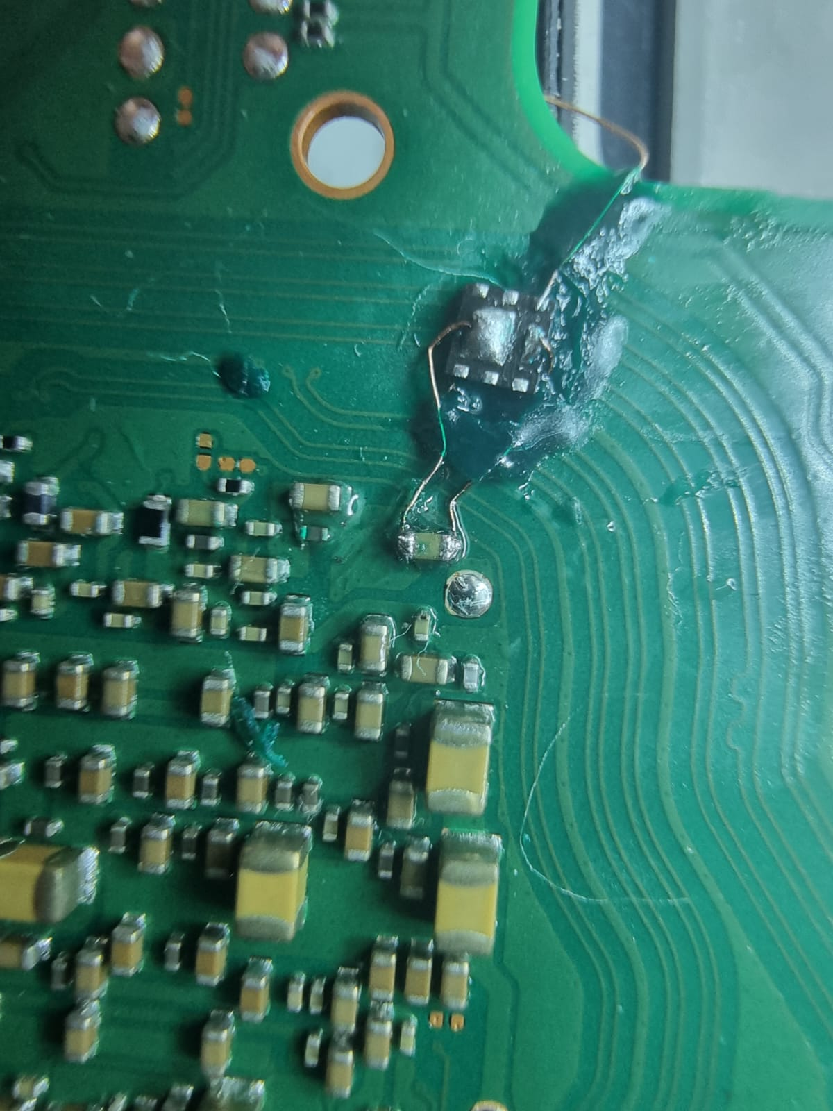

Another day,another problem. Hey guys its me,ya boy Crung, we re gonna be friends because aparently i f**k up all of my installs recently somehow.
So i have this V1 right? Flex on cpu, 0.1 enammeled ,all the good stuff.
*== No eMMC CMD1 request (poor wiring, or dead CPU)
I made sure i soldered the right picofly point to cmd.
Resoldered resistor on picofly, resoldered wire to resistor, resoldered cmd point, then i tryed the cmd point on emmc.+Tested with multimeter from picofly to cmd on board/emmc, from cmd on board/emmc to the end of the resisor = all values are normal,aka continuity and if tested from pico, i get the resistor value wich is normal.
The cpu flex had insulation on caps so no way it was shorting.
Wich got me sh*tt*ng my pants "wtf did i just somehow killed this cpu" ?
Took the chip out and all the wiring, console works as expected.
Like...This is so disgusting.. So turns out the picofly chip legs bridged (or maybe they were bridged from factory since i doubt that i applyed THAT much heat to the board) :| Can you guess what those legs are responsible for? You guessed it. Pin 28 and 27 aka CMD with clk. Brah.
I was really considering leaving the modding community since i was doubting myself about not beeing competent enough to do this stuff anymore. But i guess i still got it?
Sorry for spamming the forum with posts lately but i like to think that these posts will help future persons attempting to mod when they will be in same situation as me.
Took the chip out and all the wiring, console works as expected. View attachment 395097
I was really considering leaving the modding community since i was doubting myself about not beeing competent enough to do this stuff anymore. But i guess i still got it? View attachment 395124View attachment 395125

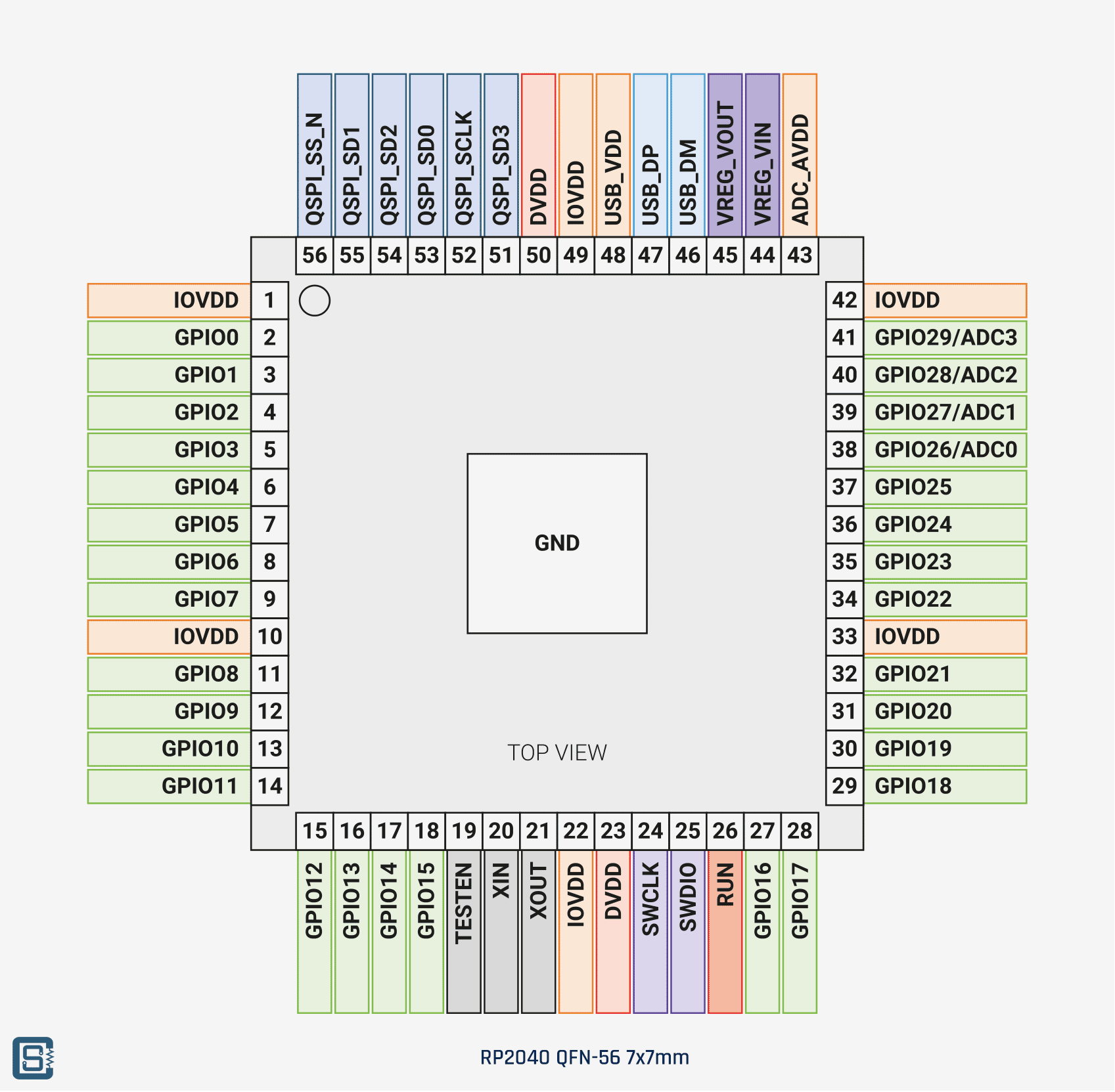

when I assemble the rp2040-zero at PicoFly I perform a visual inspection before and after desoldering the ports and other components. and I found some factory surprises.
