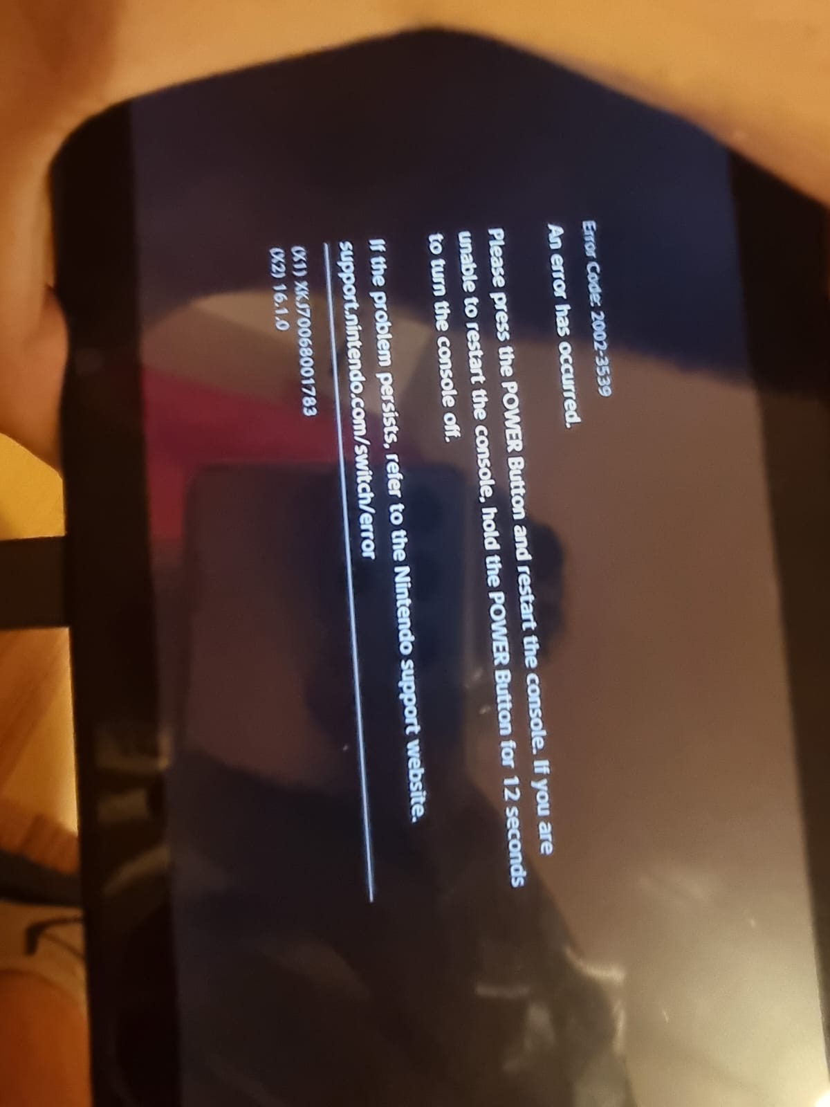

Second time i got error
Turned it off, tryed again. Third time it gave me this error
Turned it off, tryed again. Fourth time, i dont even get a Nintendo Switch logo anymore. It just goes to a black screen.

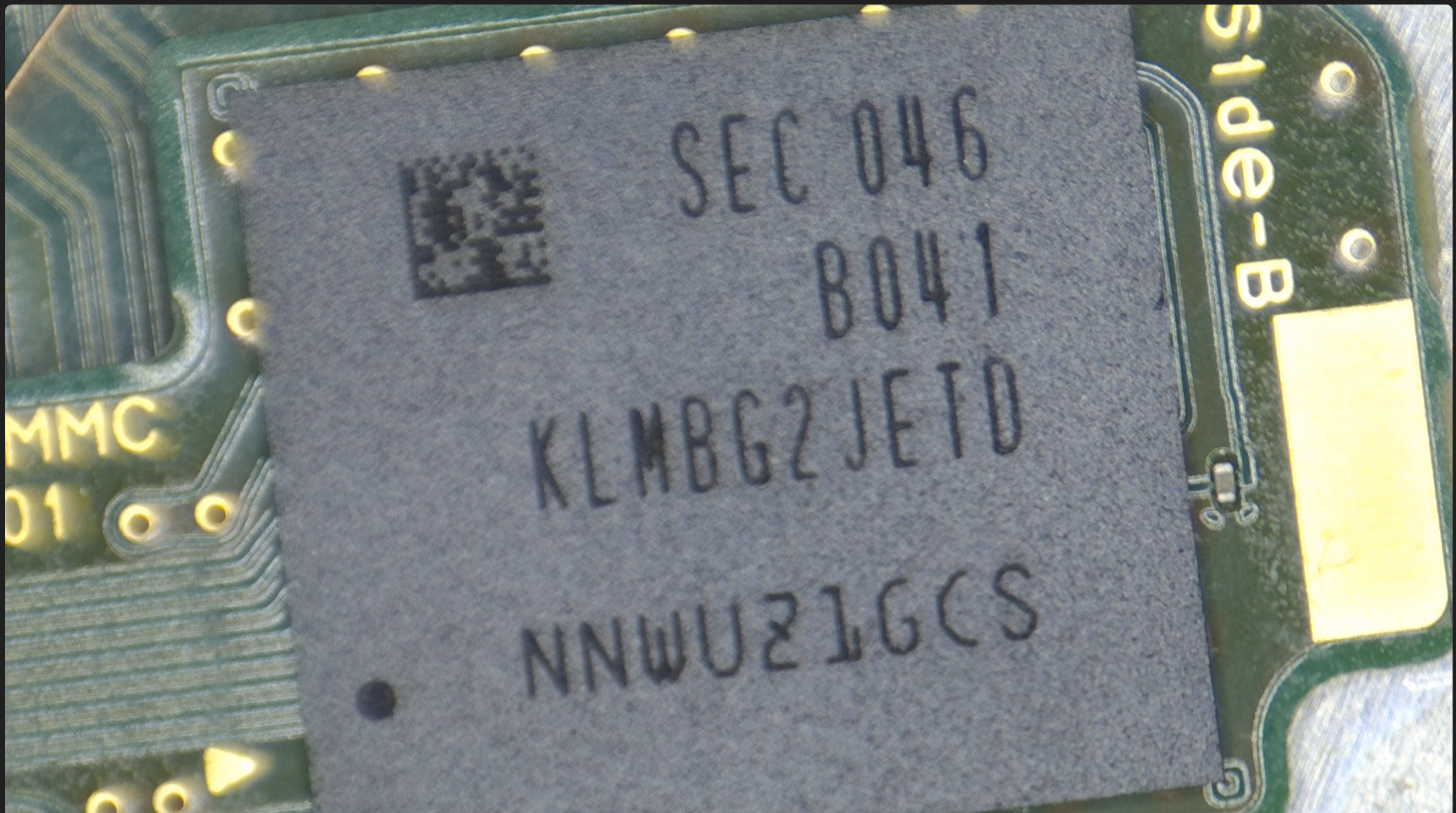

Also sometimes the errors i was getting on picofly always *=* No eMMC block 0 read (eMMC init failure?).
From what i can assume with my little knowledge and skimming some posts , its either dat0 OR THE MORE LIKELY scenario, the EMMC is corrupted? Now i assume that rebuilding the emmc is not going to be a problem but at the same time id like to check back with you guys if PERHAPS the cause for this is phisical.
Do keep in mind, all this time i am able to boot heckate no problems, and CFW (but as mentioned, sometimes CFW freezes).
I have checked RST,CMD,CLK,DAT0 with multimeter. All normal values ( 94 ohm from Dat0 to Dat0). And they also have solid connection on nintendo motherboard. Also checked to see if CMD,CLK,Dat0 are shorting between themselves. It doesnt look like it (840-850 ohm resistance between for example Dat0 from picofly before resistors, and CMD on motherboard).
I also checked the caps on the emmc . They dont seem to be shorted to ground.

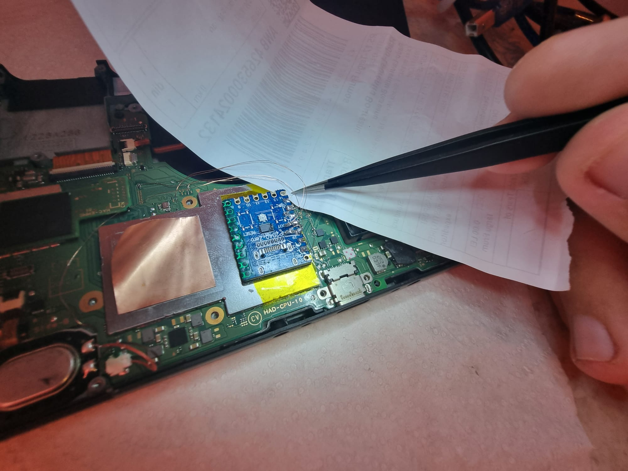

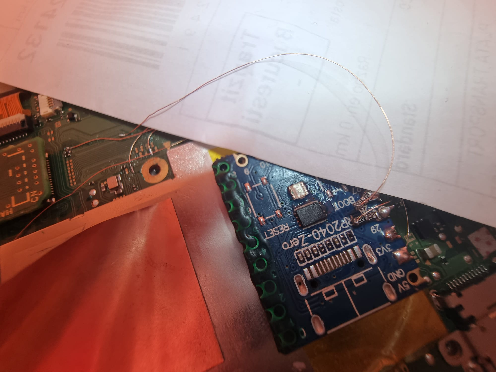

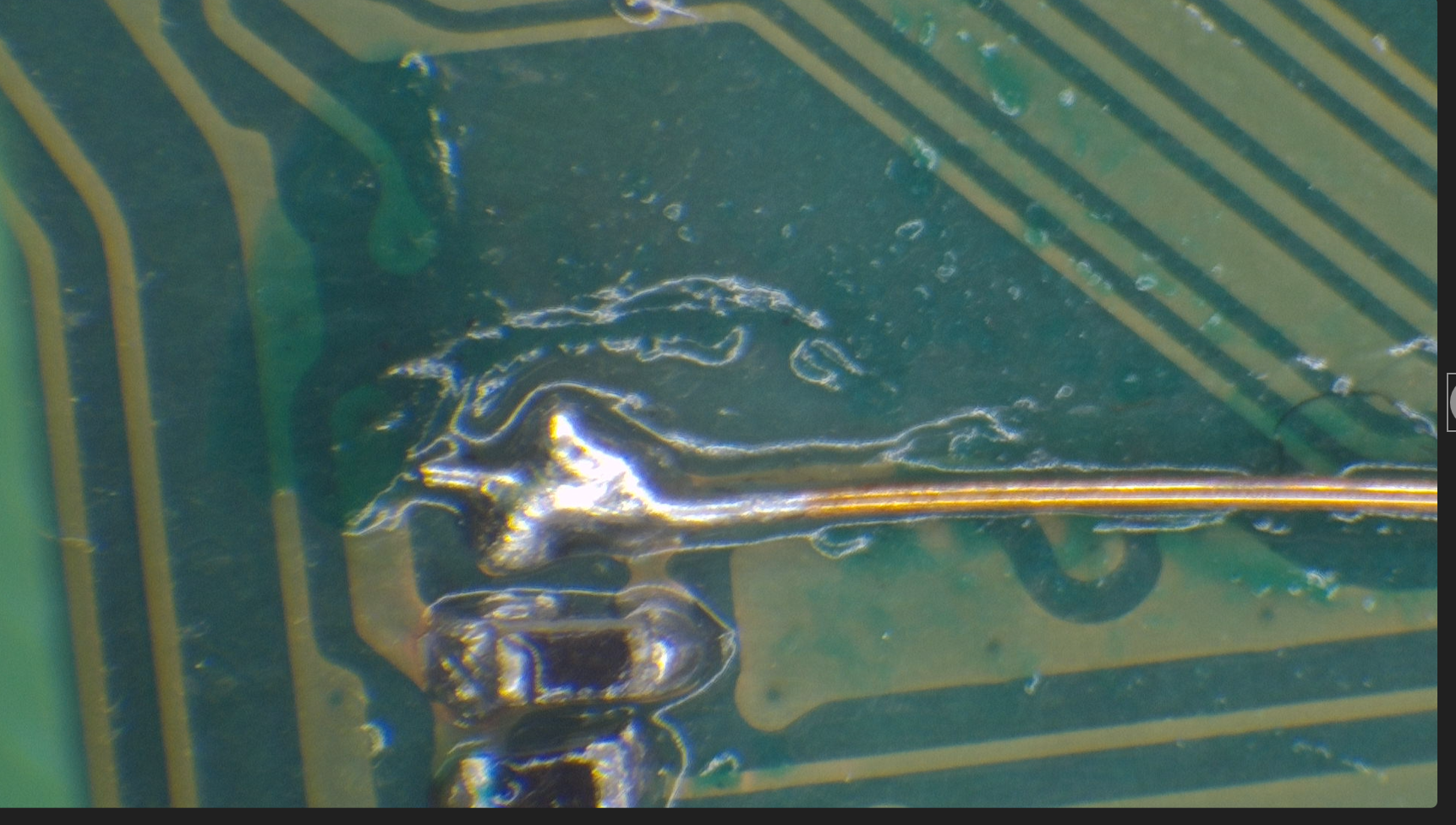

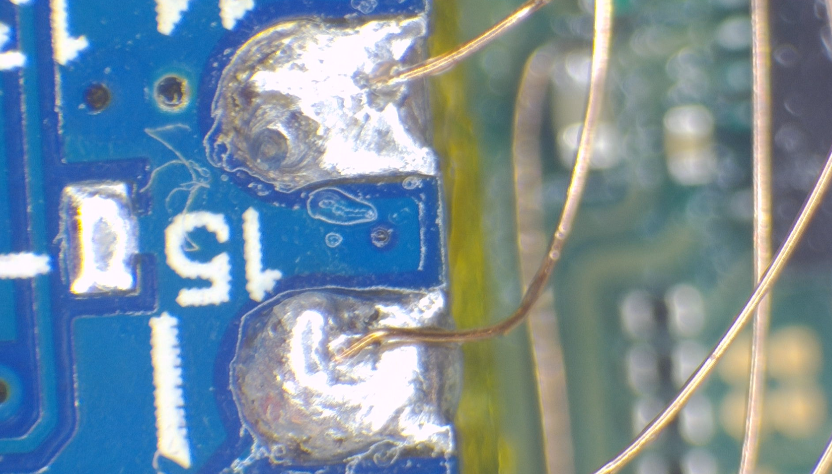

Sorry for picture quality . My camera hates flux , and i dont want to clean it yet until i fix this problem.
Doesn't want to clean the board so people maybe can see everything better.
But he wants people to spot the issue with low quality pics so he can get the issue resolved.......
Clean the damn flux and upload better pictures.
Specially pictures where u can see the soldering properly and where your wires go if u want proper help
Reactions: lightninjay

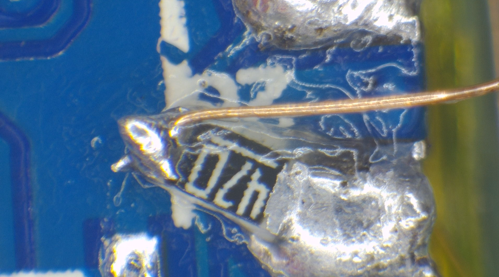

Dat0 : picofly PIN->2xresistor->dat0 mother board = 94 ohm reading in continuity mode.
CMD: picofly PIN->2xresistor->cmd mother board = 94 ohm reading in continuity mode.
CLK: picofly PIN->resistor->clk mother board = 47 ohm reading in continuity mode.
RST ; picofly PIN - RST POINT 0 ohm resistance

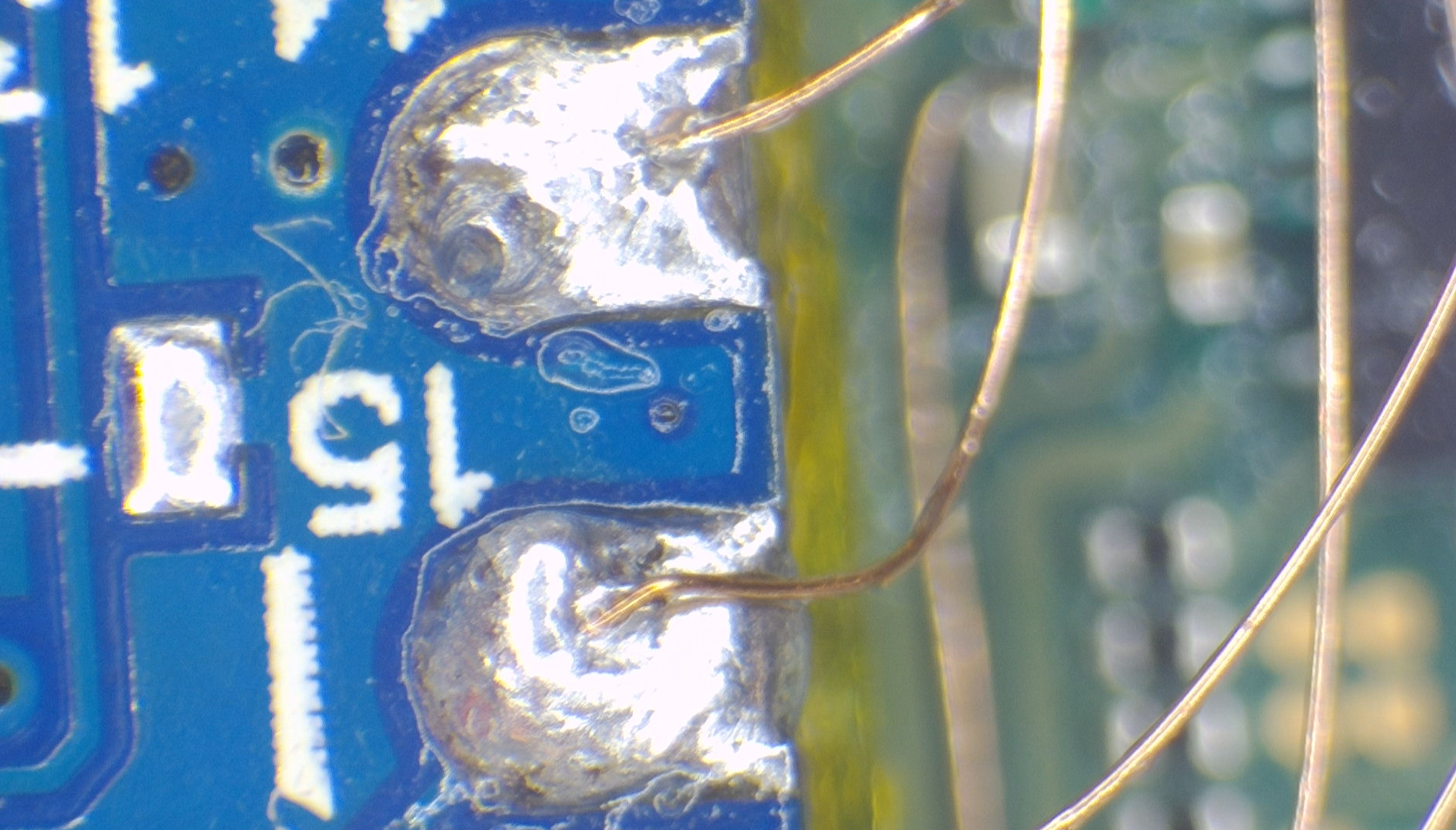

My flux is really bad,i can barely clean it without damaging the soldering/wire. In photos,i have DAT0 and CMD resistors lifted off the picofly board. I did this AFTER i got the errors thinking that i might have a short on picofly to some acces points. That was not the case. Also i did not use flux anymore when i lifted them, that is why the soldering is oxidized.
Use lots of IPA and a fine brush to clean everything. Flux could create issues on signal quality, especially for RST which is quite sensitive as already told by rehius. Use UV solder mask to fix the cables, this way they won't "fly away" when cleaning.
Upload some pictures of those MOSFETs as well.

My code is *=* No eMMC block 0 read (eMMC init failure?)

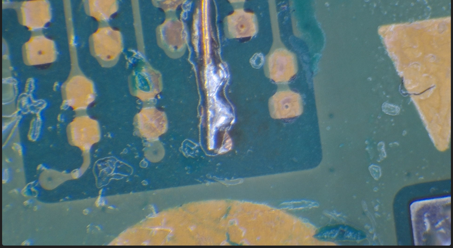

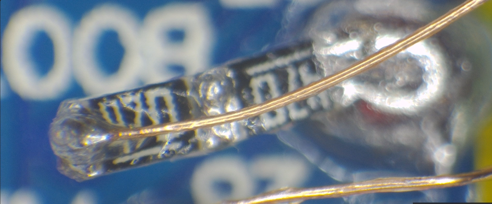

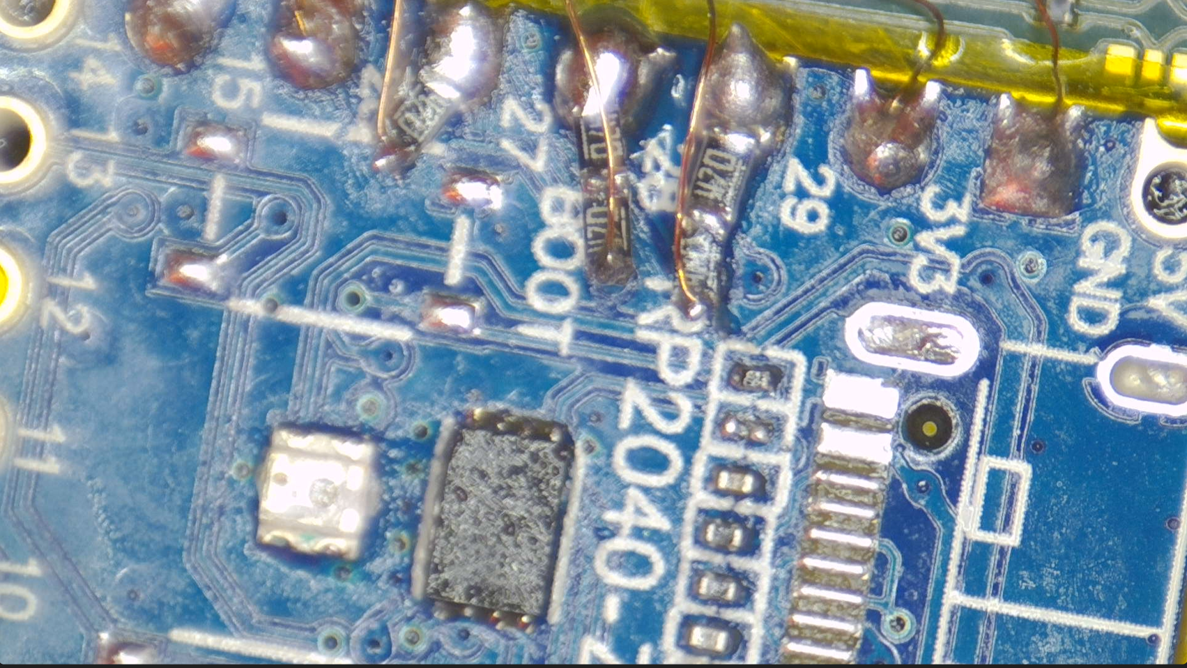

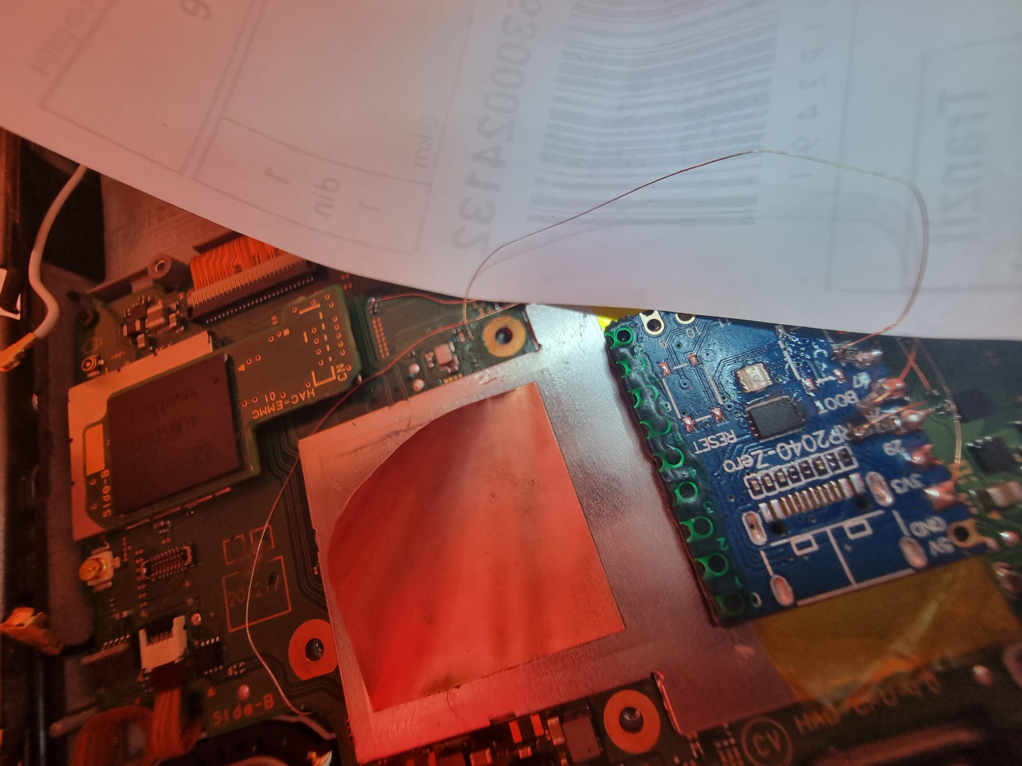

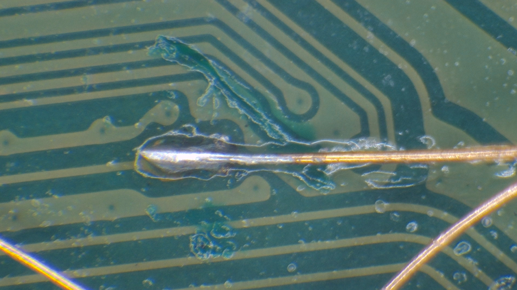

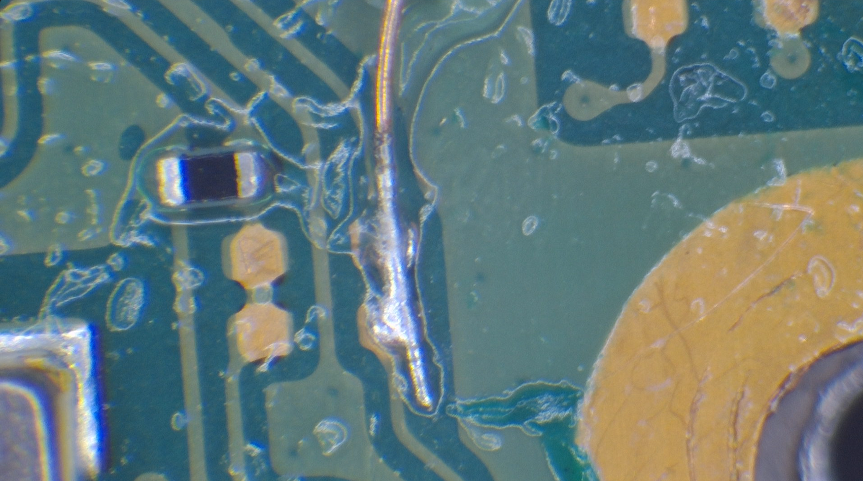

View attachment 395919View attachment 395920View attachment 395921
View attachment 395922View attachment 395923View attachment 395924
View attachment 395925View attachment 395927View attachment 395926
View attachment 395928View attachment 395929
If your flux is so bad that u can barely clean it without ripping off pads , what flux are u using?
Cause ur flux might also be the issue here.
Set ur dmm in continuity mode and stick it in the flux and see if u get a reading if so the issue here is probably the flux.
In that case ur gonna have to clean the whole board properly.
Since u have 2 resistors on DAT an cmd have u tried with 1 some boards don't work with 100/94ohm
Sorry i was joking about riping off pads. I use a cheap amtech clone . That s what i could get in my town and yeah. What i meant about the flux is that its hard to get off,even with ipa and cotton swabs, the board doesnt look "clean" as it would be from factory to say so. And no, its not conductive,otherwise i would get a short on the points i am getting my 3.3 V a long time ago+ i tested just now and its not.
Also i have tryed already with 1 resistor on lines.
Did you check for continuity between DATA and power wires on Pico and testpoints on eMMC's PCB?
Yep. Looks good to me. Tested continuity BETWEEN dat0,cmd,clk,cpu,rst. Nothing is shorting.
Tested picofly->emmc test points, i get the right values aka 94 94 47
As for the data lines(dat0,cmd so on and so forth)nothing is shorting either ground or power. data lines to ground are 500 wich looks ok to me, and data lines to 3.3v is 900 wich again looks ok to me
At this point i would have preffered the board to catch on fire because then i would ve known that i shorted something. Unfortunately im stuck here in Limbo with a perfectly working switch that i am unable to mod
@Crung I was referring to something like this (STHETIX's HWFLY diagram for reference). So, one probe on RP2040 (before the resistor) and another one directly on eMMC's PCB, you should get close to 0 Ohm resistance. This way you can confirm that your wires are well connected to the OTHER test points which are on Switch's PCB.
Do you have a 3rd RP2040 board to try on? I had some weird behaviour with clones in the past, been ordering directly from Waveshare since.
Yes, i have done exactly that.What i meant by emmc test points is what you call emmc pcb. It kind of does not matter if i tested before or after resistor. I have continuity. On picofly pin, its 94. on the end of resistors its 0.
I do have other boards but i doubt that if i keep swapping , its going to fix something. I will try again tomorrow with another board i guess. Right now im going to sleep
Reactions: Phantomas77
Are you 100% sure those are 47ohm resistors? They appear to be labelled 470.
I don't have my microscope set up right now to check mine but I'm sure they would usually read 47R no?
Maybe I'm miss-remembering how the label codes work.
You mentioned that you measured them in continuity mode but I assumed that you meant resistance mode. Maybe double check this 🤔
Edit: See attached (from the install pdf)
