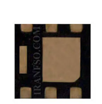

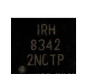

does this mosfet work for OLED ??
Mosfet IRFHS8342_N30V8.5A PQFN 2x2​

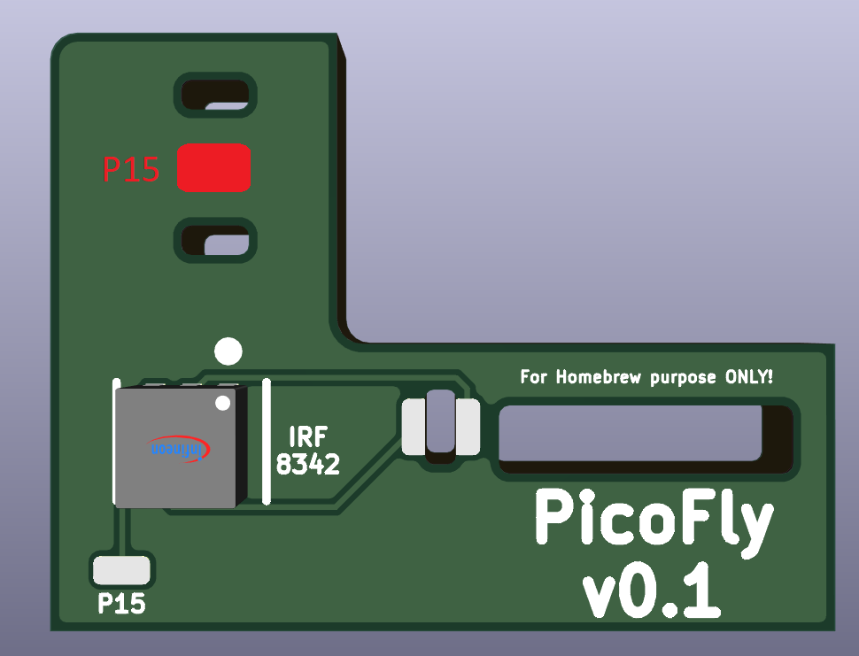

I already thought about this but still looking for another way to proper mount cable into CPU surface than solder it into metal frame. But if there is no better solution, I will be back with SX cable way.
Yeah, I agreed with i) and I would like to move in to new position (below image)
For ii), after I read rihius comment, I have changed it and edit this post.
