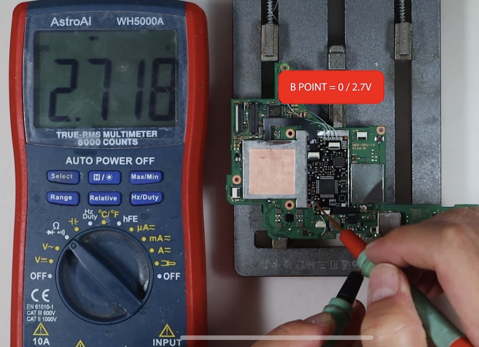

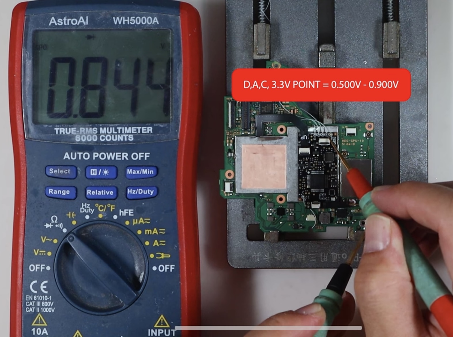

The below is for the OLEDs, as those are all I have installed experience with, out side of some trinkets/ unpatched installs. I do not have erista or mariko to test. Though I would assume they would be the similar. I also have not tested with an rp2040 since I plan on waiting for a proper pcb to be produced (if).
If the information I provided does get added to the OP I would like to add that diode readings should be taken for the other connections as well after the install. Testing once soldered to the rp2040 and before booting. Points should be tested on the rp2040. Obviously, do not test with the 3 resistors being between the the probe points or the resistor with change the values you get. Test where the wire is soldered. This will help to verify proper connections and mitigate having to troubleshoot your work.
Clk, Dat0,cmd, and 3.3v points should all range from .420 and .850 in diode mode. RST should read 2.7 or 0 in diode mode.
Clk, Dat0,cmd, and 3.3v points should all range from .500 and .850 in diode mode. RST should read 2.7 or 0 in diode mode.
Thank sthetix for the images pulled from his video. Note: HWFLY in the example pics
View attachment 361532View attachment 361534
Keep in mind that data 0 connection could have good readings and still not work. I find 420ish red probe on ground always working. 500ish is kinda high and can work on some but if you have any issues on re assemble I would check this again.
