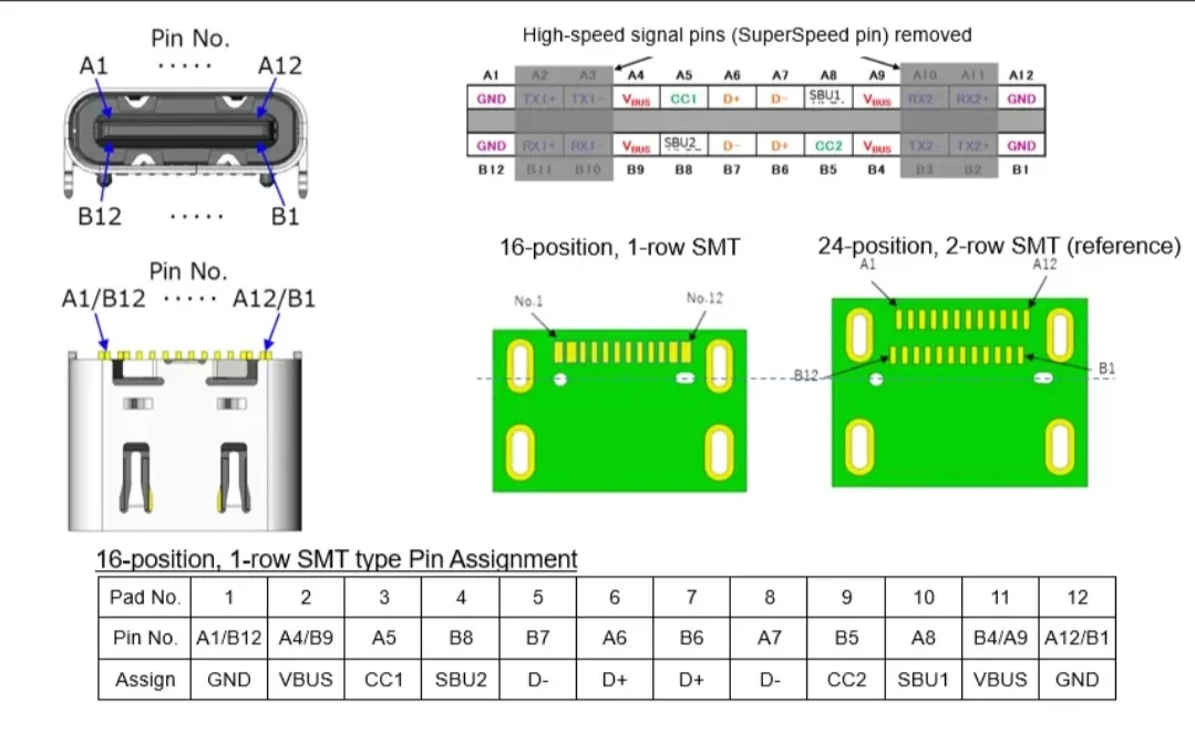

@Adran_Marit can you please add the info on how to reconnect USB & flash the chip after removing the USBC, Boot & Reset Buttons? I think with the 2.6 coming out a lot of people will need the info. These were from the post that helped me out in the other thread.
