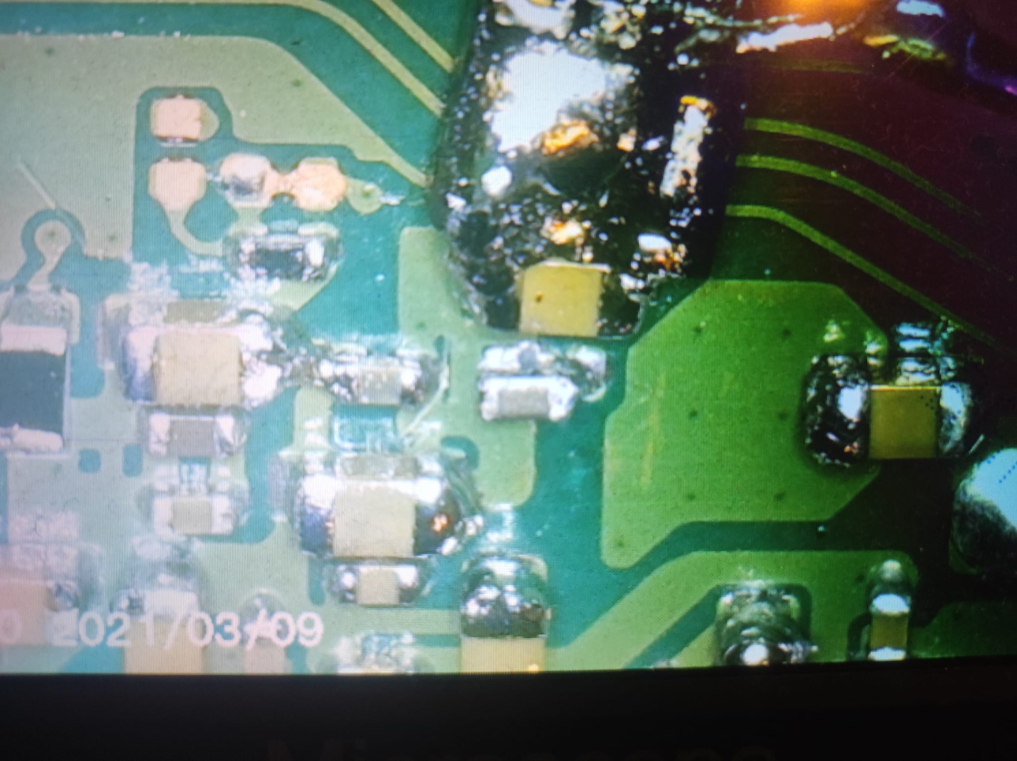

Hi! I tried to do the @abal1000x method and, unfortunately, screwed things up... Does anyone know what the value of this resistor is? Thank you in advance!

Could you encircle the component that you are looking for and mention what model you were working on on (OLED/V2/Lite)?
Hello there! First of all, thank you for your reply!
My switch is a V2, the resistor I'm referring to is the small black one right next to the cap. My friend, who made my first post, is afk for a while so I'm trying to give a quick reply. However, he sent me this photo from the net which should indicate the exact resistor.
Again, thank you! If needed, I'll update you as soon as he replies to my message.

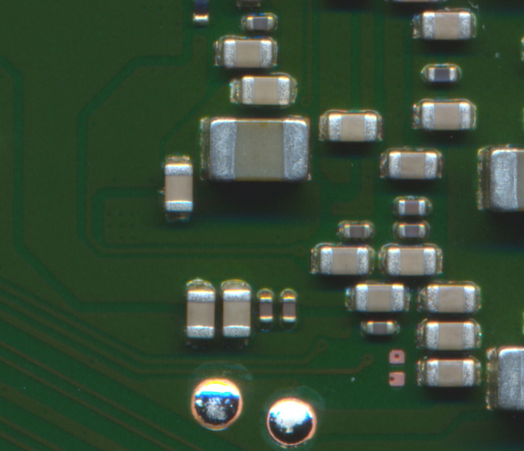

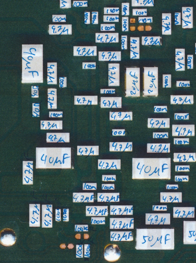

It looks like a capacitor to me if I'm not mistaken :
This is the same area of the OLED:
I could not find any details about a V2.
So small ones are 100n, medium ones are 4.7uF and the big one are 40uF.

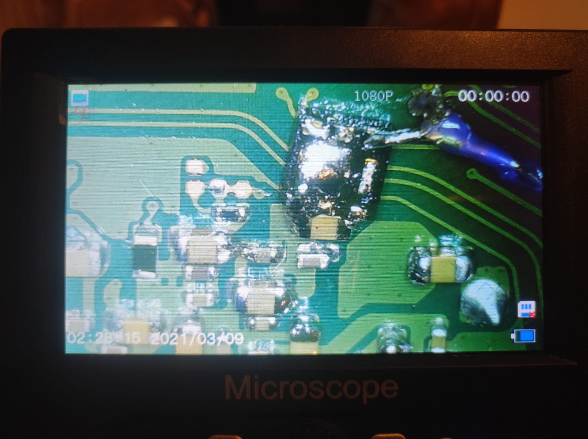

Hey there! I appreciate the answer, thank you! I mean it.
I have a better photo here to indicate which one it is.
By the way, the chip wasn't working on his first try, does anyone know why the soldered point on top wasn't working for the chip?
