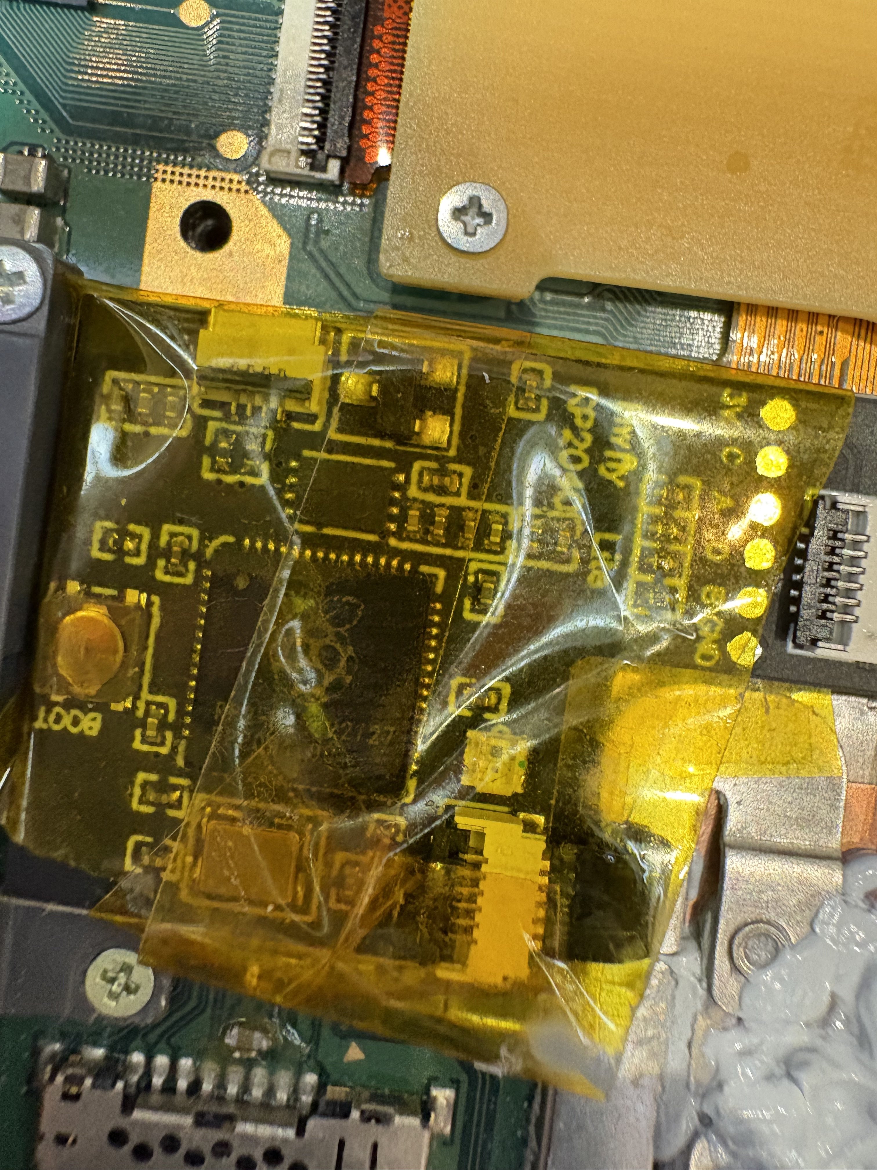

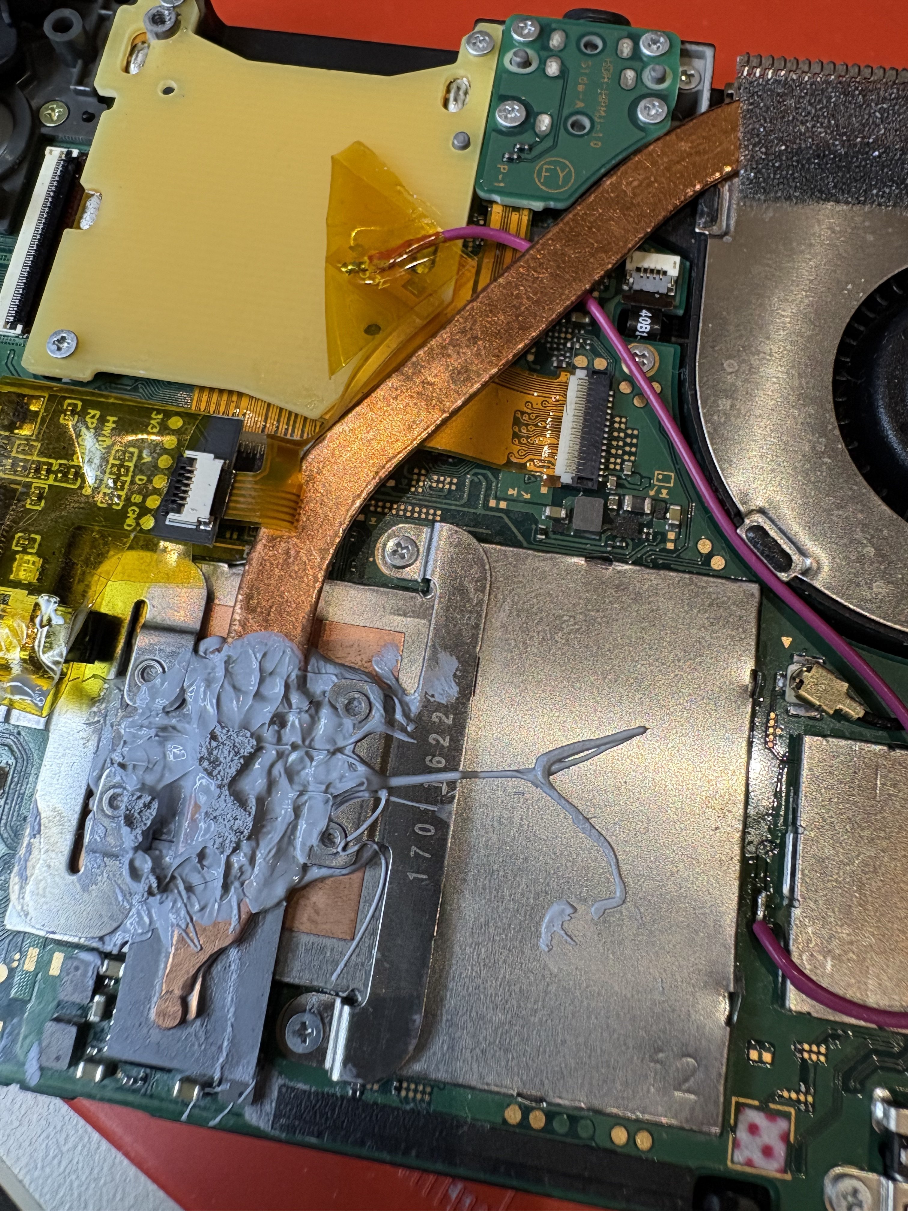

Hello guys. I bought the chip online, it had some pretty good reviews. I soldered it to my switch lite and it WORKS. The issues is that console started to discharge rapidly during standby mode (like 2% every hour). When the console is completely off it doesn't discharge so that's good. When it comes to booting to original fw, it discharges too, so I presume that the issues is hardware base. One thing I did differently is that I used different source of voltage (shown on screenshot), original one I screwed up (desoldered capacitor, needed to find new one, soldered one again - fixed) and I didn't want to struggle with it again. I don't know the fw of the mod chip, I just installed it :(. Is updating an option, or using diffrent current source caused the issue? Thanks in advance for reply!
2% is a bit much as the RP2040 uses about 24mA on average but maybe your battery has already aged a bit.
After glitching, the picofly basically does not do anything anymore
Still it will use some power because it has no option to power itself down.
So maybe the 'alternative' voltage point might be causing some side effect.
Some power rails get powered down in the standby mode and some other don't .
It looks like the point you are using is also used by the Wifi/BT module so maybe that might be active in standby mode in order to wake up the Switch through the joycons.
Thank you for the answer! Do you know which power rail is turned off during stand by then? I will desolder the power cable and see if it works?
Which firmware version? Check first if it also drains in standby with airplane mode on. If it doesn't, it might be a known software issue.

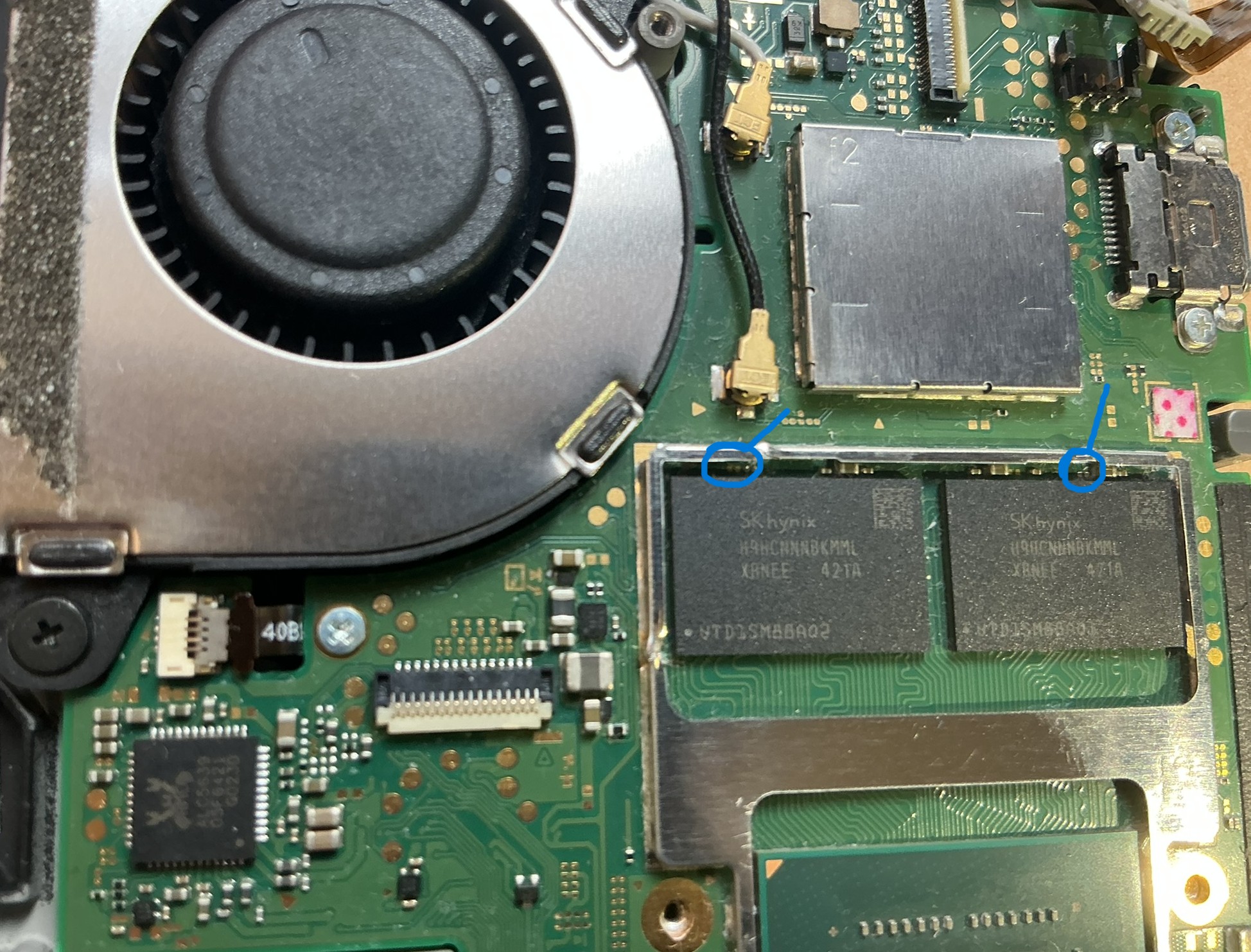

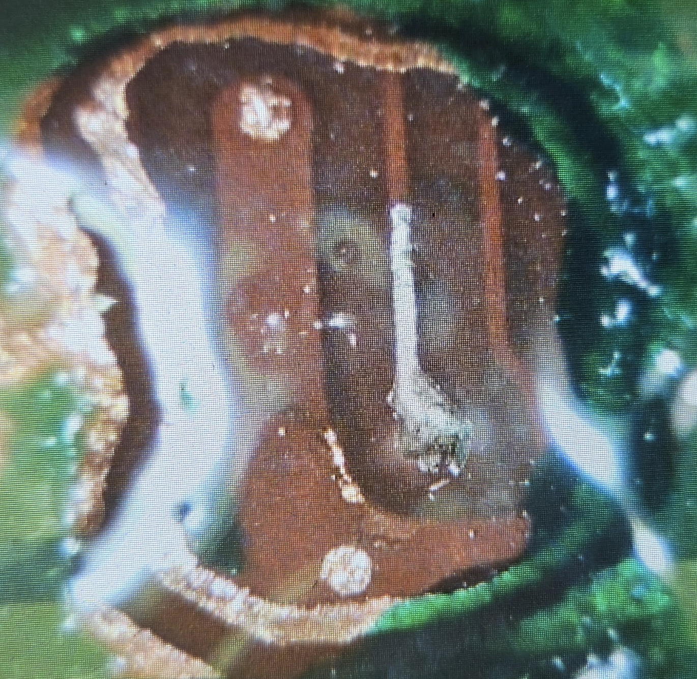

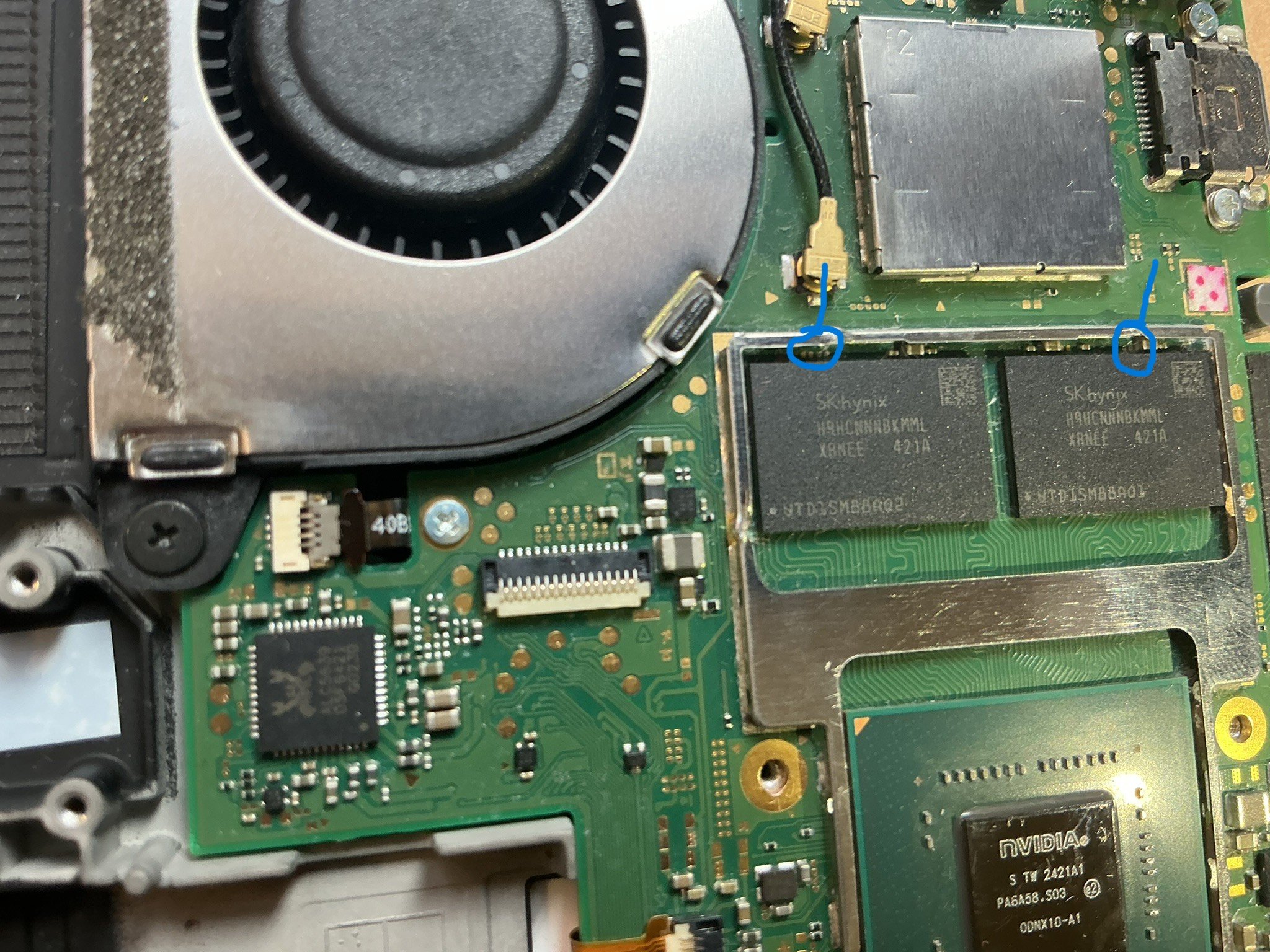

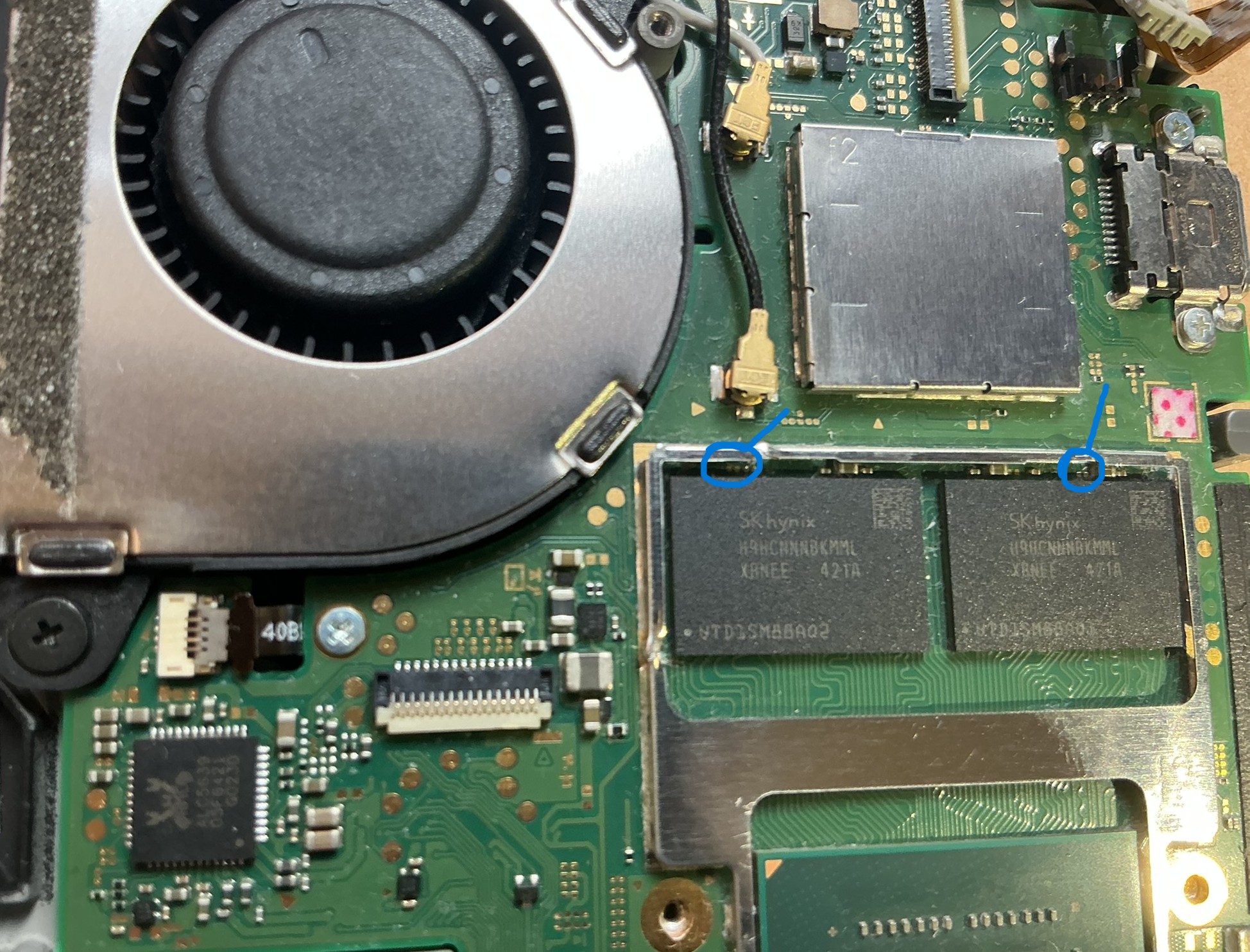

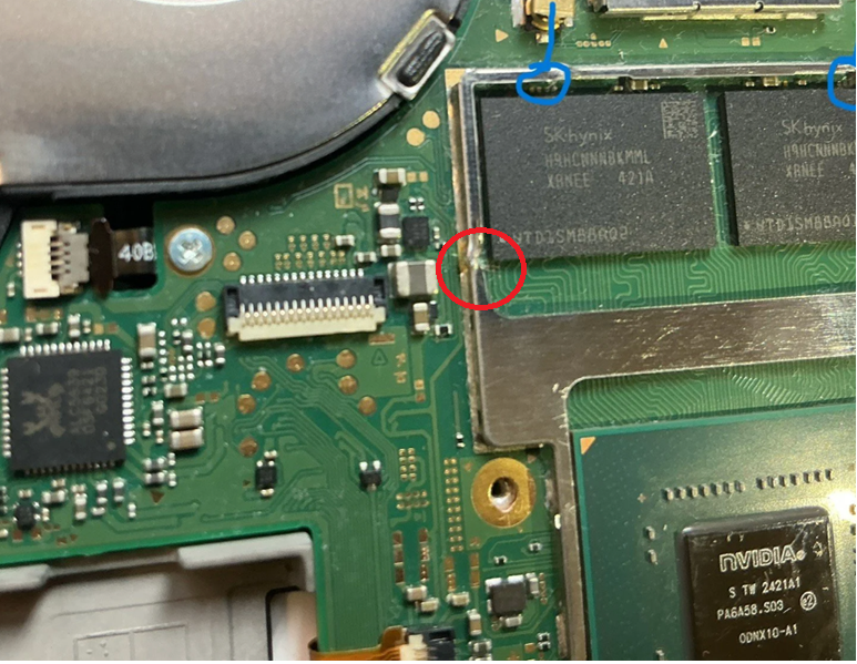

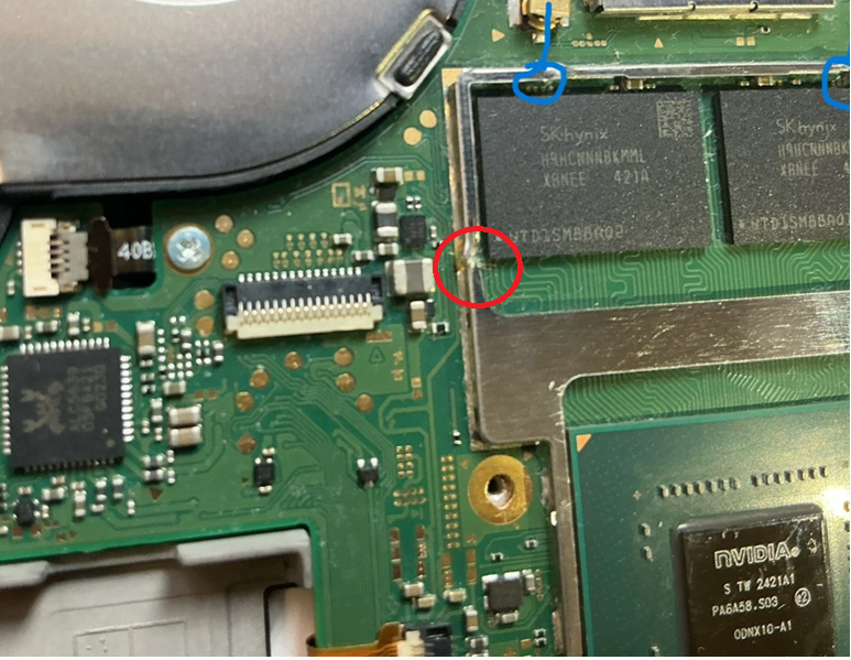

Hello guys. I have this nintendo switch lite and it has a blue screen problem and by checking the board I noticed two missing resistors near the ram of the switch I want to know the value or what type is so that I can maybe solder a new one to see If maybe that fix problem. I would really apreciate if someone could tell me.

Hello guys. I have this nintendo switch lite and it has a blue screen problem and by checking the board I noticed two missing resistors near the ram of the switch I want to know the value or what type is so that I can maybe solder a new one to see If maybe that fix problem. I would really apreciate if someone could tell me.View attachment 524067
You should check if ant traces been cut in red circle instead of looking for capacitors.
