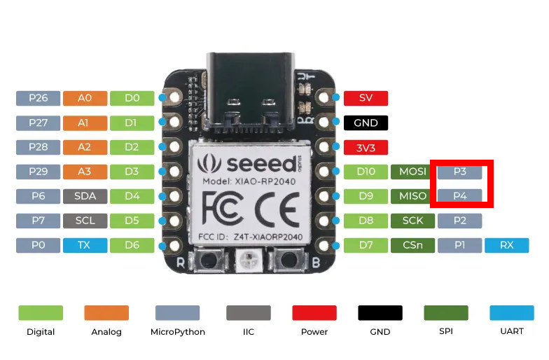

Thanks rehius, I just saw your replay from yesterday. Never would have guessed what 3 and 4 meant in the guide:D. There are numbers on the back of the XIAO boards next to the pins, so I just assumed the guide was wrongly pointing to overlapping pins.

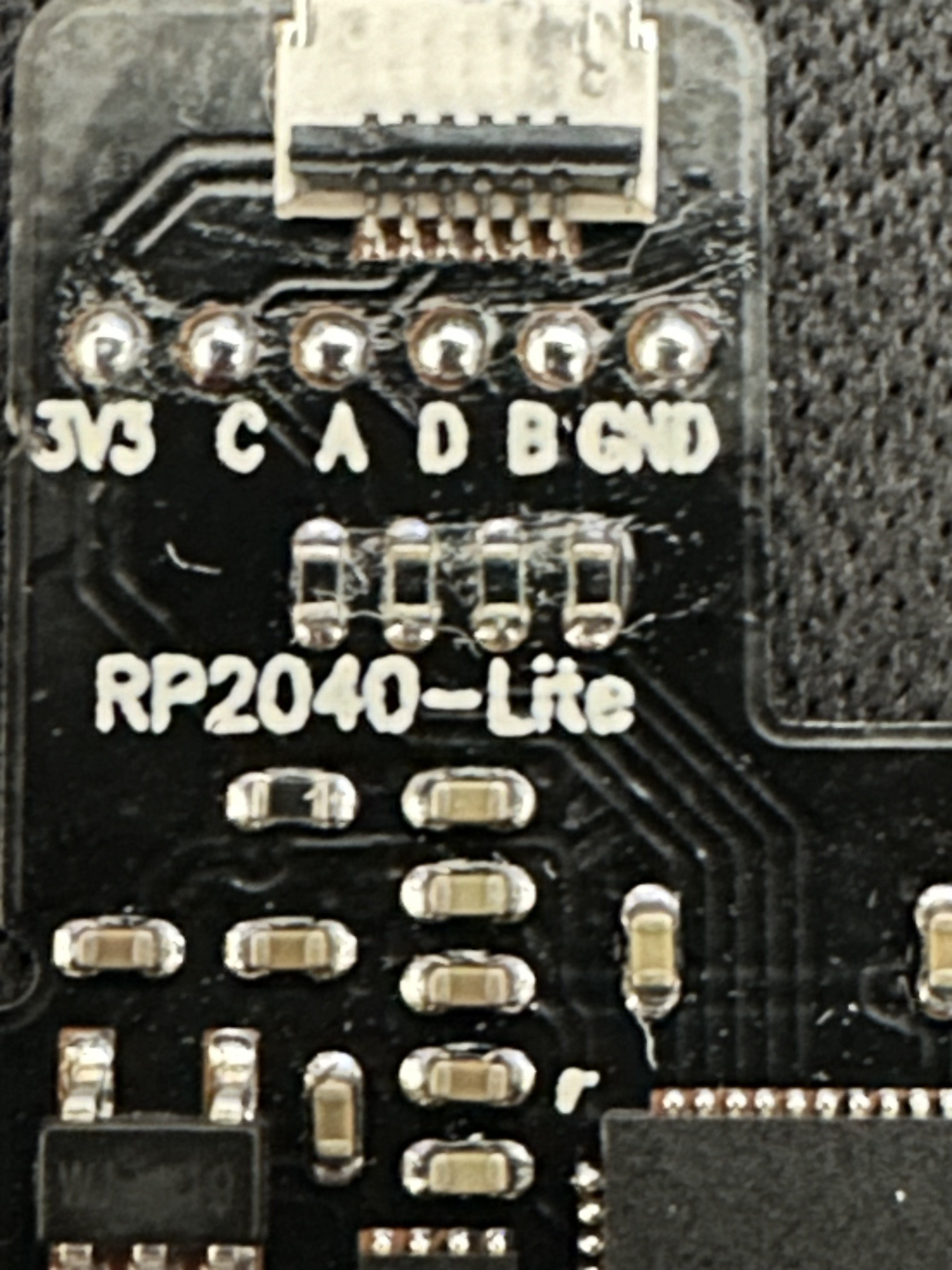

It seems that your modchip has burnt all your efuses...

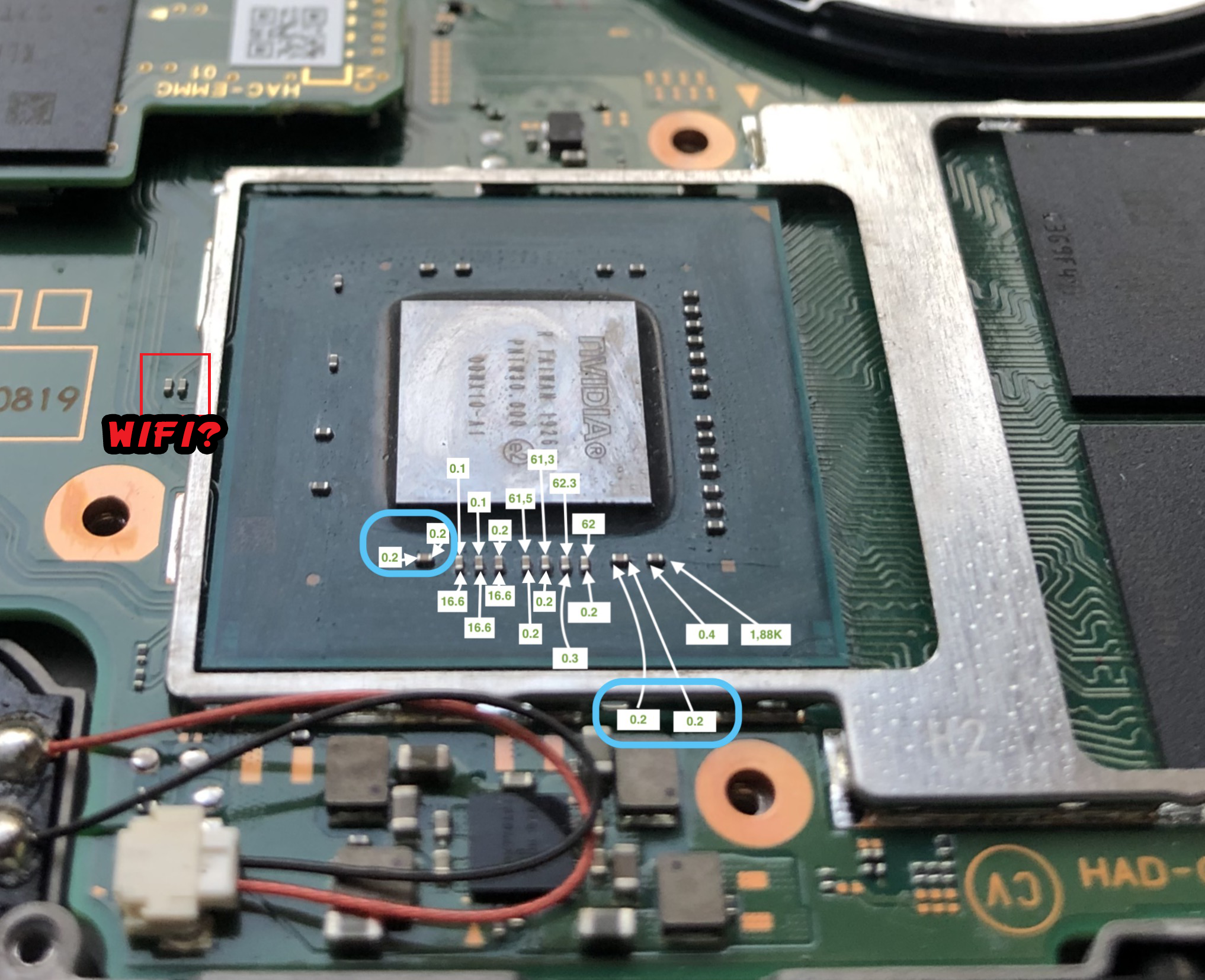

Aww Crumbs, I did it again!
Different switch, this time. I managed to knock these off a V2 (the ones in the red box it's a picture I found online)
I didn't notice until I put it together and everything BUT the WIFI seems to be working.
Does anyone know the values? I believe they're 0201 caps.
Thanks Again,
Vic
P.s. Is there a list of trusted people who offer repairs? perhaps by location. These 0201s are at the limits of my tools/steady hands.

u shouldve just replaced them with 100ohm that would be way easier .
now ur gonna have to cut the traces a bit back so u can set 2 resistor behind each other.....

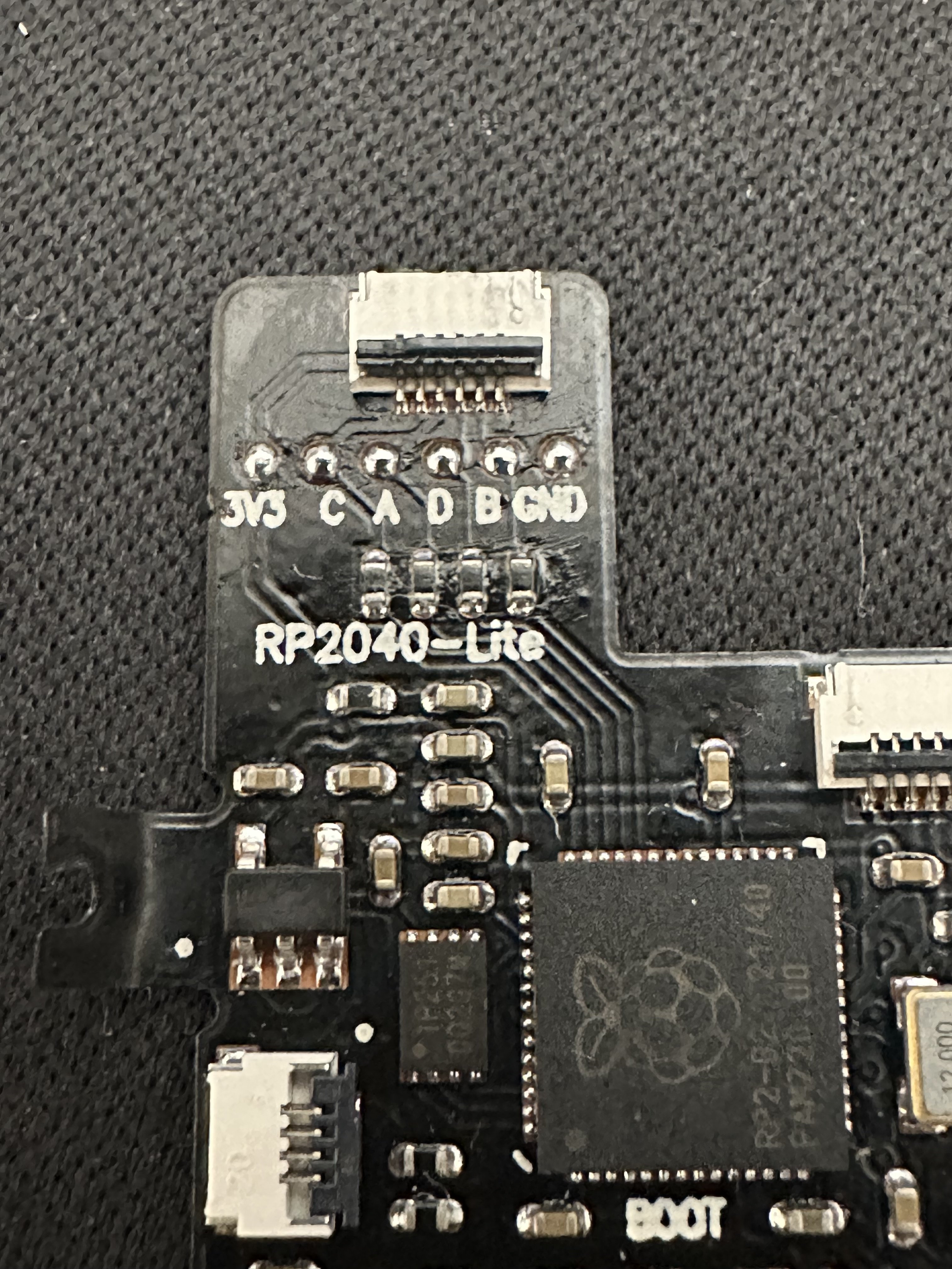

These arrived yesterday so I had time to mess around with them.
First time didn't work so I spend more than 2 hours pondered my head just to realize the balls isn't giving enough height to touch the pads due to flex but in the end it worked. I still think this was a hassle because I added small resisters to the line.
So my idea now is to move these resisters to my other flex to add more friendly sized ones and perhaps use goldfinger that latches to my other flex.

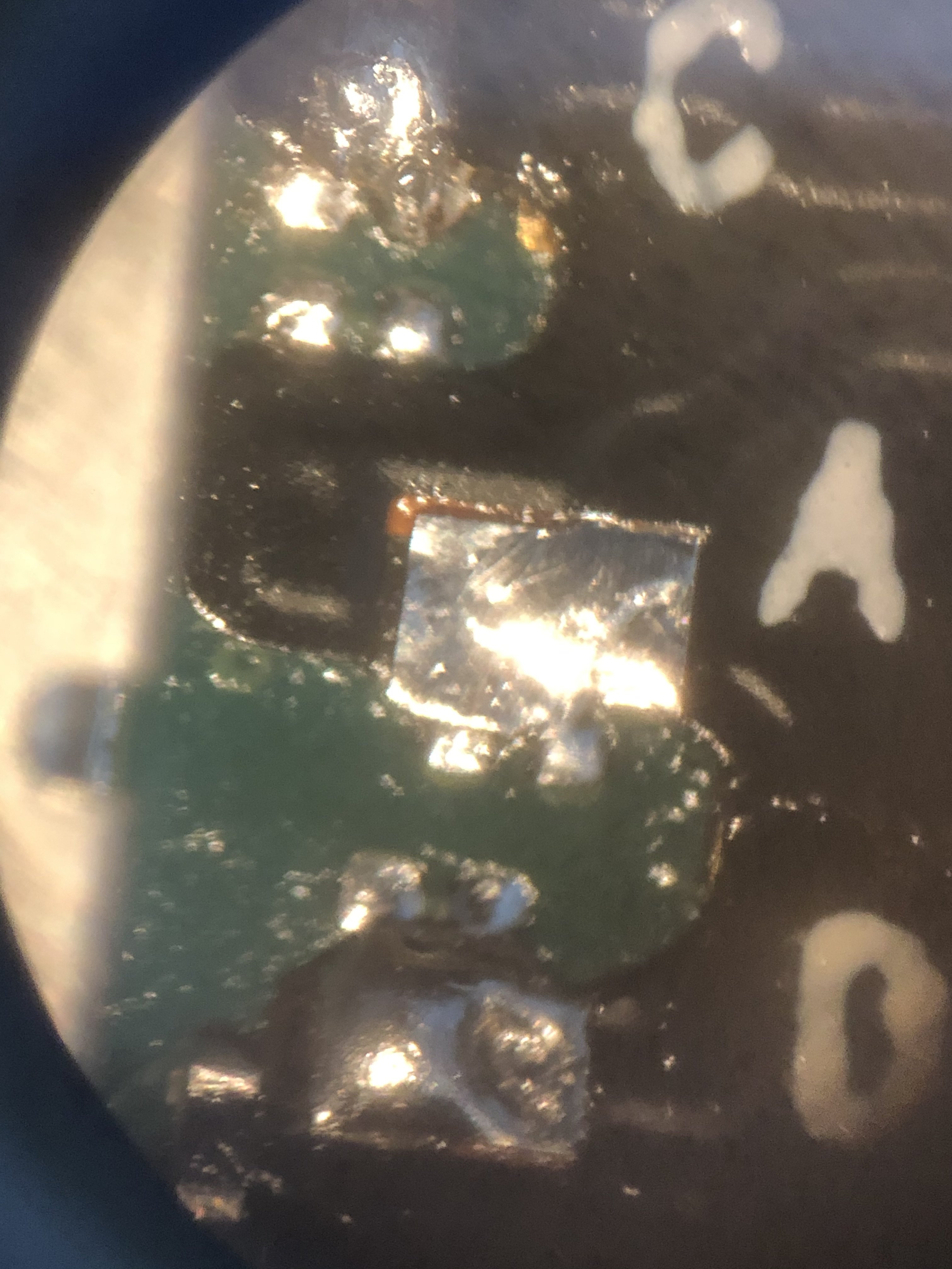

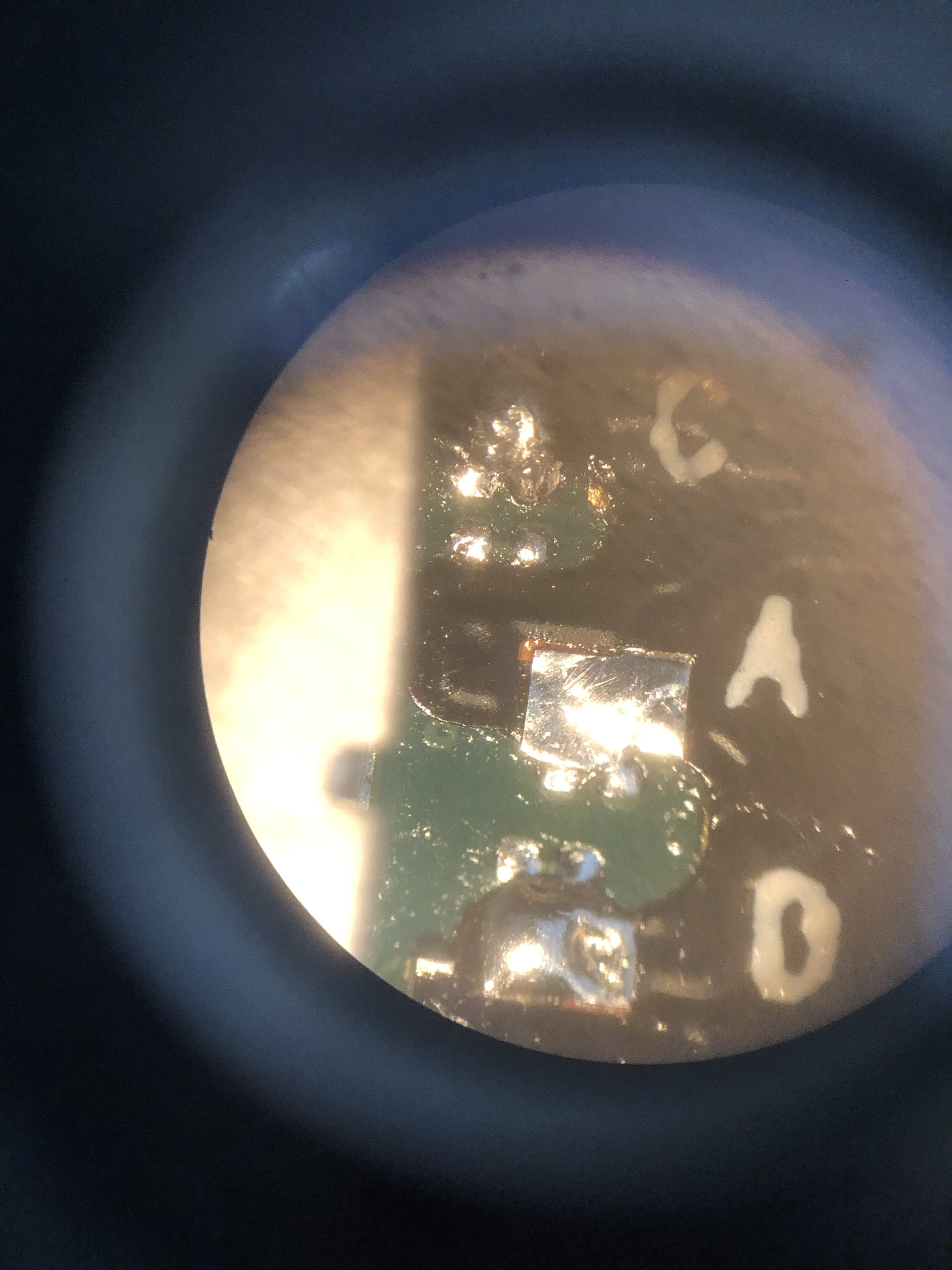

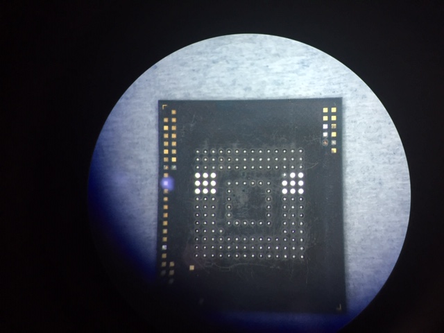

This is a picture. The white thing is solder mask. I am taking RST from emmc . I have problems with test pad RST,and emmc RST so we can rule it out. I isolated test pad rst because it was annoying to solder the wire there. Also RST resistor looks funny because i scratched the 1.8v line to have a better soldering spot when i was having trouble soldering on that place with soldering iron.

Using flex from @Hassal is faster, since you paste only once.
https://gbatemp.net/threads/picofly-a-hwfly-switch-modchip.622701/post-10266456
Using adapter you paste twice, first the adapter, second the emmc.

I only tested with PCBWay but you have to consider they charge a minimum fee so it doesn't matter if you fabricate 5-300 units they will charge you the same sum.
Setting:
2-Layers
Thickness is minimum offered (0.1mm)
Single or Panels up to you (I chose panels with set size 13X12 they ship in default size panels)
E-Test off
Everything else should be default
There is an adhesive layer which is optional covering only the upper portion of the adapter. The purpose of this layer is to prevent it from drifting during the reflow process. It will make your life much eaiser but you can totally ignore it and use your own method to hold it in place. If you leave this intact you need to choose Tesa tape Onesided BOT.
For resister sizes it's 0402. (0603 should also fit) (Imperial size)
One thing to keep note, if your ball height isn't enough you need another scoop of paste. It threw me off the first time because I was getting a reading on my adapter but in reality some weren't even touching.
