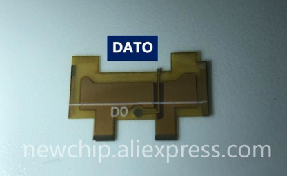

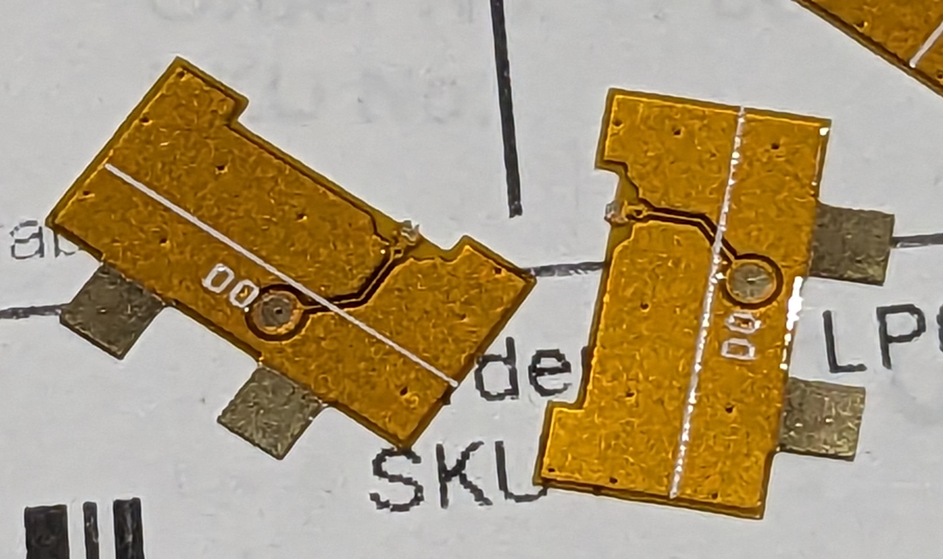

I got fked by New chip Store on Ali - here's what they listed:
https://www.aliexpress.com/item/1005005667369490.html
And here's what they sent me:
What the hell, these couldn't be the furthest thing from one another... And they're unwilling to refund.
There's a new hwfly store selling the ones that look good, but we don't like supporting hwfly here, so I'm not sure which seller is legit for these: https://www.aliexpress.com/item/1005005674625886.html but store opened May 18, 2023, so not even sure it's legit.

I bought from that exact store you linked, they seem legit. Here's how they look like:
Dee's advice is solid though, this is the last time I'm buying these adaptors, I've ordered a full emmc reballing kit and I'm doing it the right way.
