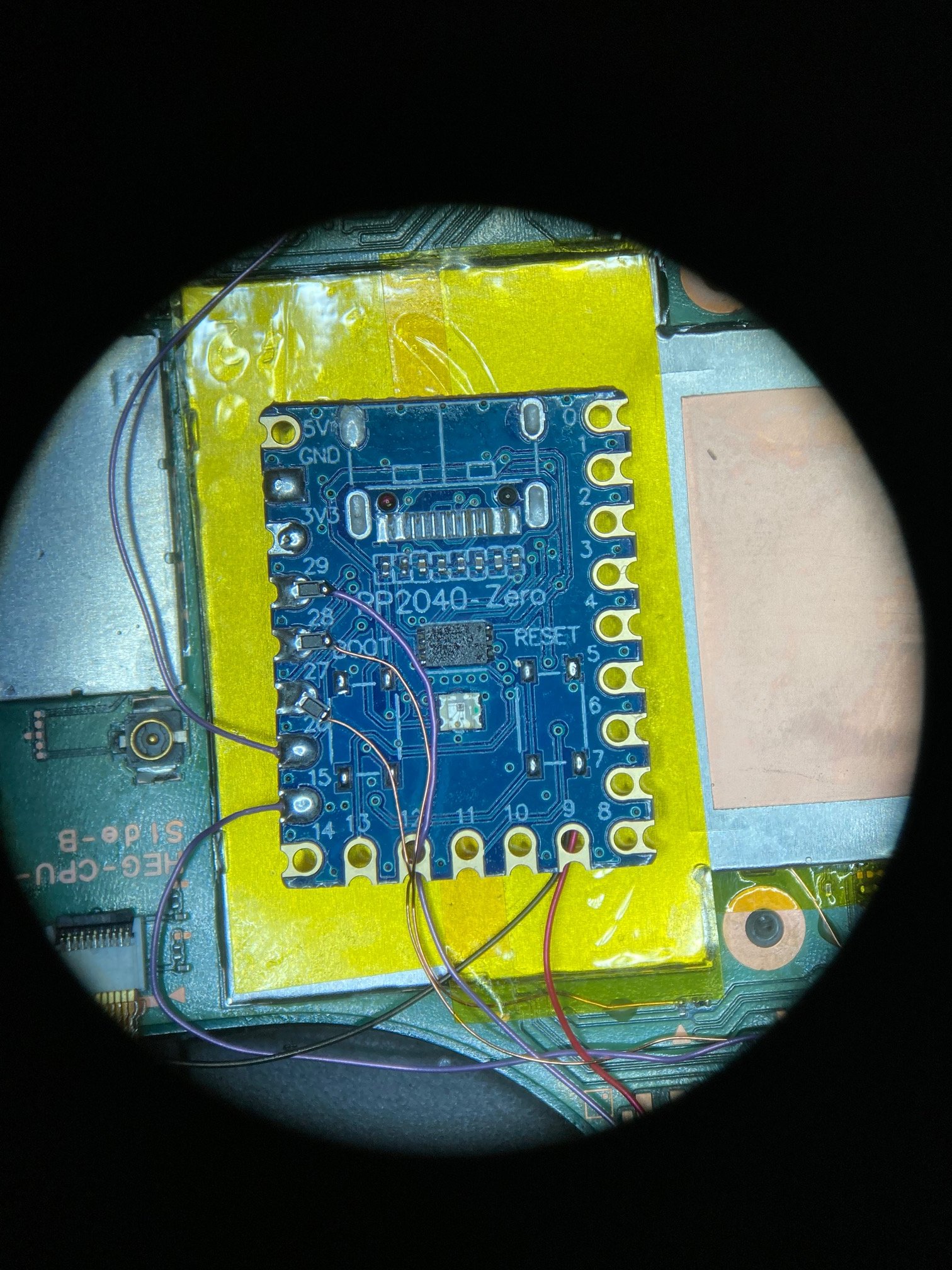

Sooooooo did a Lite the other day and I can confirm that it worked great. My first Lite got bricked because i used 2.72fw and this time used a working firmware (2.67 in this case). Used all the points from the guide so the ground point and all other points aren't an issue. Some redemption for me here.
And used the IRFHS8342PbF with a pull down 1k on it using the back of the motherboard for my points as @abal1000x discovered. It initially worked 3-4 times but it was strange. It held the blue led for a second or two and then blinked blue and then green. Great. But then after 3-4 times, it did the infinite blue glitch. I'm not sure why. Maybe the pulldown resistor was too high, who knows. @floxcap might be onto something with using a lower value pull down for this mod. So I used another IRFHS8342PbF and removed the pull down on the other one too. Paired them, connected the relevant points and success. Normal super fast glitching. Thought I 'd share the finding but 1k might be too much for a pull down.

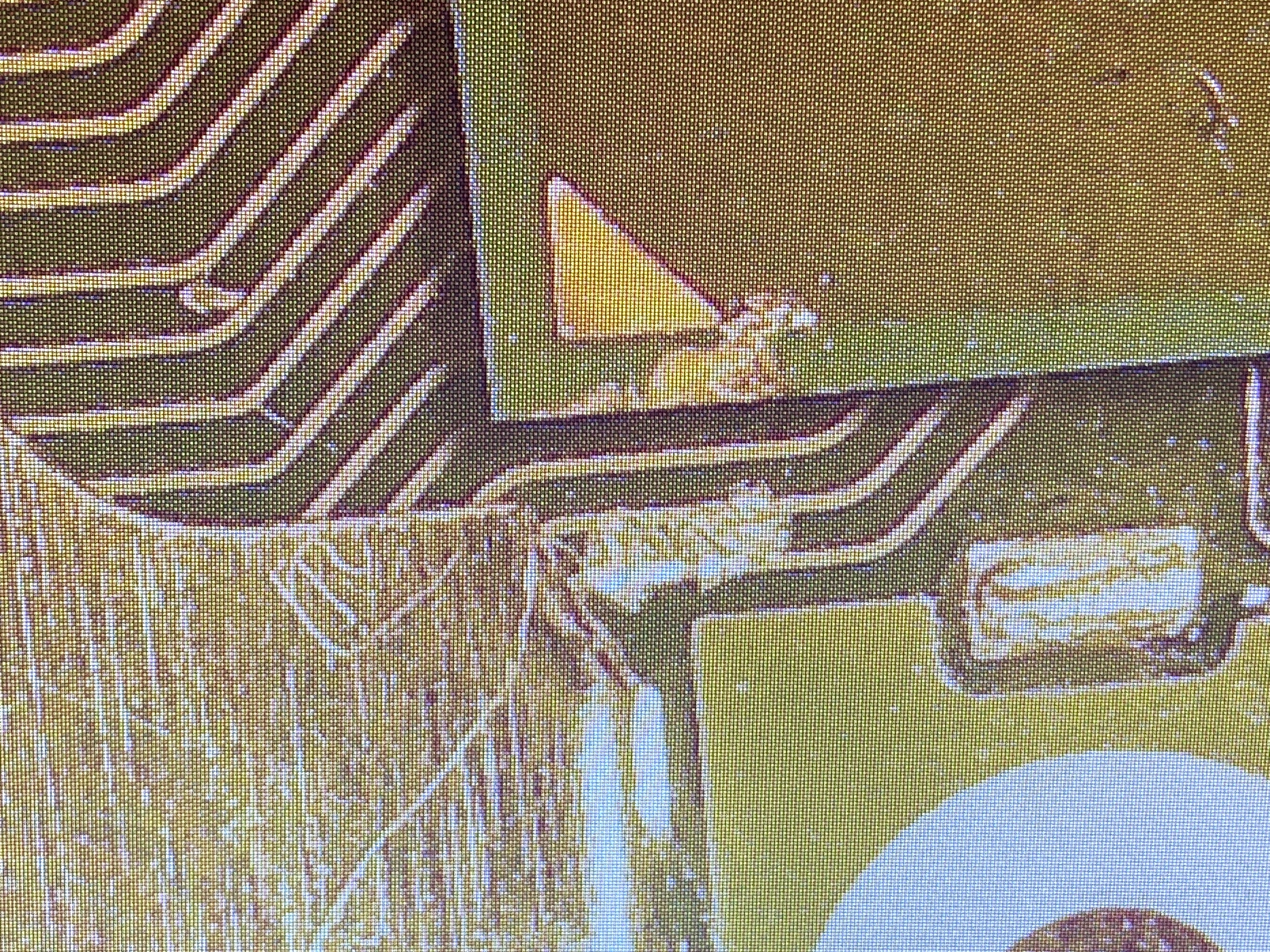

How fucked am I?
I accidentally scratched some of the solder mask near the chip when removing the rail.
I am worried that I accidentally severed the tracks.
Anyone know if my switch will still work?

How fucked am I?
The only way to know if u damaged the trackes is to use a multimeter or take the risk and try to turn it on
How fucked am I?
I've done that. Still works. Just solder mask cover it up and look the other way.
1k is too low, you might change it to 10k, or 50k.

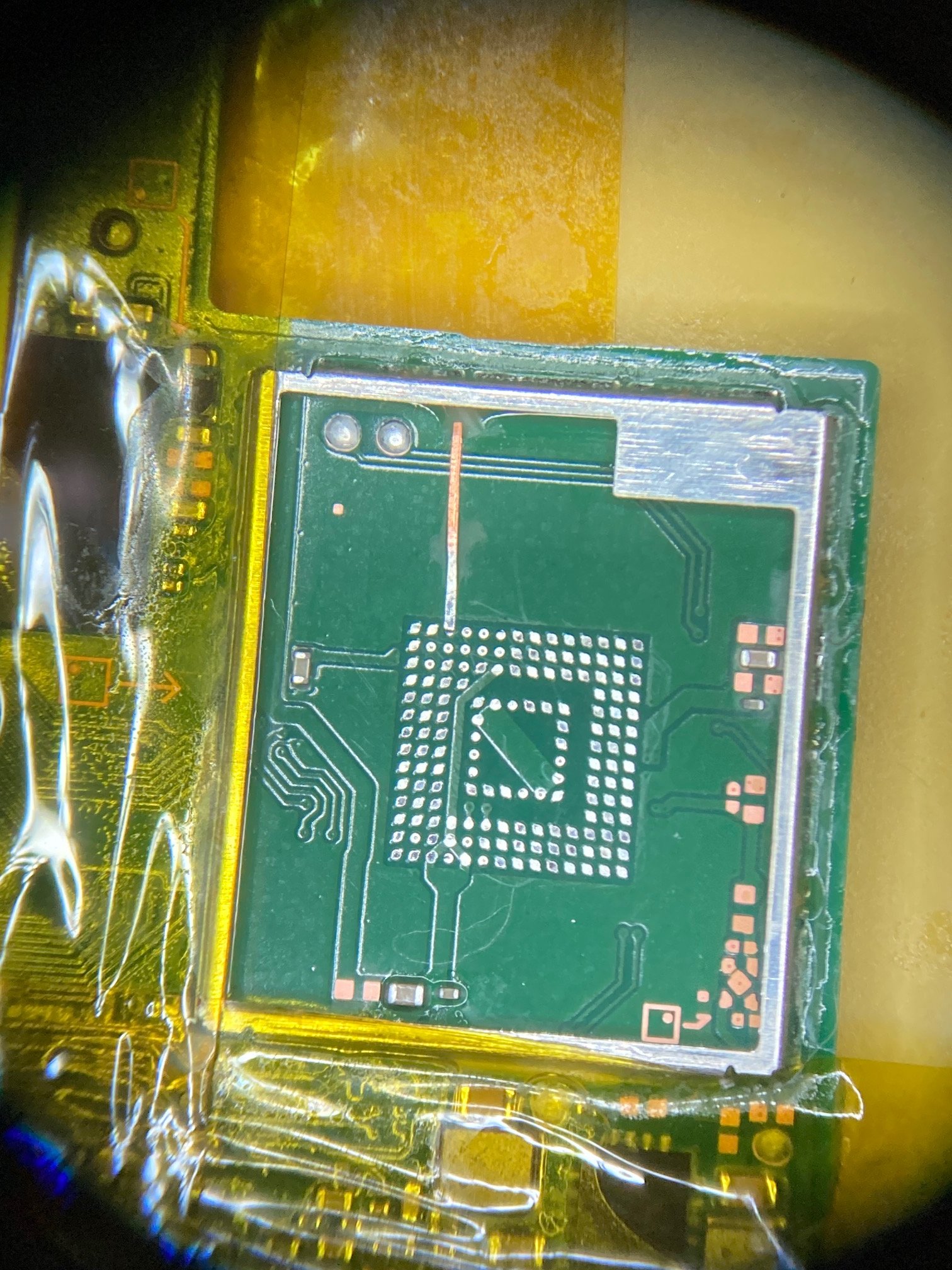

DAT0 adapter reading was at 650, but when I check point C on the instinct, I am getting a reading of 350. A,C,D all give me readings of 350. No way that all I soldered all 3 points wrong and they are all at 350. I don't want to try turning my switch on until someone with more experience chimes in.

Wires look good and the DAT adapter point was reading at 650. ( Wire connected to adapter =650 Wire connected to chip = 350)

Look here. I thought you had a pico mod, why on earth are you using a filthy dirty nx chip? Anyway your fix would be as follows. First check if those torn traces give continuinity in diode mode. If they short then you must repair those traces.
In future, create a new thread asking for help about your specific chip you're using and the problem you're having. This thread does not support or help hwfly/nx installs or anyone looking for debugs/troubleshooting with those chip installs.
