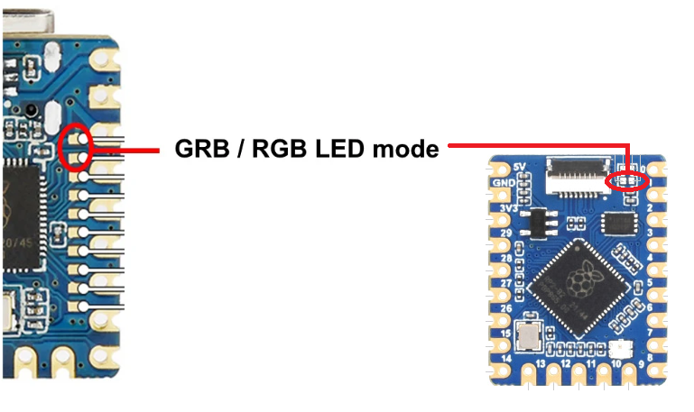

Hello! Just received my RP2040-Tiny from Waveshare and after flashing, I see the RGB colors are inversed - I don't see the pads to swap the colors on the Tiny since it's so much smaller, is there an overview on what needs to be bridged? Mine flashed green and rehius' original post mentions having to make the colors swap.

2.74 is striked out because of the frequency though - are you referring to that? I flashed the 2.73 that's attached in rehius' post.
Mine flashes green like it's mentioned where it's needed to swap the colors.
Have you also read the latest guide? If you are flashing anything 2.7+ there are no more color codes, just flashing LED codes with long and short pulses. Color does not matter anymore.
The guide mentions yellow color after flashing is done, which I didn't get, but from what you're saying, I understand that the color isn't important anymore, just the flashes themselves and if they're long or short to diagnose problems.
And a follow-up, if anyone still wants to get the right colors out, after comparing the schematics, the pads for this color swap are on the front top right over here.
On the left side is the RP2040-Zero and right side is the RP2040-Tiny and the GP25 pad that needs to be bridged to swap the color mode.
Just tested it and the color swapped for me.
EDIT: Don't do this, I must have hallucinated the colors swapping, there's no reason to anyway since FW 2.7 as lightninjay confirmed.
You know what, forget it, I must have hallucinated, what I thought was green was yellow upon closer inspection and flashing a second chip. While this probably does swap colors, the ones used on the latest FW aren't relevant anyway, so there's no need to do this.
