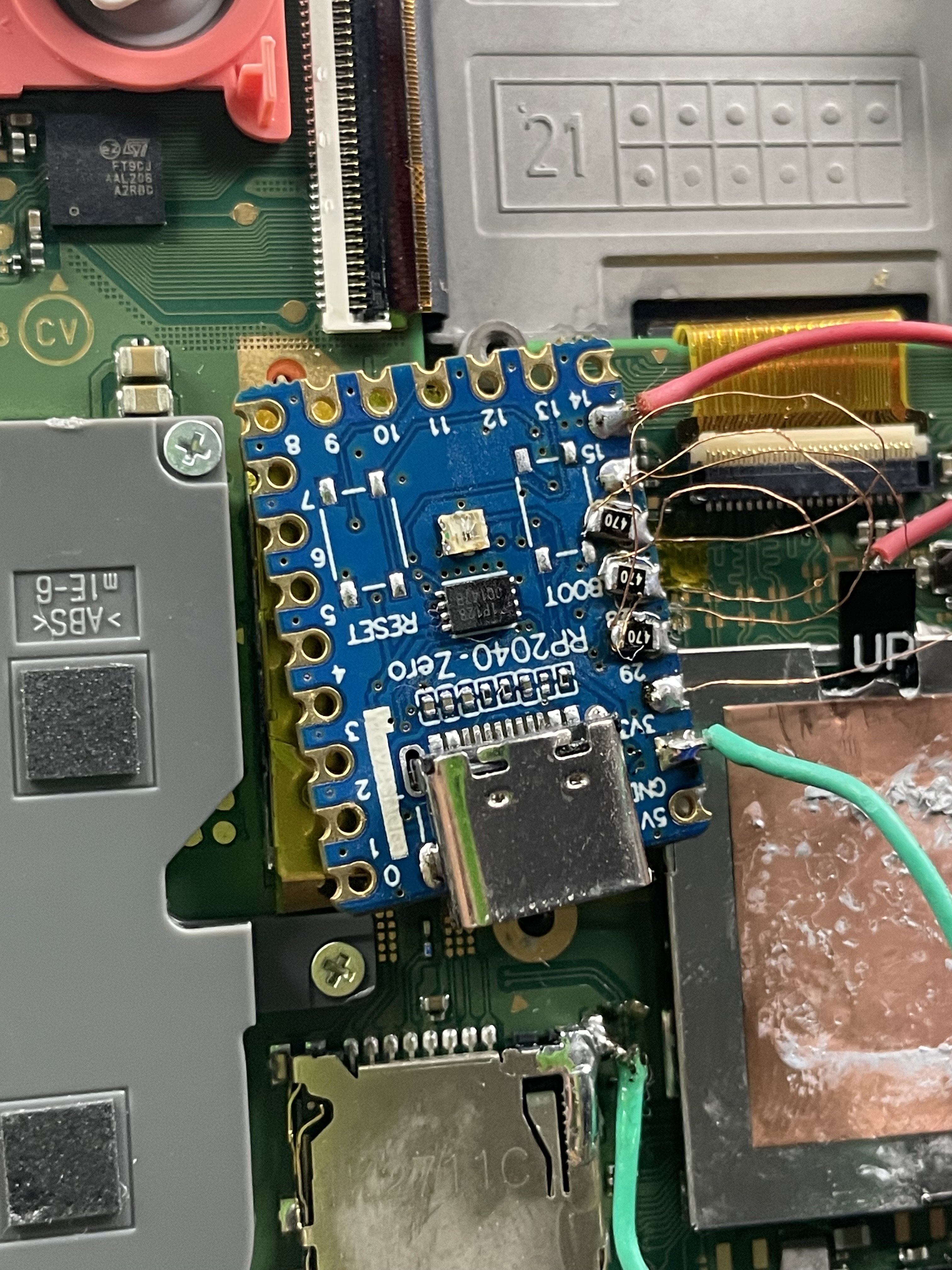

Not without seeing photos of your soldering job
it was working perfectly until it gave orange light when i removed the chip i updated it to see the error codes then now it is giving this =*** and it starts in OFW
estava funcionando perfeitamente até que deu luz laranja quando tirei o chip atualizei para ver os códigos de erro então agora está dando isso =*** e começa em OFW

How long was it working for until you encountered this problem (time frame)?

These days not much can be done with just words to fix a problem such as yours. Do you have something to show us fine folks of this community?
ok sorry for my english , the console works for 5h no issues i restart it and power off several times and no issues like 10times no issues , the 11 the console boots to ofw every single time , i trie to get to hekake by power on and off , but ofw every single tiem until the purple screen happerns , i take the console apart disconect the battery and star messuring , 4.7kohm cmd ok , all 3 47ohm resstors of the pico ok , no shortss , so i plug the battery and everything working just fine . the console is working no more issues . very wierd

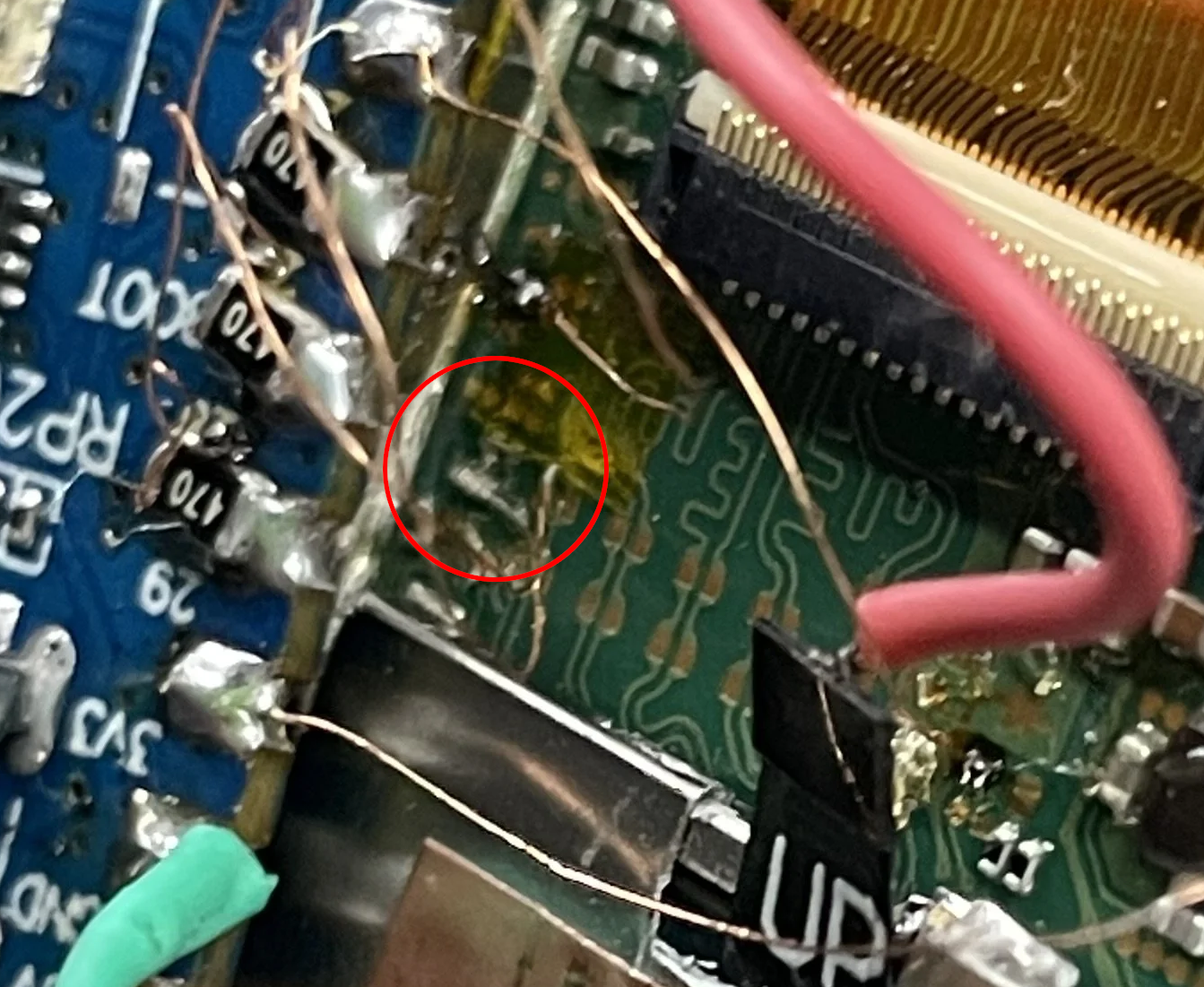

This area near your CMD and CLK pads looks suspect. They might even be bridging to each other.

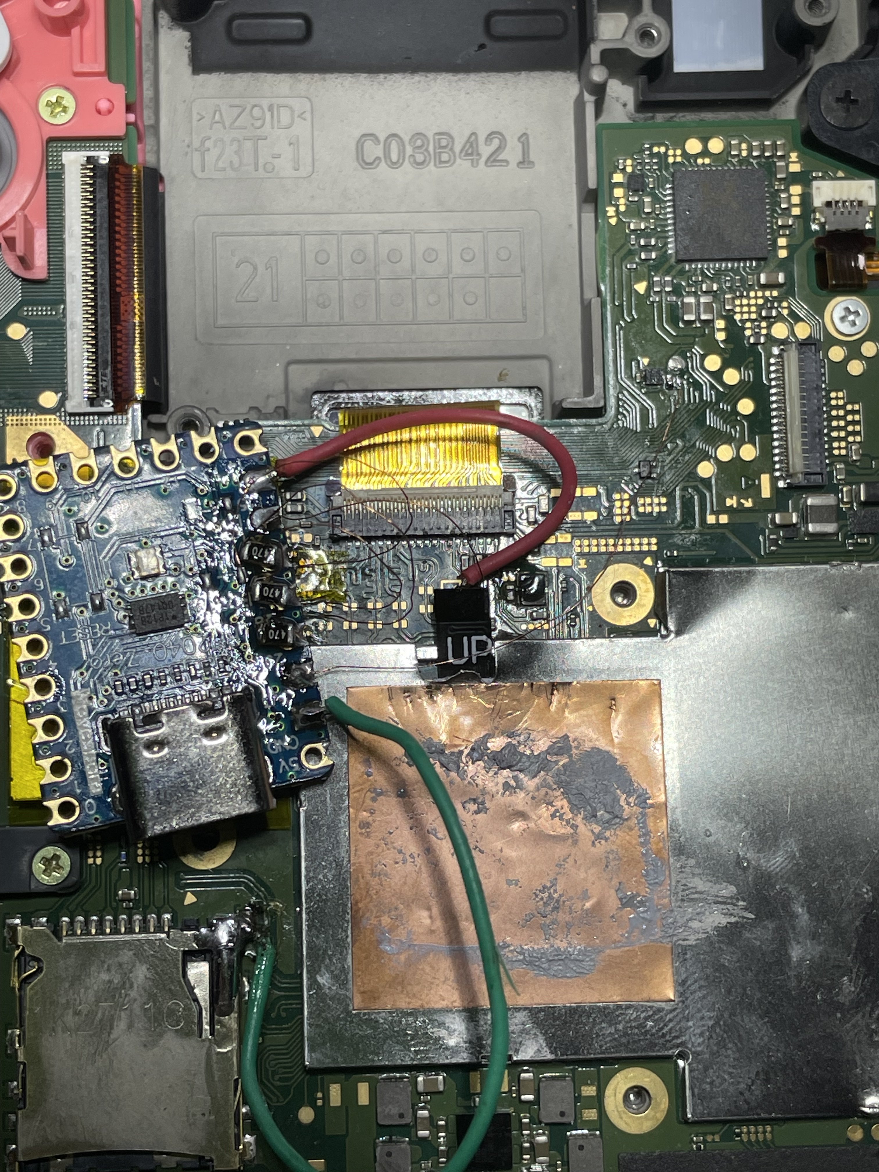

I also would say short.
Why are u using a thicker wire for the CPU pin?
Use 0.1mm like u used everywhere else
One other thing u should use flux cause ur solder point sure don't look like u are using it , and I'm not talking about the flux in the solder cause that's not worth shi..
