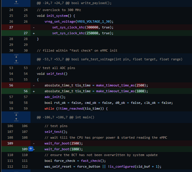

Yes, first custom firmware build, set oc to 250mhz, also change sleep wait to 1000ms. All in main.c file.

You also have to adjust
OFFSET_MIN / OFFSET_MAX accordingly when changing the main clock
Thanks.
But im sorry, let me understand that part first. hihi.
Can you help to explain on the logic in the code on how to find best offset/weight.
Just maybe the sporadic glitch time after training can be caused by cannot find the best offset record. Or is it just that every glitch is unique so every once in a while old offset cannot work again.
