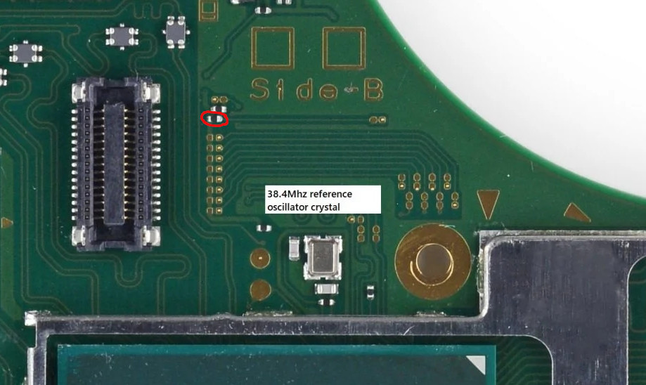

Hey guys can You tell My where the 4.7k cmd resistor is located on themariko v2 board
Do you mean this one? Since there are probably more
Yea purple screen . O install a poco everything ok . The other day i reboot the consol no hekake direct to ofw ando after a few atemps i got purple screen
the pic is from an oled board, but the resistor is in the same spot on the v2 board
edit: uh, no, it isn't, nevermind me
yea im traing to find it
i added a pic in my last post
thanks , lets pray . i dont understand everything was working just fine , i reboot the console and no hekake just ofw, i tried a few more times on and off , alwys ofw and then purpple screen
here some pics
