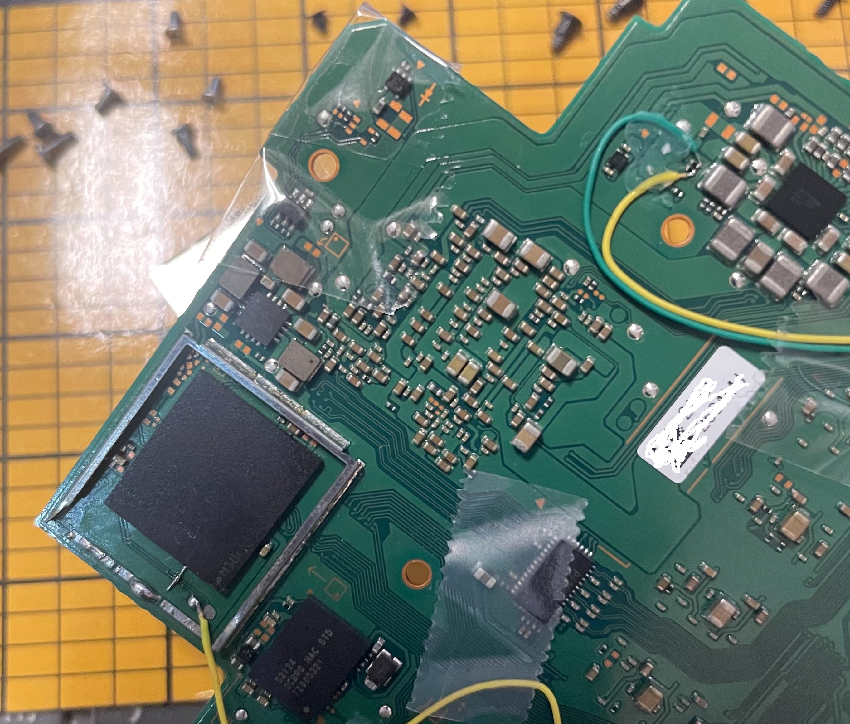

Can someone tell me which resistor and which side is actually the right place to solder the CPU signal wire in this photo? Because looking through this thread one person says its the middle one, this photo says its the top one, and another guy says its actually the bottom resistor. But no one gave any reason so I don't know who is right or if it even matters / why it matters.
Because they all same, middle resistor is 0 ohm, and top and bottom resistor all connect to the middle one

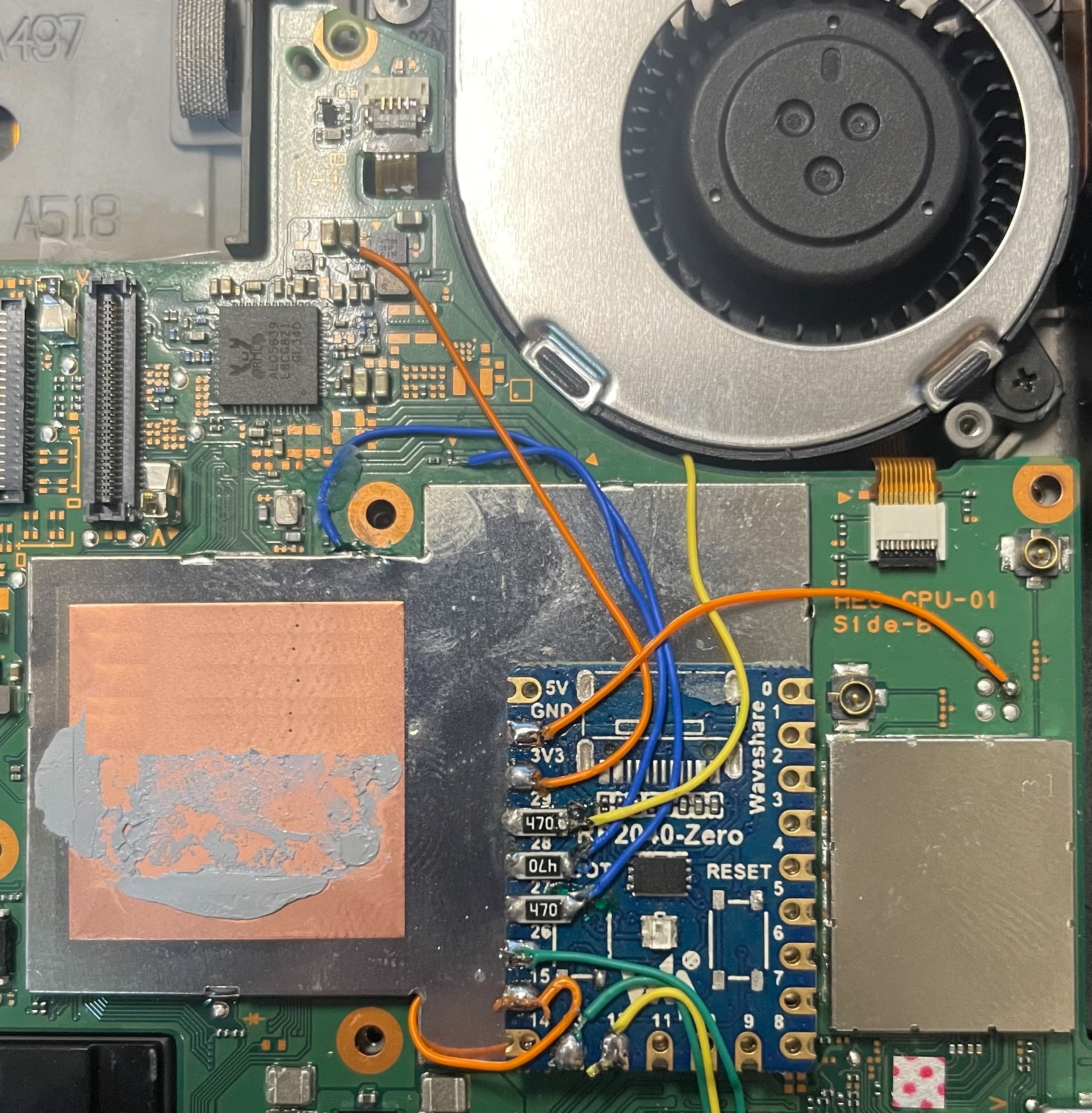

what version on the back of the rp2040-tiny from first video? what FW did you use?
I'm having my rp2040-tiny order on the way, will install on my fresh OLED and do a battery current-draw bootup chart when I have time.
In use, it is no different from ZERO
Currently configured OLED
Firmware :2.74 + I2C SDA=12, SCL=13
V2 or Lite configuration
Firmware: 2.74 without I2C link

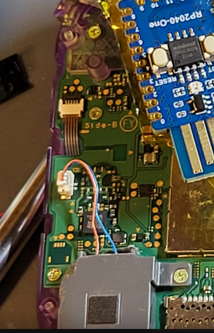

Has anyone found a way to fit the rp2040 zero into the lite without de-soldering the usb-c port or hacking up the metal heatspreader/shield? Ive heard of people leaving the buttons on, but as for the port, I haven't seen anything. Is it just impossible? Also. are there any locations people tend to place it?
My first lite I cut the acustic channel of the left speaker. The speaker works fine without it
