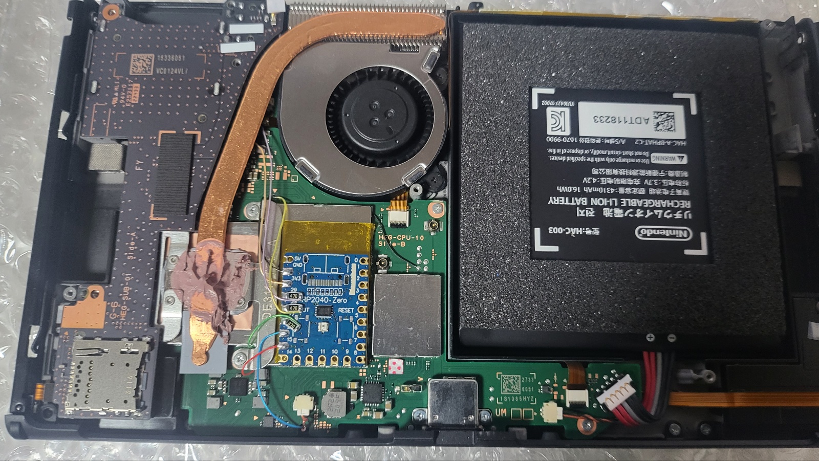

I mean it is touching yeah, but it is soldered at 4 points pushing against thre soldering ball... where the hell can it go, move or... fly? 🤣
sure it touching , like i said then dont solder to the board anymore just use wire and glue ;-) its the same B-)
  • Haha
Reactions: snaker
It wasn't touching the Dat1x, as close as it looks, but even so, I redid the solder point. I am sending another image to verify. I'm going to put here the multimeter values for each point.
1 Dat1: 524 ohms
2 Dat0: 524 ohms
3 Groud
4 Clk: 917 ohms
5 Vdd :780 ohms
6 CMD: 524 ohms
7 Dat3: 524 ohms
8 Dat2: 526 ohms
Just now, it worked, then it gave this error screen on the micro sd.
I also saw the amount of SDMMC1 errors.

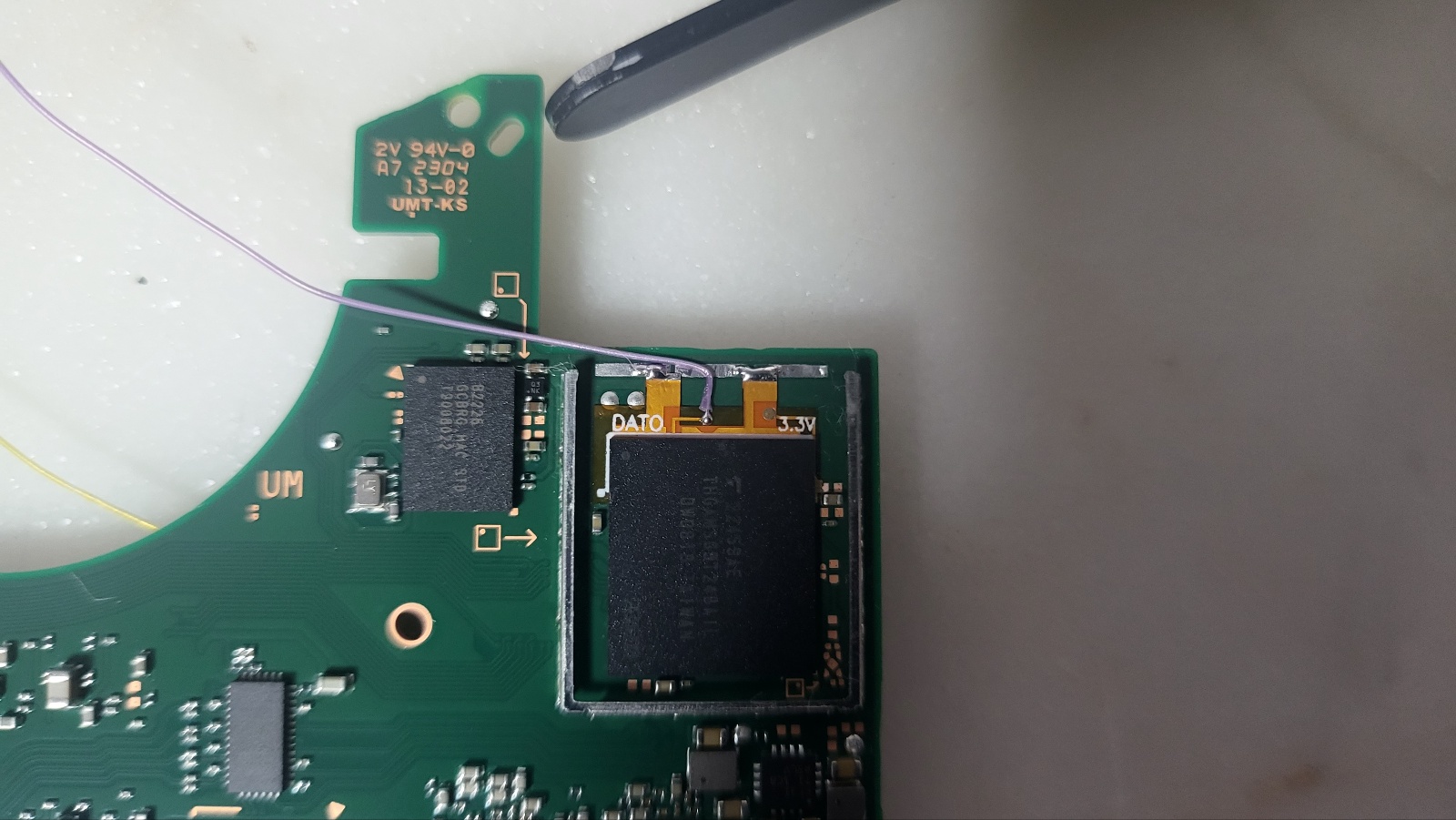

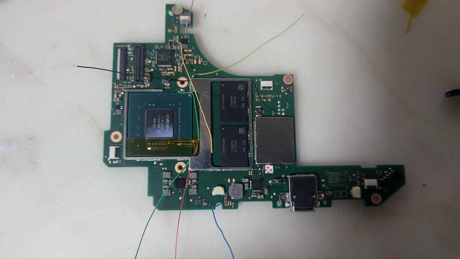

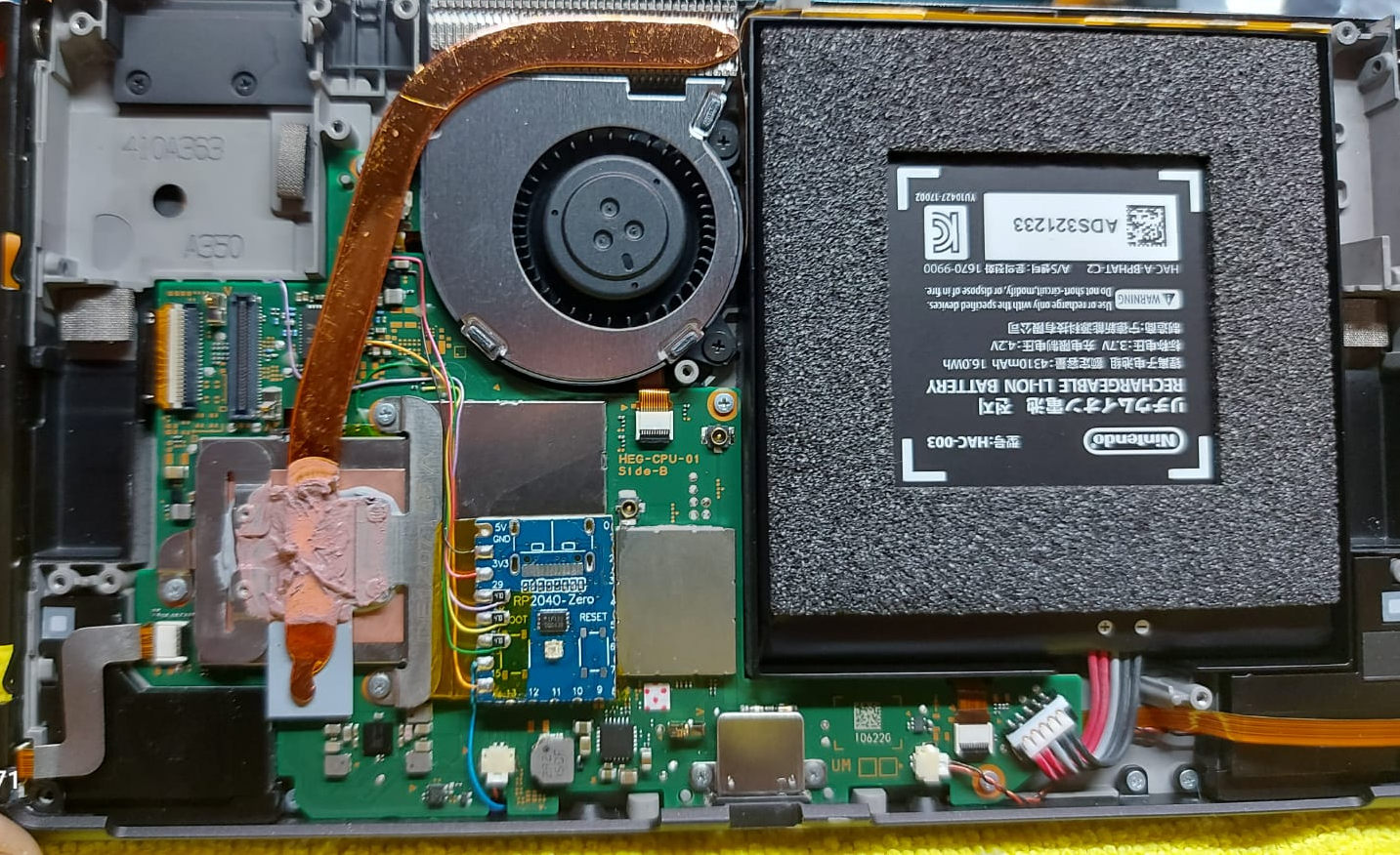

Updated from 2.73 to 2.74.
The led blinks *=* and the switch does not work.
NAND is Toshiba THGAMSG9T24BAIL and uses awg32.
Reinstalled by flashing the RP2040 to 2.73 and it worked fine.
How can I use 2.74?
