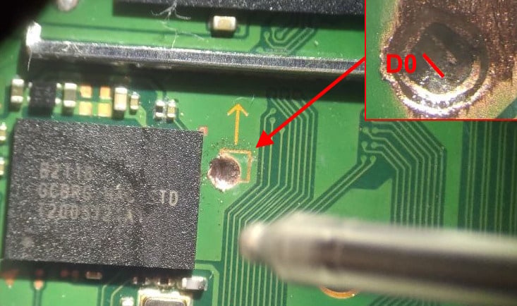

Is there no way to scratch the sealing off the dat0 line on the board to solder a wire to there?
naaa the ninjas did that on purpose
You can always try this, but it's alot of scratchin to do :)
really shouldnt take that risk then reball bevor that because if u mess this up u wont be able to fix it that easy
really should take that risk then reball bevor that because if u mess this up u wont be able to fix it that easy
Yeah, no way I'm doing this. It's just that seing this photo makes reballing look much easier.
