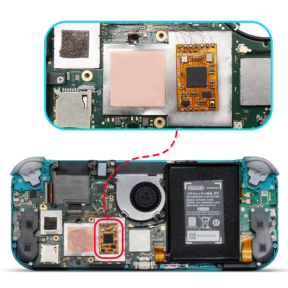

ISSUE: Sometimes my Lite doesn't enter RCM or even turn on when I press the power button. If I take off the back cover and shield and press power their is no light on the led to diagnose.
If I disconnect the power and then reconnect the power and press the power button, it goes blue-to-green and boots into hekate.
Does this sound like an issue with a connection or a short when closing the back shield? I have solder mask and kapton tape over every exposed connection.
Or is this a bootloader program issue? I'm on 2.65, I haven't tried updating or toolbox.
