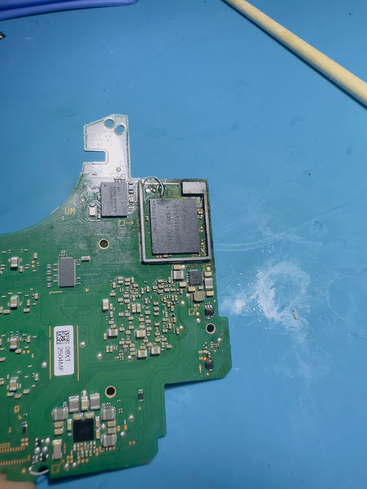

There is a problem with the installation and you can't enter hekate, isn't it? So it's an emmc hardware failure?
It is too hard to tell, it is probably your installation, check if you bridge any component, if you knock off any component etc. It can happens, someone recently bridged two components, and damaged his cmd resistor. The emmc thing is a common thing with SK Hynix emmc, but probably it is your install since you have Samsung.

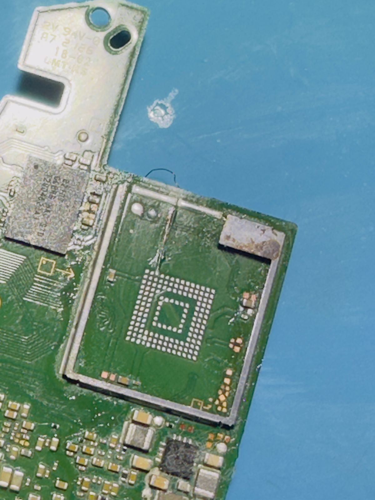

Sounds simple when you say it like that. I practiced on a PS4's Southbridge and to me the most difficult part is cleaning the area without breaking any pads.

Of course, it's easier for me to teach than do it myself 😅😅😅
To clean the area, add more lead based solder. It brings down the melting point of that sh*tty lead-free that they use to assemble the boards.
