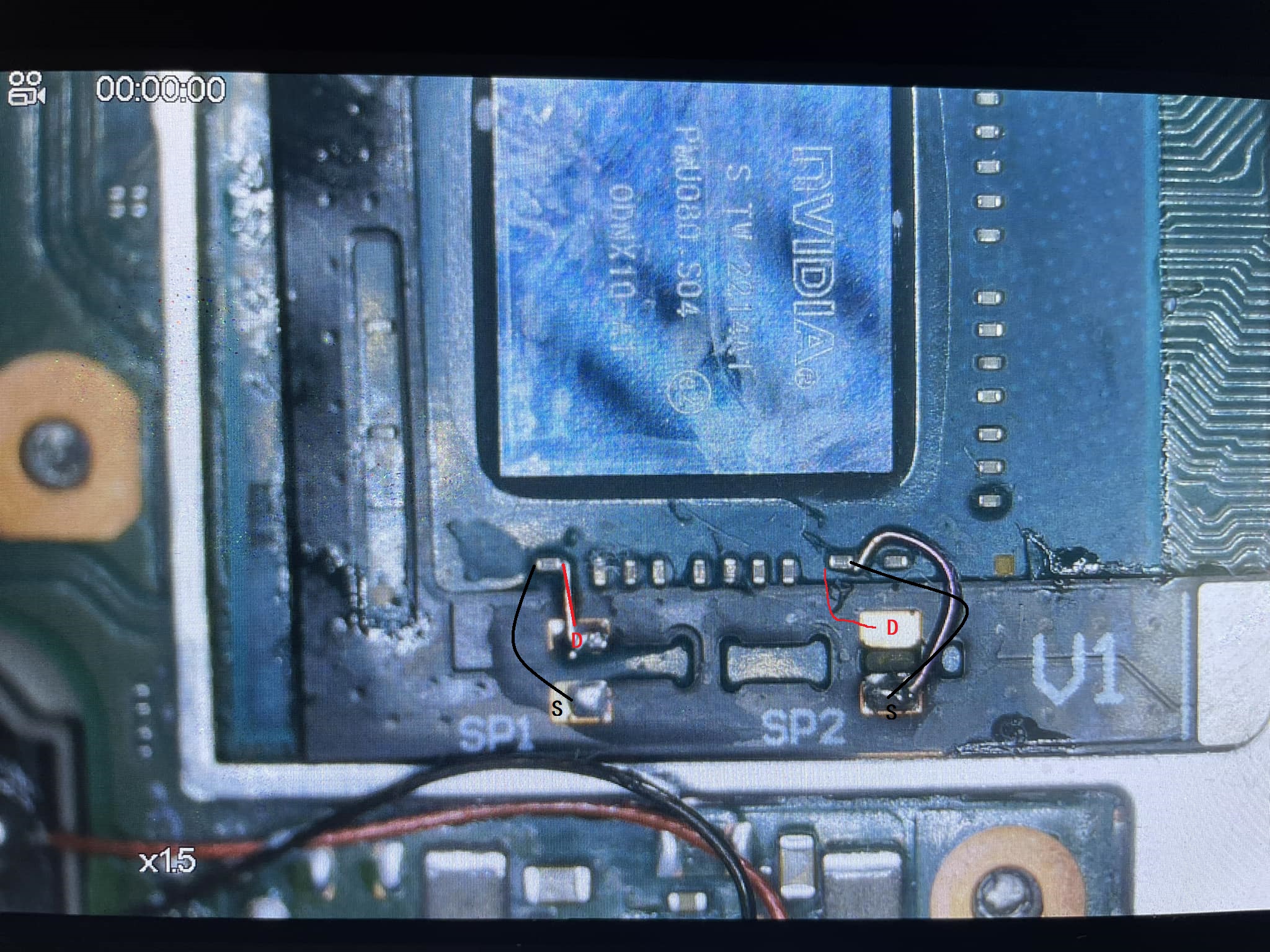

Hello, yesterday I asked about whether it was possible to use a v2 Flex in a v1, I saw this image on the internet of what I want to do but opposite, a v1 Flex in a V2 and I wanted to ask, how do you think I should do the installation ? the top side of the v1 smd on the right side of the Flex V2 and the bottom side of the v1 smd on the left side of the Flex v2? Or would I have to do it the other way around?
pay attention to the mosfet Drain, Source and Gate connectivity you should tell this is the way when v2 flex fits to v1 CPU

Where did you find this? I need to to this (V1 flex on a V2) but I’m not sure the diagram is right.
V1 on v2 is easier. This is all the info you need.
You only need to solder the G(ate) from the top of the flex cable (2 middle pins)
Dont forget to solder the anchor because those are the S(ource) point.
Good luck

Here's my photo of my mosfet installment which is using only one side of capacitor:
Everything ofc works.
I think just connecting any of black dots to mosfet's source and any of red dots to mosfet's drain is sufficient:

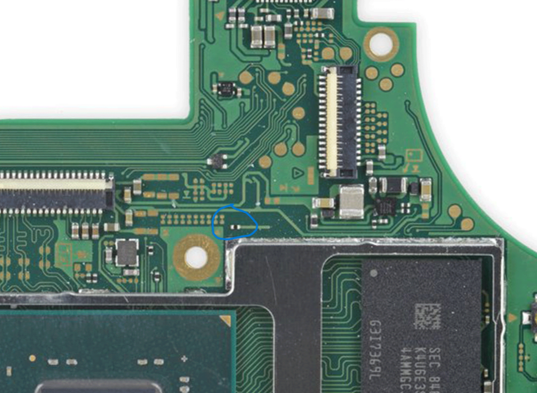

hi guys
while trying to use the CMD alternative point I damaged that resistance, could someone be so kind as to tell me what its value is
sorry for my english from google xD

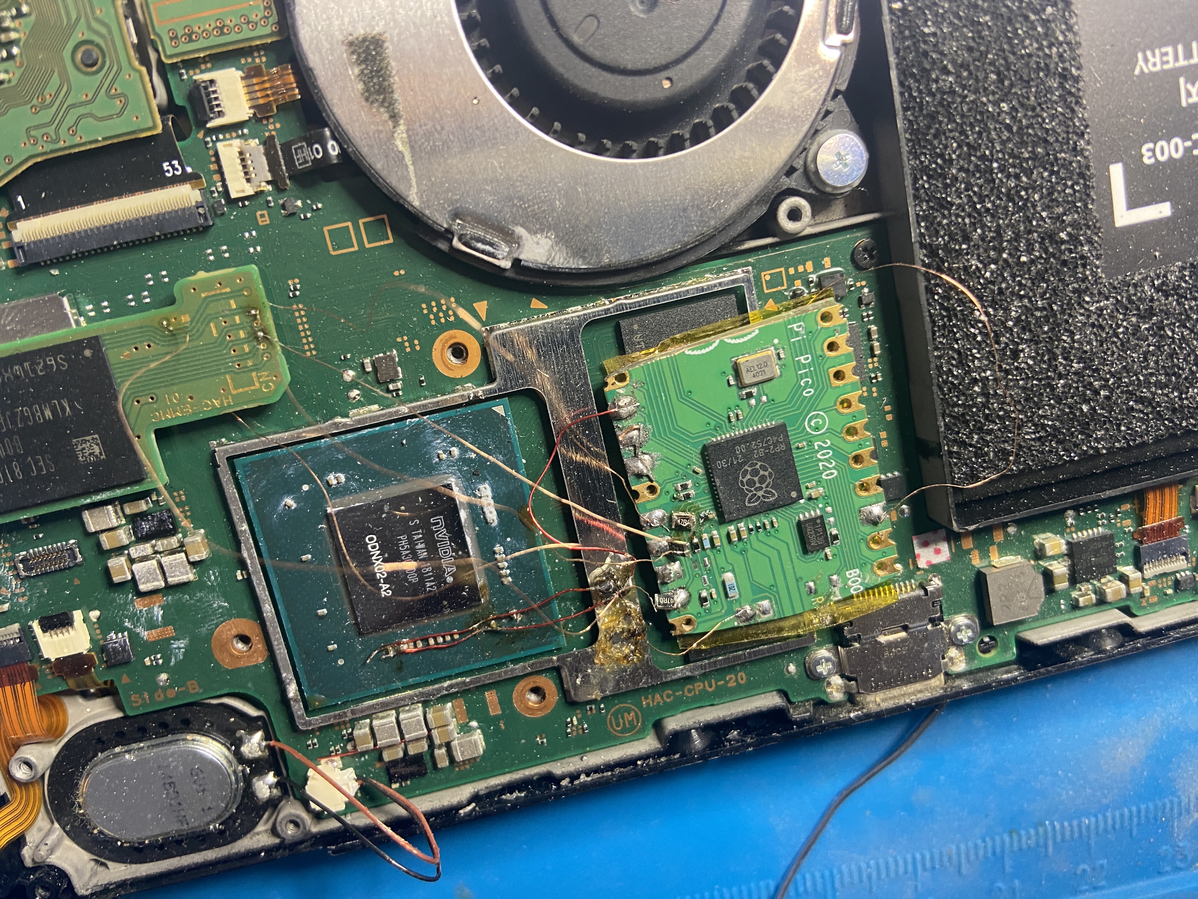

Reporting my RP pico successfully glitching after being cut as per @rehius and @Dee87's diagram.
Looks nice for a proof-of-concept. I came to notice that the Dat0 point on RP Pico is very fragile so I engraved a trace right next to the RP's chip, this made me keep the other side of pins that would have been otherwise cut, but I needed the ground on that side to not make it messy next to all the resistors, not to say it doesn't look messy anyways lol.
Thank you @rehius and @Dee87. You guys have been very helpful and responsive.
