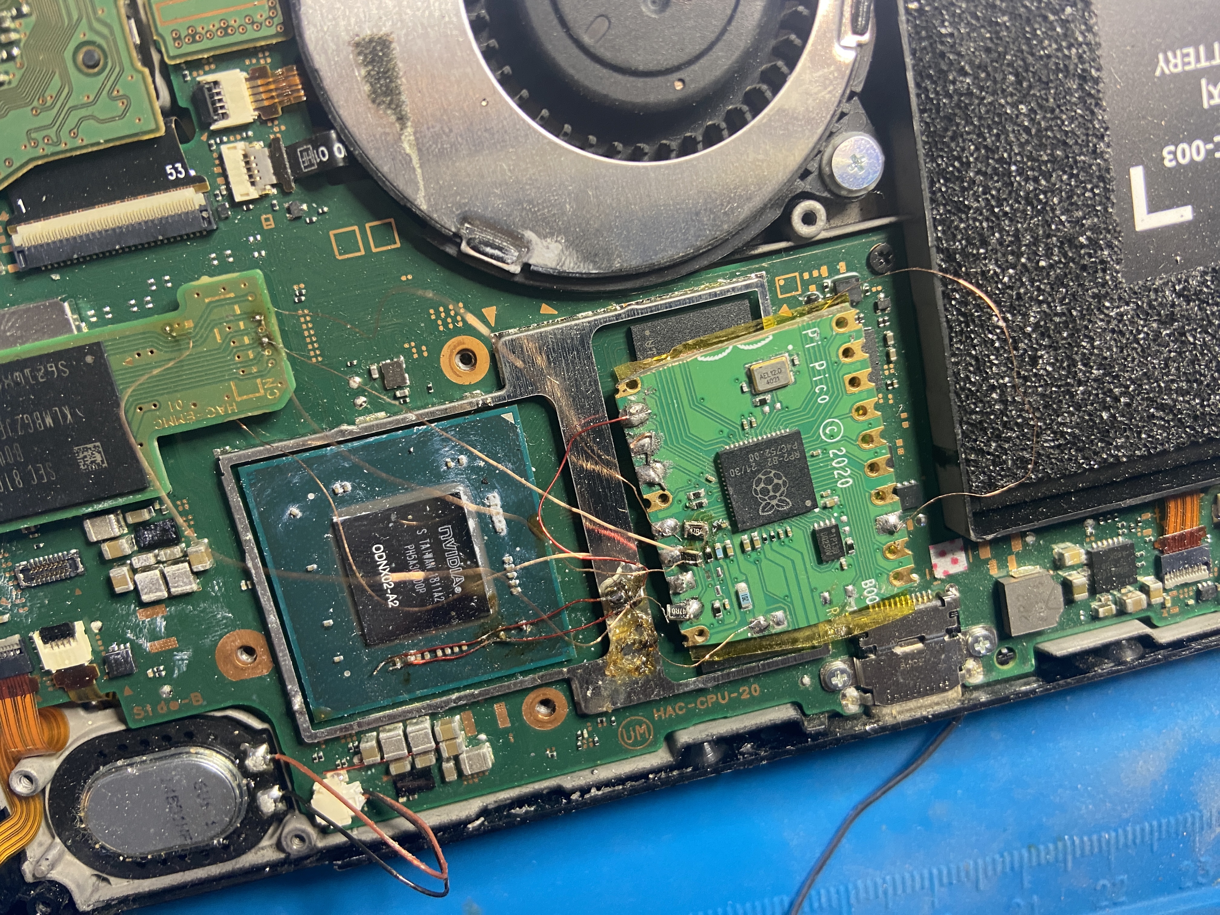

Reporting my RP pico successfully glitching after being cut as per @rehius and @Dee87's diagram.
Looks nice for a proof-of-concept. I came to notice that the Dat0 point on RP Pico is very fragile so I engraved a trace right next to the RP's chip, this made me keep the other side of pins that would have been otherwise cut, but I needed the ground on that side to not make it messy next to all the resistors, not to say it doesn't look messy anyways lol.
Thank you @rehius and @Dee87. You guys have been very helpful and responsive.

I finished my first install yesterday. I come from the Xbox360 JTAG / RGH community where I installed hundreds of modchips but WOW the Nintendo solder points are crazy small.
But everything went smooth during installation and the console boots really quick.
I have one problem that OFW does not boot. Nintendo logo and then black screen. Is there a fix for that?
I am using FW 2.66
