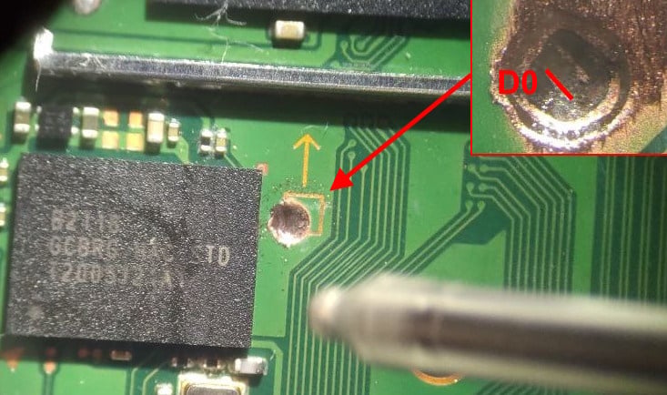

Soo are there alternative DAT0 point for soldering? I don't have the adapter for it. Everything else is soldered correctly, no problems
Yeah..... but I don't think you wanna go that way (see attached).
I would rather reball the bga than try this :D
if u removed the usb,voltage regulator , buttons there is no need for cutting the oled metal shielding , somehow nintendo startet making that particular place where the chips sit higher then on the v1/v2.
maydbe we have a switch modder in the design section of nintendo Xd
I meant plastic housing, I made the place where is usbc thinner, it closes, I don't need to cut it open
Then they are at war with whoever designed dat0
