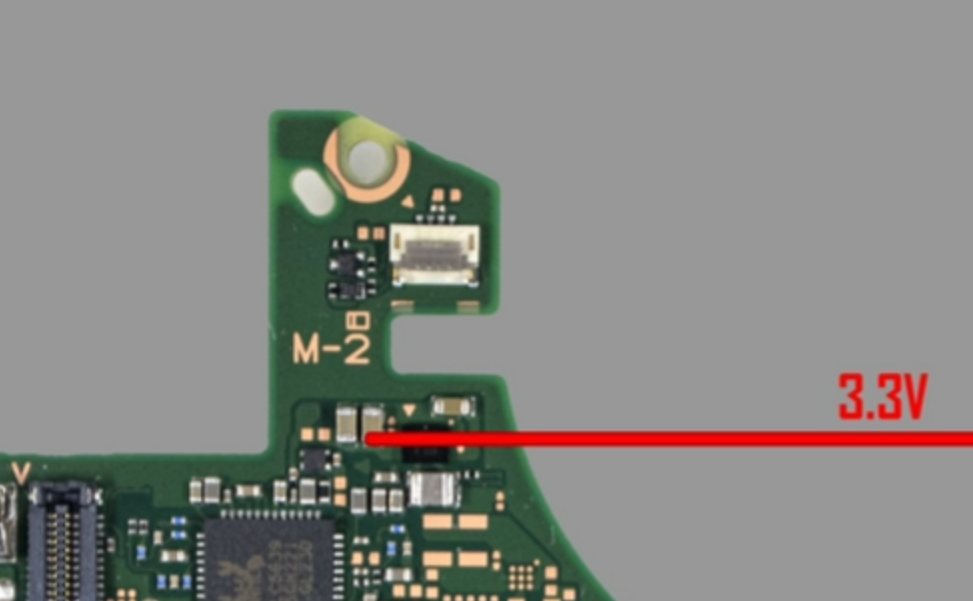

Hello @FreeLander, looks like you found the dangerous incorrect diagram by sthetix where the 3.3v point is actually direct 4.2v right from the battery. Be careful, such overvoltage may fry your RP Pico and the console. Please use the proper 3.3v point here:

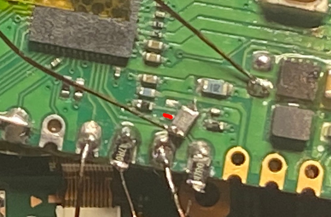

Hello. Thanks for getting back to me. Yes, I made the mistake of wiring the 3.3v to the cap shown in red, then changed it to the correct one you pointed out. I'm still getting a single green led then nothing. Console is still booting normally without the modchip, thankfully. Here's my soldering. Would love to hear if you spot something wrong
latest firmware is 2.65
Yes, sorry. 2.65 downloaded directly from Github

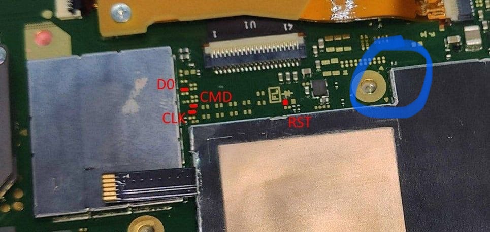

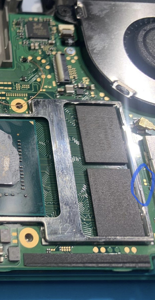

Is it ok or any effect if I solder the CMD point to the left side of this resistor and the 3.3V point as shown on switch lite?

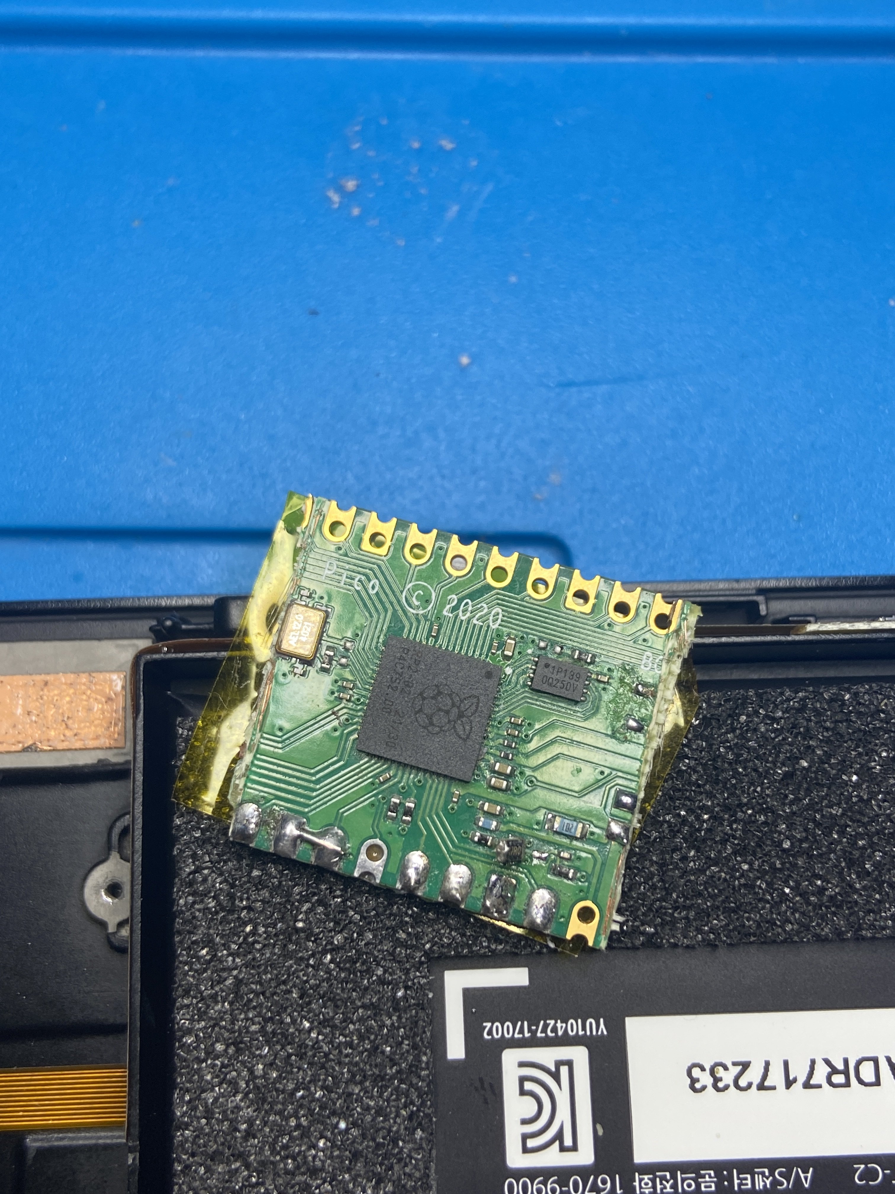

RP PICO is such a headache. It worked fine but when I cut it, it no longer boots.
Stick with rp2040, people.
