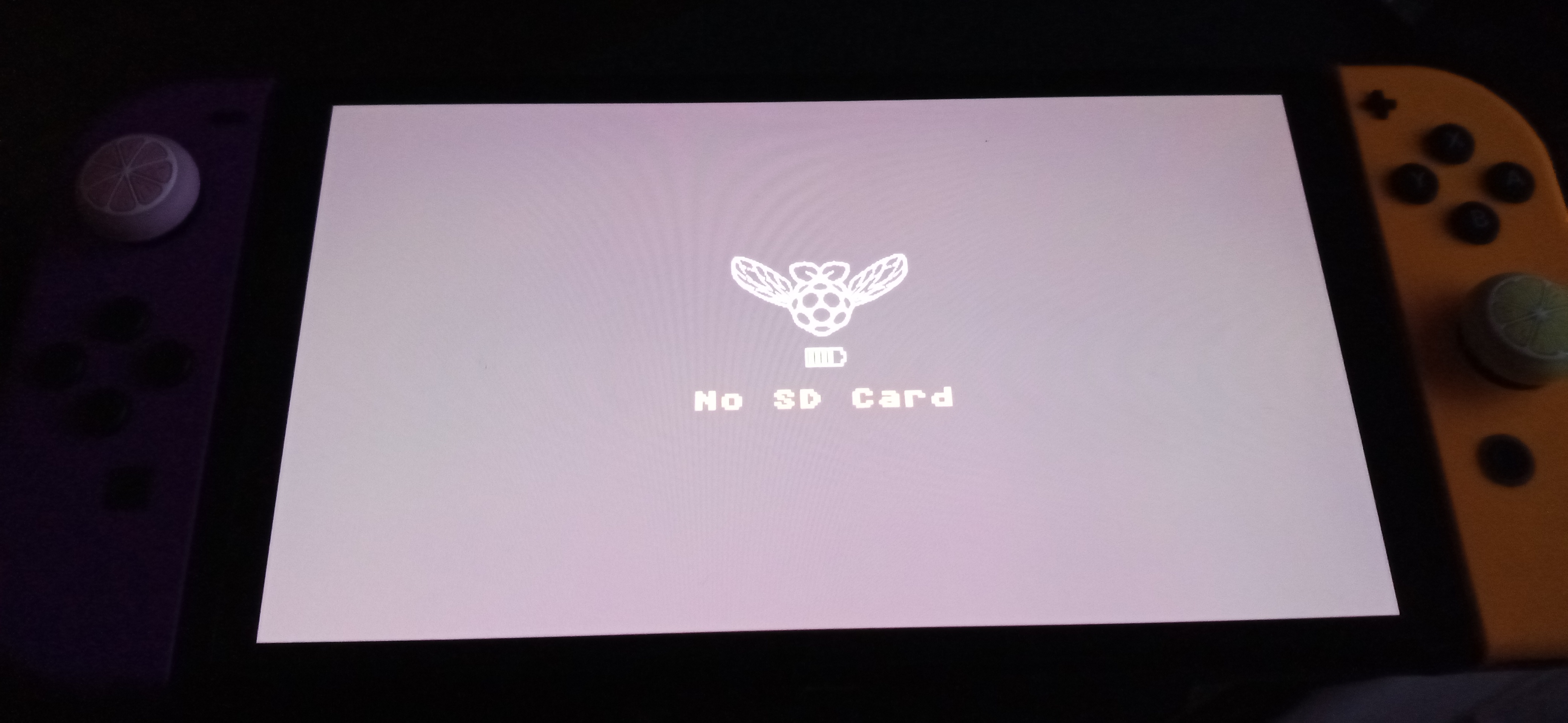

This is the result of my resolder job. Now I’m getting blue purple
I dont think the 470R ohm resistor gonna work, if you were still using what you bought. You need 47R or 470 label on the resistor
So I need to buy another resistor? Thought these were the right

No, from your purchase link you could tell they are selling 470 ohm not 47 ohm.
And since you are having blue led blinking mostly meaning glitch start but since resistor not right, timing is not good for the rp2040.
Good side is you have a SAMSAUNG eMMC, you should be very close to success.

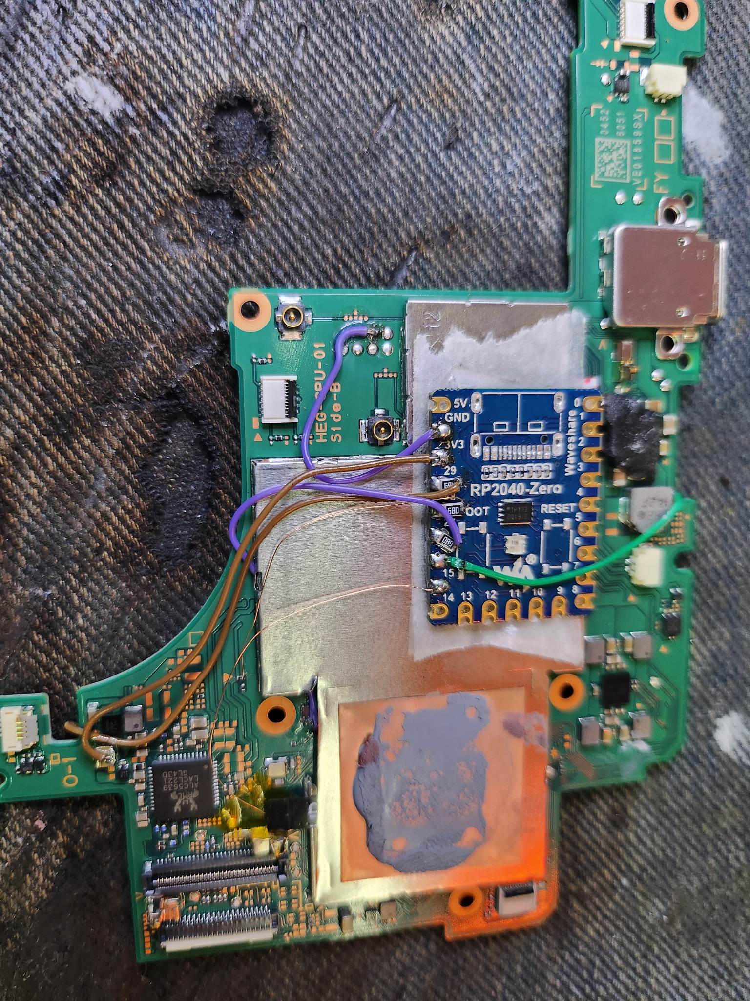

Greetings, this is my oled.
Is there a diagram for v2 flex uses on Erista patched?
I only have v2 flex and one Erista patched
Thanks for your help

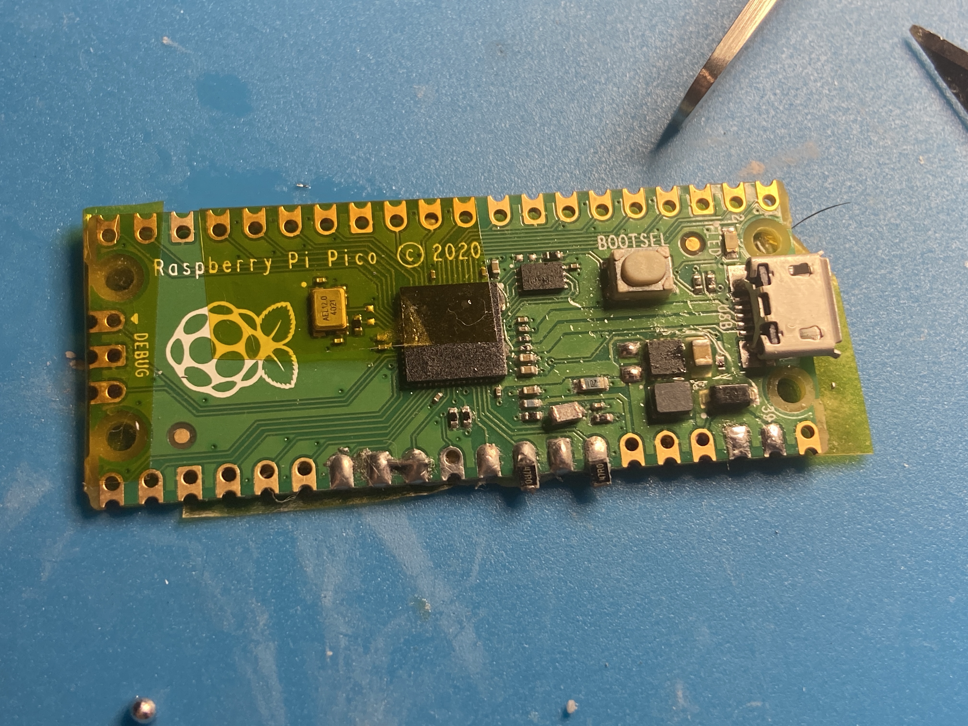

Hello. Has anyone got the RP PICO to work on OLED? I installed it and checked all points. The moment I plug in the battery it goes green for a second then off (without even turning the switch on). then Black screen.
it boots to OFW if I removed it. Here's how I modified It, please tell me if you see something wrong.

I tried RP PICO on two OLEDs, no luck. It goes green then off with a black screen. The OLED boots to OFW if I remove the PICO.
Please advise.

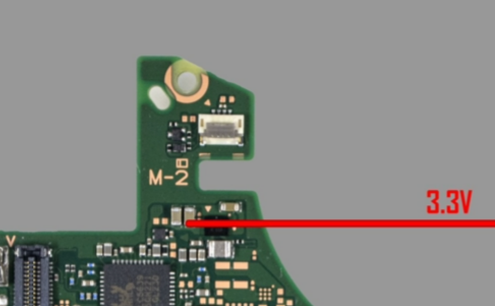

Hello @FreeLander, looks like you found the dangerous incorrect diagram by sthetix where the 3.3v point is actually direct 4.2v right from the battery. Be careful, such overvoltage may fry your RP Pico and the console. Please use the proper 3.3v point here:
