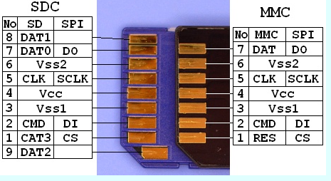

On a side note, I read a bit of the MMC standard documentation and it looks relatively easy to understand. As I can't find MMC cards on Amazon (only SD cards) and SD cards are basically successors to MMC cards, does anybody know if I can read SD cards in some sort of "MMC mode"?
E.g. can I just connect only DAT0 (MMC cards only have one DAT line), Vss2, CLK, Vcc, Vss1, CMD and CAT3 and talk to the SDC with MMC commands?
yeah, is called 1 bit mode.

I actually wanted to test MMC communication with regular SD/MMC cards so that I don't accidentally bust my Switch eMMC lmao
