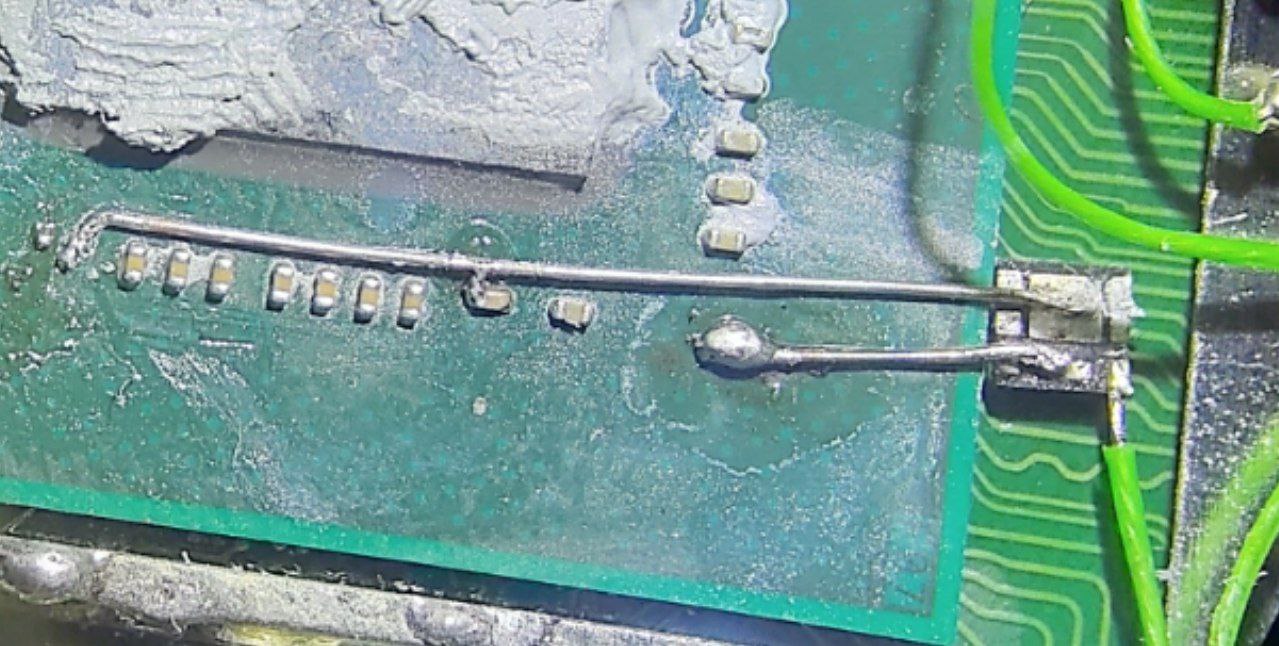

I would suggest to add a few moments:
- RST point is extremely sensitive. Even a tiny amount of flux may cause problems like instant reboot after startup, so it is highly recommended to clean the board after soldering
- "Slow eMMC mode" as Hekate says, may also be caused by flux, too thin, or too long eMMC wires (CLK, CMD, D0). In some cases double resistors (47+47 = 94 Ohm) on the CMD & D0 lines may help.
- A diagram with single mosfet which is properly connected to both VCC points should be pretty enough, the 0.2mm diameter enameled wire is recommended.
I know for sure this soldering sucks, the capacitor is lost, but you can do better!

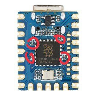

- the APU soldering is complicated, and some people may break, or lose capacitors there, in this case, it is possible to replace them with the ones from the pico board!
actually there are more 100nF caps, but I'm too lazy to ensure which are the required ones

Well said Rehius, your RP2040-zero capacitor theft trick is what saved my wireless function. I will modify and whip out a rev .2 of the PDF here shortly

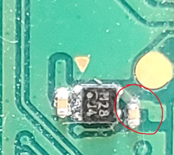

It was my first trying in modding chip. I learn soldering by myself one week ago.
The job was right, I reach the no sd screen. But when I tried to mount and close the switch, the 3.3 cable was desoldered.
When I tried to solder It again, accidentally I ripped the 3.3 capacitor. So no power on no more.

Seems like you use a bigger cable. So when the cable got force, the force is forwarded to the pad, and will ripped it up. Use a very thin cable, its super cheap only $0.15 for like 15meter. So when the thin cable got force, the force will ripped the cable itself rather than the pad.

But the Switch doesn't power on because there's no capacitor on 3.3v point. And I haven't got any capacitor to replace the lost one. I used 30awg in all points.
I did it thinking Lite will dead so not worries at all. I will find somebody with professional tools and skills to repair it.

Usually those kind of cap used only for smoothing voltage, without it should be running fine.
I use 0,1 mm or in american standard it is like 38awg cables for the 3.3v. It seems its enough, everything running fine.
Possibly I'm wrong, but I think it's 100% sure that it doesn't turn on since that capacitor is missing.
I have tried to turn it on several times and it does not respond.
A few moments before when it was, if it started and without problems.
