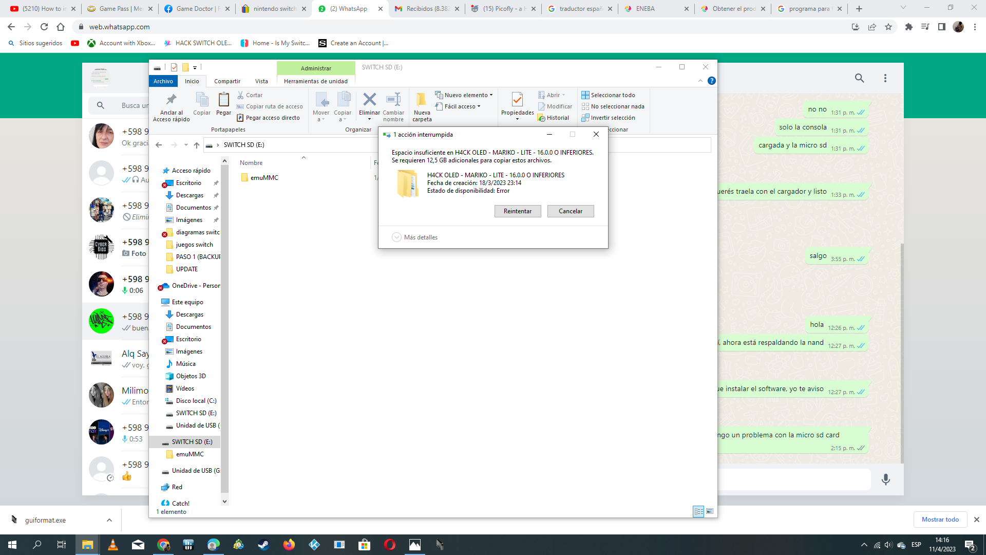

Hello, I created a 12 gb emmc partition on a 128 gb micro sd, and when I try to install some files on it, I get that sign, does anyone know what I should do?
first its not english and this is english forum .
second what files u want to put where?

my pc is in Spanish, I want to put the atmosph, but I don't know if it can be mentioned here, the problem is that when I create emmc in the console, then when I connect my micro sd the emmc partition appears plus the other one that is in fat32 but windows says it needs to be formatted
well we cant help u in spanish maybe some can but this is a english forum so tell us what the issue says maybe we can help then
doesnt matter what what windows says u need fat 32 for switch
u made a partition base emmc i guess ?
u need to drop those files in the fat 32 partition where hekate is i would say

Why Windows ask you to format is most likely it say something is faulty on it. Just do a chkdsk so it gets happy.
