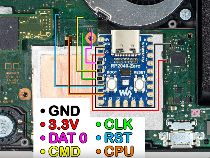

Hello! Currently having this issue:
Pkg1 decryption failed!
BEK is missing!
Failed to launch HOS!
Is this an issue with the chip installation or sd files? How do I fix it?

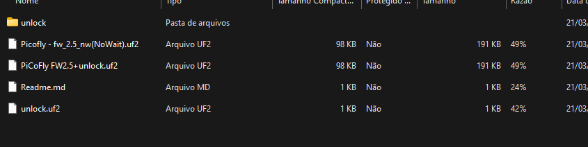

So, which one of these should I flash? Is it just one or more than one? Sorry for the stupid questions
flash 2.5_nw unplug raspi and then unlock
if that works flash 2.61
some people had some issues with just flashing 2.61

Whenever I add something to the RP2040, the computer stops recognizing it. How can I flash the 2.5 and then unlock?
That is normal behavior
Push boot button plug rp in
Flash 2.5nw
Redo above and flash unlock
After each flash u should get a red led light if its green u need to set rgb mode

Should the 2.5nw file stay inside after plugging the usb for the first time? I added the 2.5nw and then did as you said but there were only the index and info files. Is it also normal behavior?

Yes, that is normal behavior, after you flash it the window will disappear and you will never see the file there.
