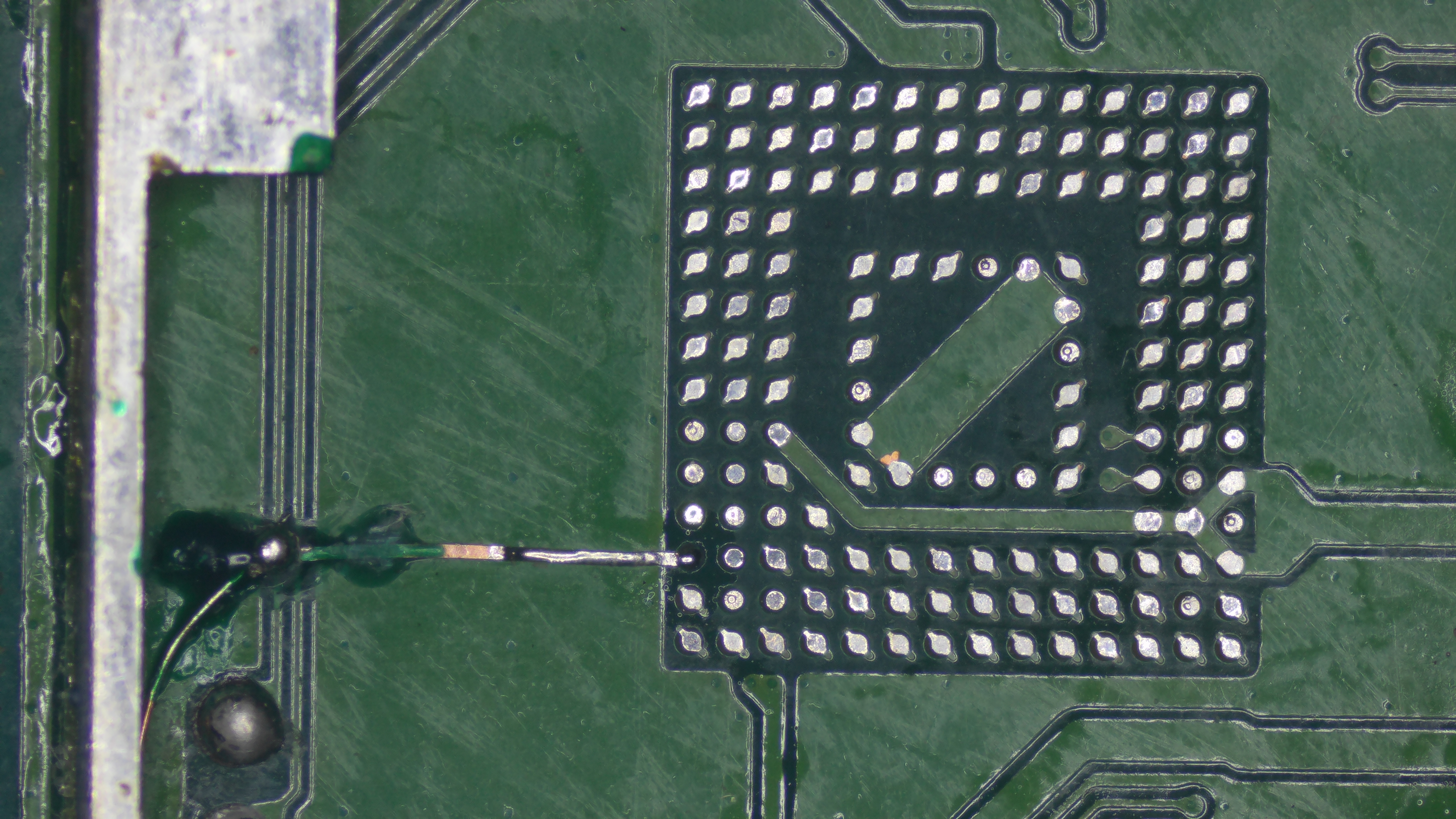

Well guys
i set the permanant dat0 yesterday night

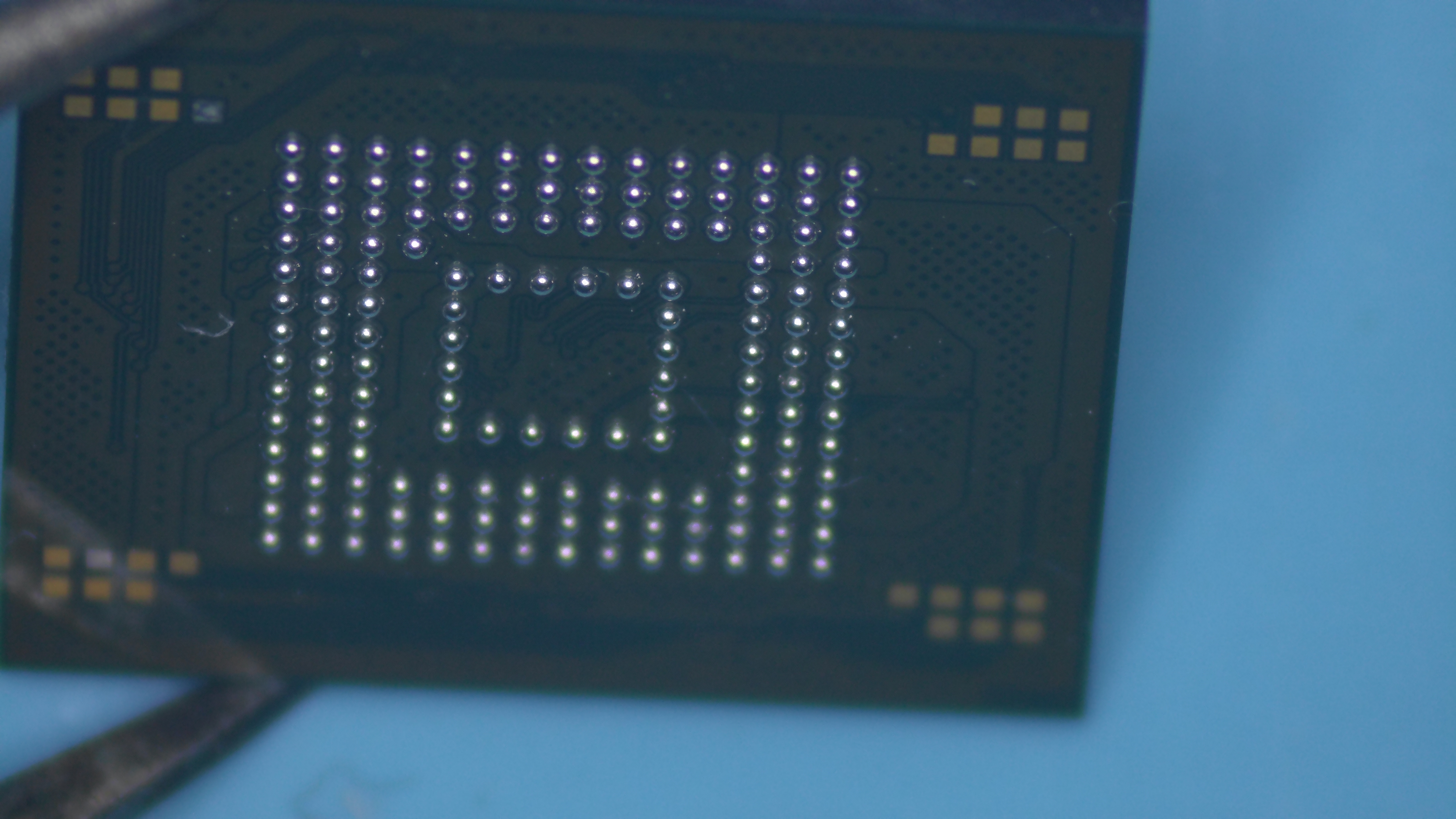

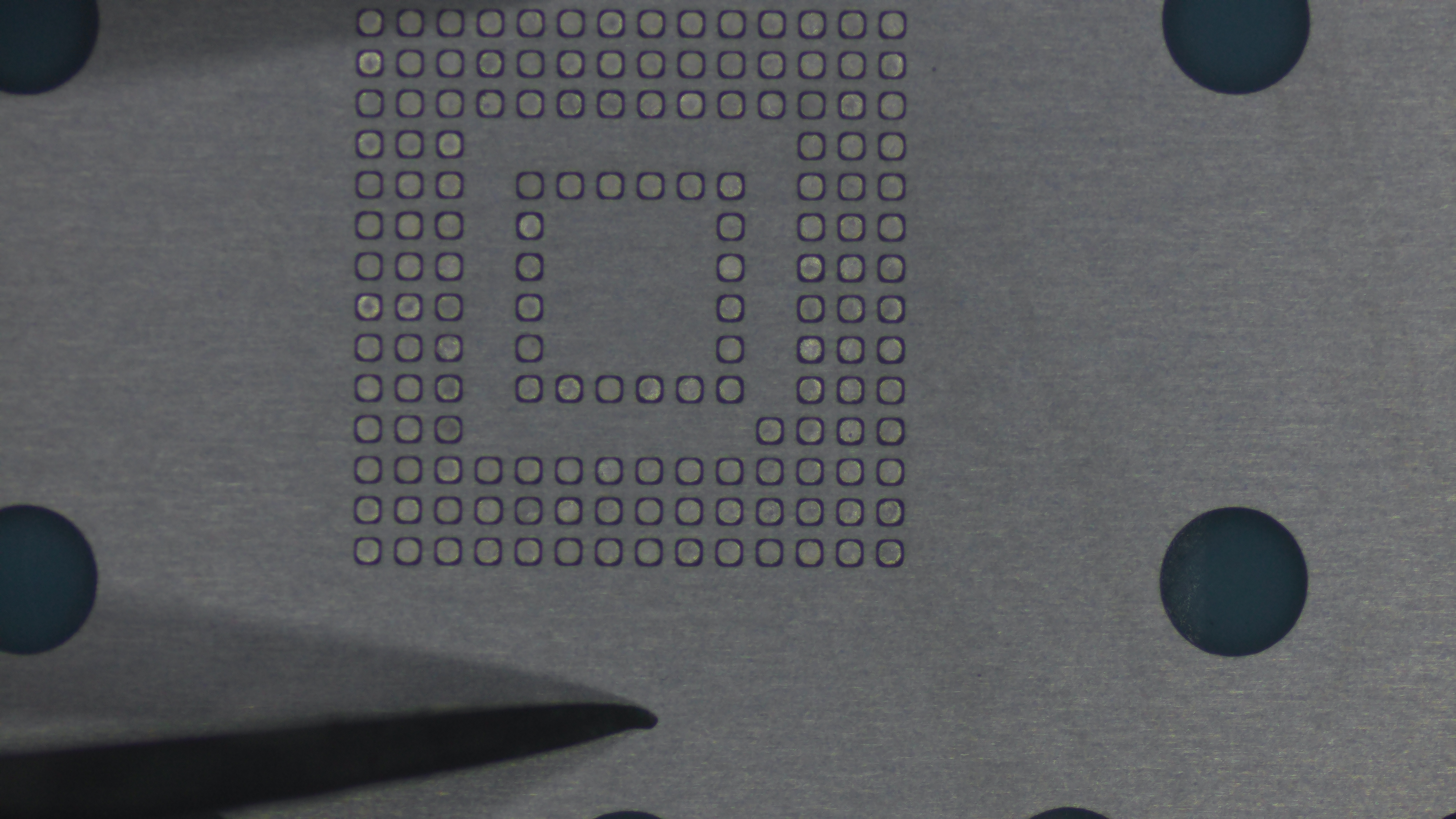

after i woke up and got a coffe i decided to reball the oled emmc

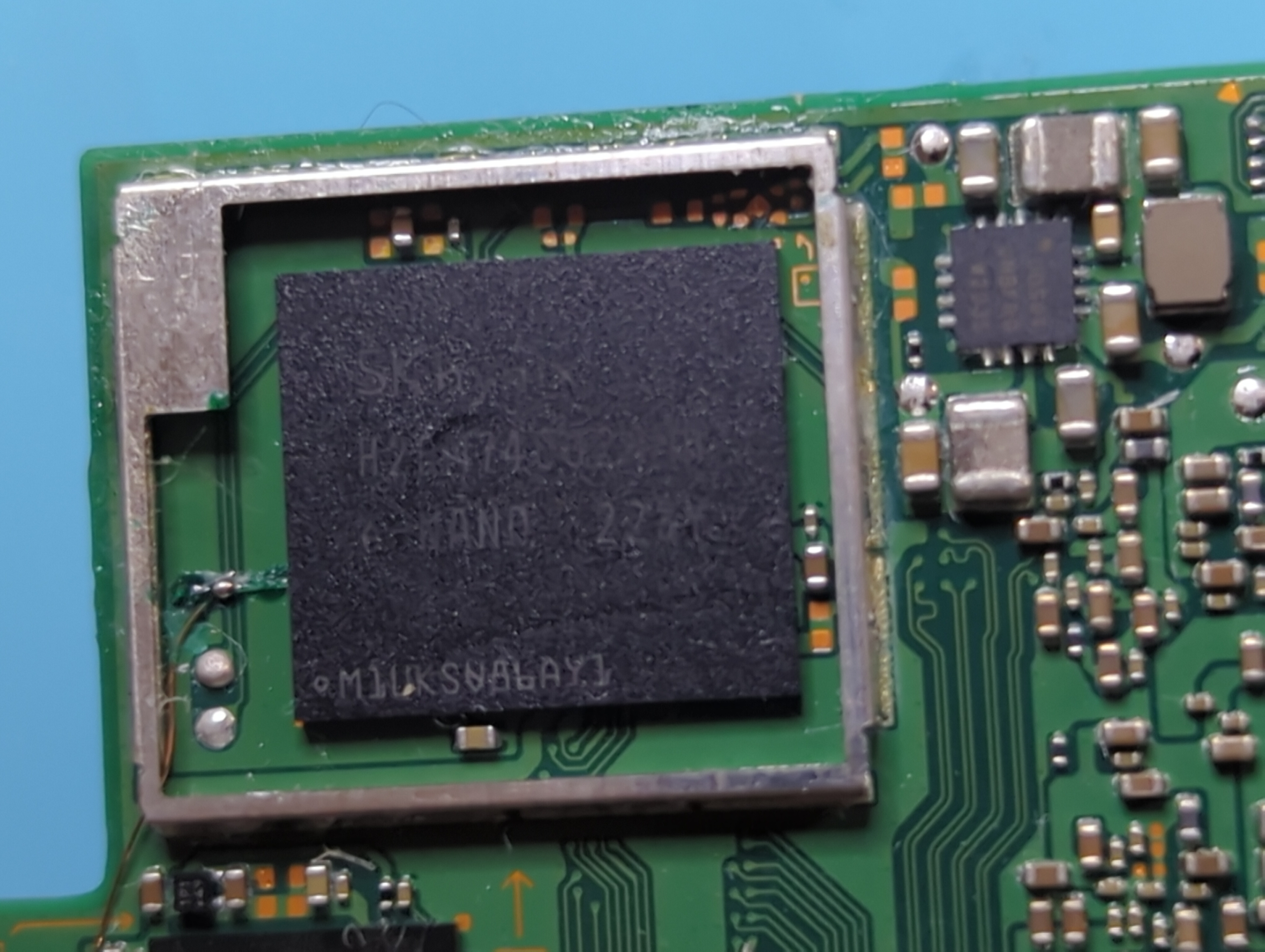

then it came to the part where i was a little bit afraid of :-( reflowing the emmc
well after i but everything back together it i had to take the chance and guess what
everything worked out fine
right now im making a buckup of everything :-)
thanks for the tipps with the reballing :-)

Well guys

Great work!
I'm having the idea to try to reball the eMMC as well, didn't get the courage yet :P
Did you have trouble while detaching the chip from the stencil after reflowing the solder paste? And what were the temperatures used in all the steps?
Thanks!

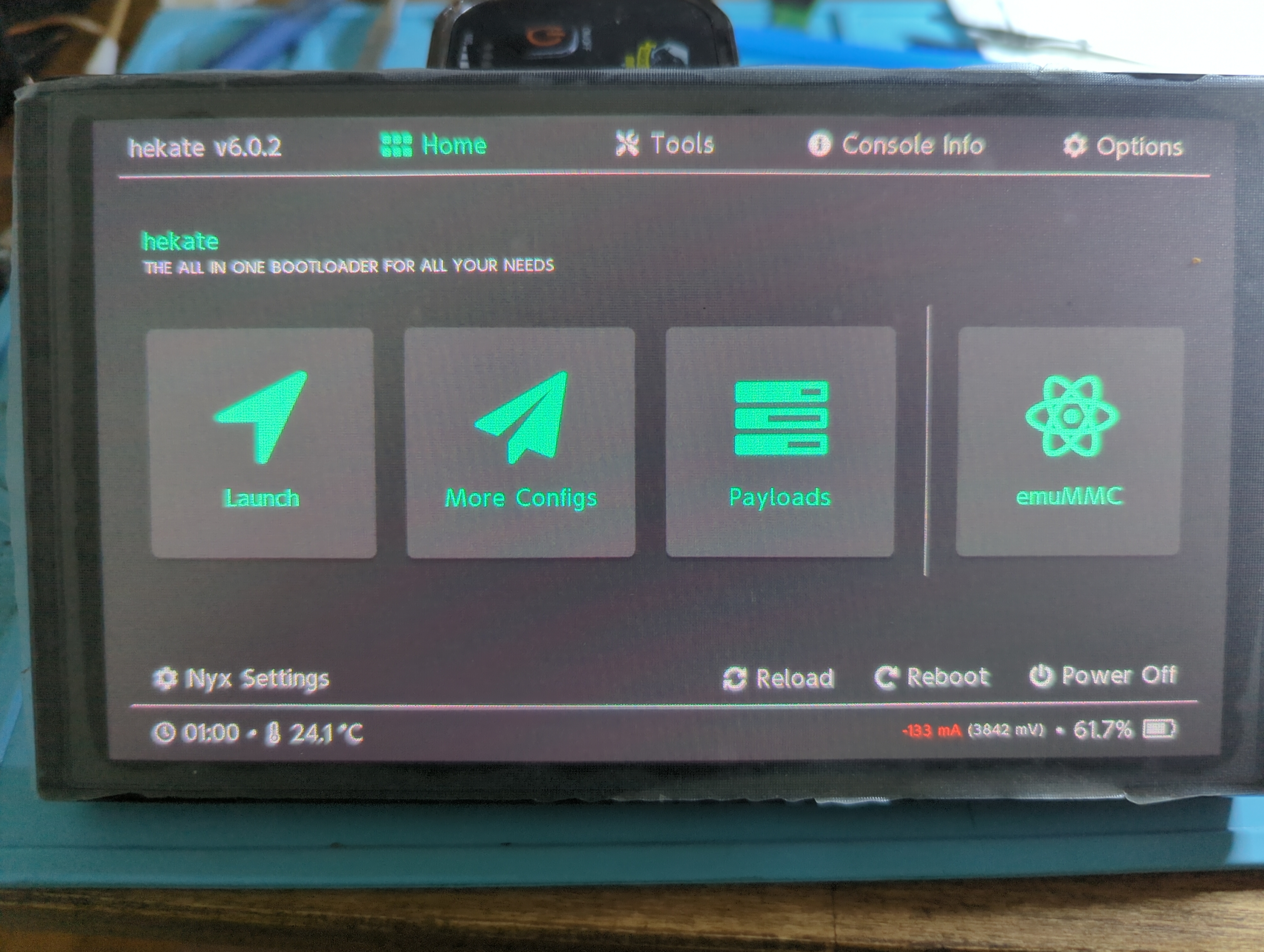

just a quick FYI here, I had my rp2040-ONE successful boots to new logo V2.6 bl and I switched back to rp2040-zero which was on v2.5, BUT when It boots, the zero board also shows me v2.6 new logo surprisingly. I then bridge PIN0 & PIN1 reset zero board and it rolls back to v2.5 "NO SD" screen as promised.
Wondering if v2.6 somehow remains on sysnand at temp or not
