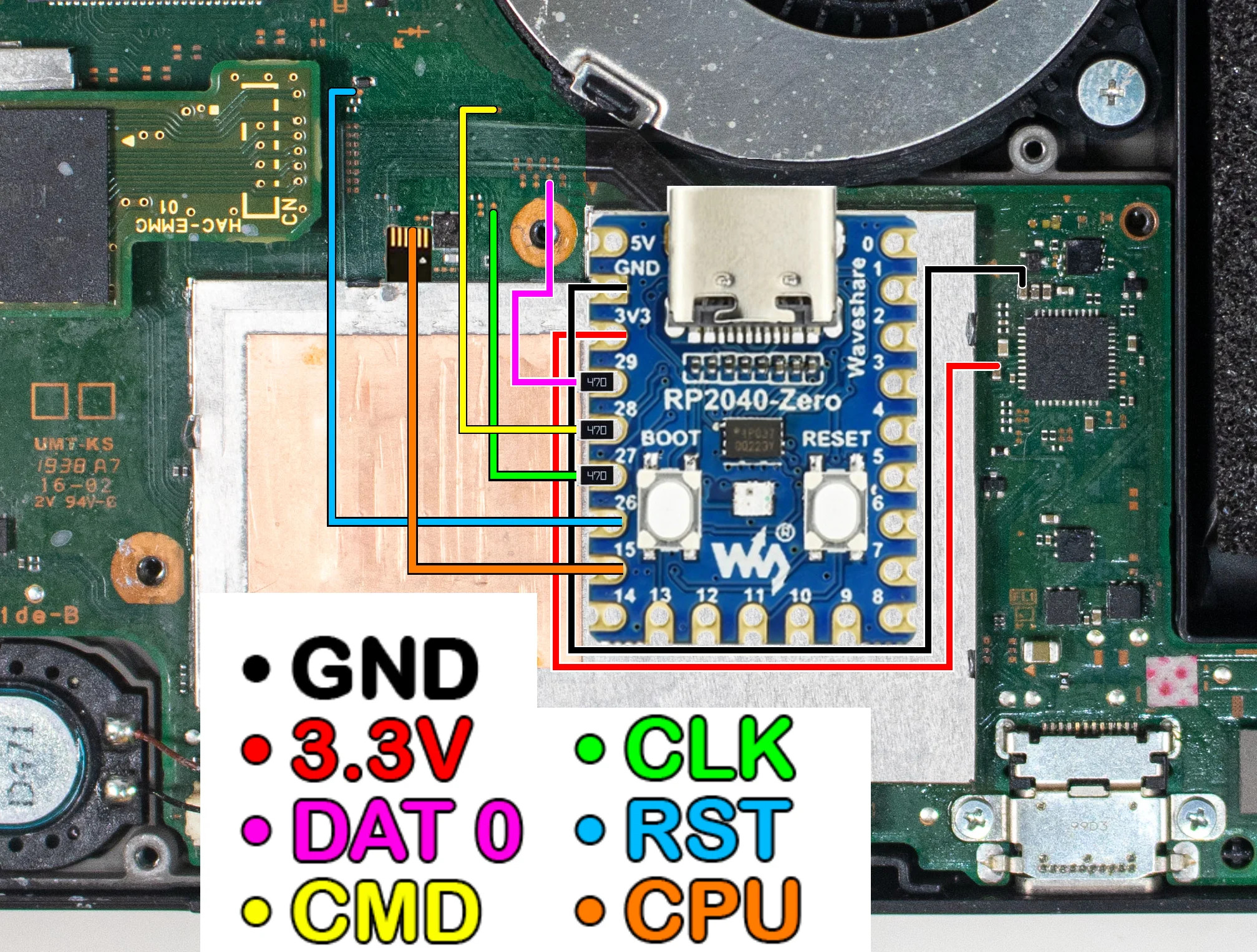

Anyone know an alternate RST point on an Erista? Not on the EMMC board, but somewhere else? The RST point on my EMMC came off.
The blue line leads to a tiny pad near the EMMC, but not on it, so you should be able to hit that one.
Thanks I found the point, as far as I can tell, the little black component on your photo isn't on my board though. Is that any issue?
edit: tried it, still won't show me the chip's boot screen again. Possibly I have another wire that's an issue though. It's just booting straight into OFW.
edit: I'm getting yellow LED and then it goes to OFW. I checked my D0 point it is good on both ends. Not sure what's going on.
edit: RST came off, so.. it's real difficult to hit that point its very small. so I think I'll shelve this til tomorrow. Since I have SP1 and SP2 perfectly soldered, I might just buy a different modchip altogether because this one pretty much gave up on me hehe

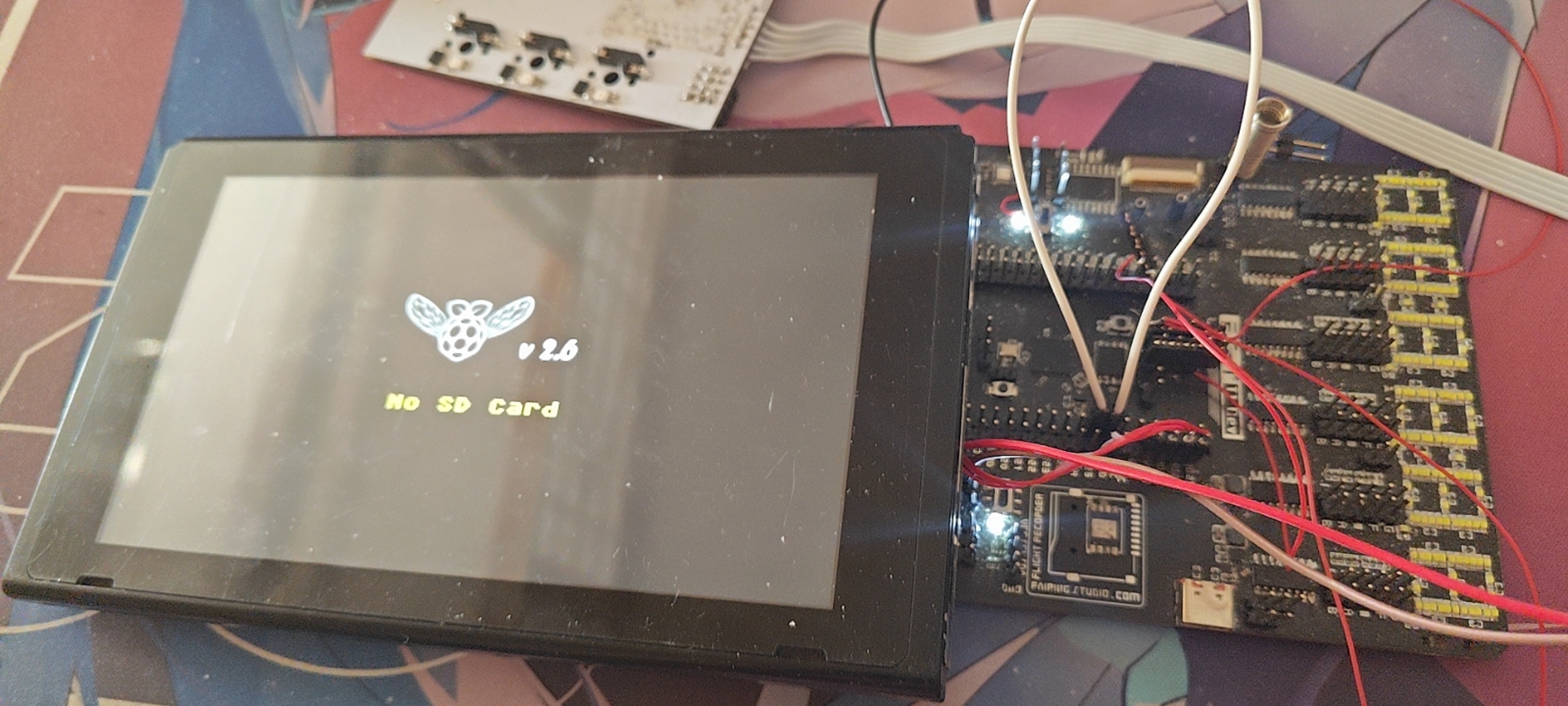

Thanks for this my picofly on switch lite works..with fw2.5+unlock my issue is when I power on my switch the light is cyan and boot to ofw..but when I press the reset when switch logo it glitch to green light and boot to hekate.but when I flash this 2.6 it glitch to green no more click in reset and succesfully boot to hekate.i use 2 mosfet.by the way my RP2040 is like this and the version I see inside when I flash is v3.0. so 2.6 is the firmware compatible.the 2.5 seems have a bug to this R2040 v3.0

Seems to work like a charm. Trained for 3 seconds the first time, then instantly glitches since.
