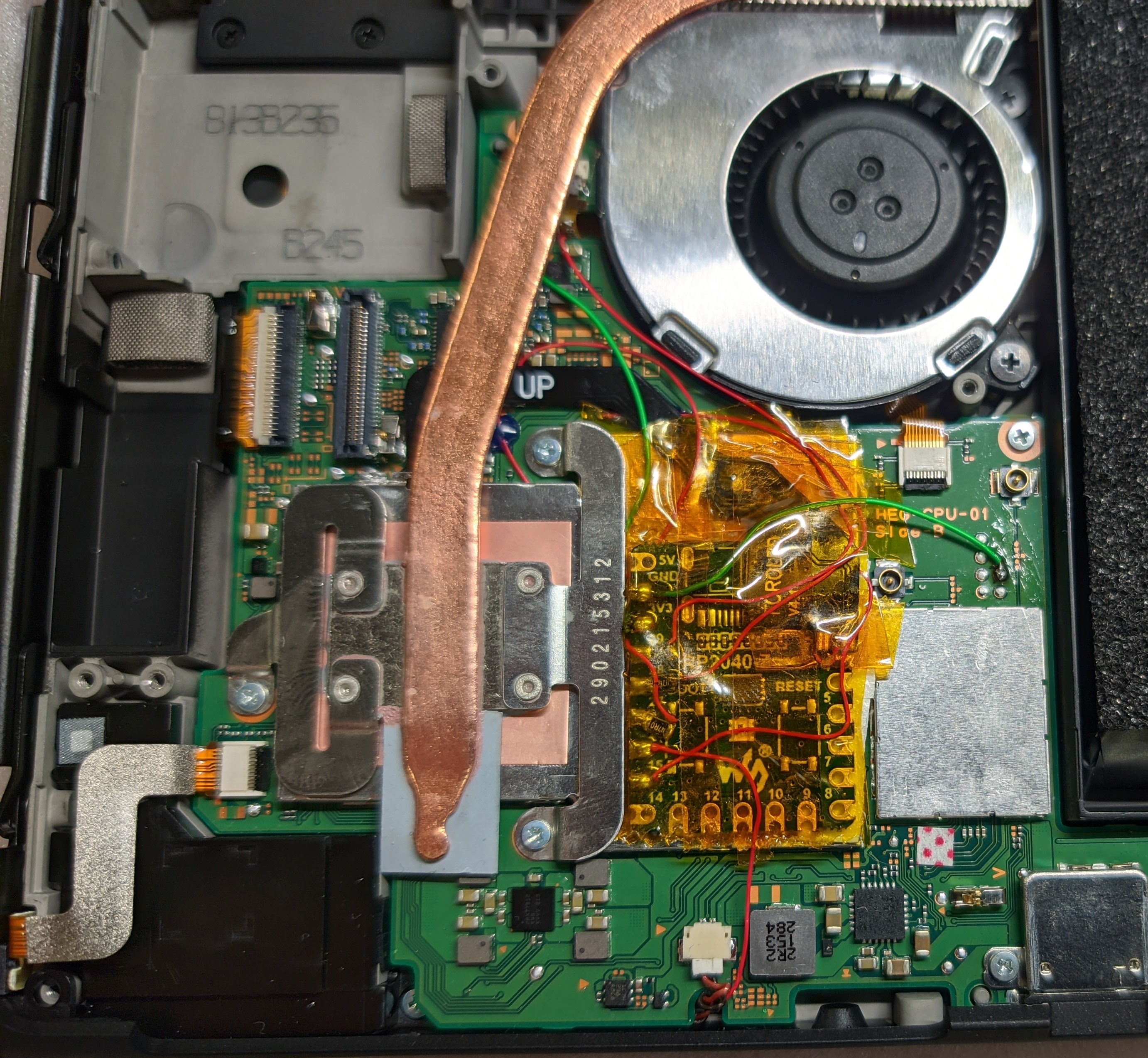

PicoFly install (with some messy wires) on SkHynix OLED with lots of kapton (:D), removed only the USB and buttons (voltage regulator is still there), everything fitted nicely and closed the shell without problems. Now I can have a beer while my gf enjoys Animal Crossing.
This is amazing!! Thanks again @rehius for making this possible!

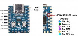

Hi guys. I have a question about flashing the rp2040 zero. I don't understand the process. Can someone please give me a rundown?
Plug it into your PC, copy over the first .uf2 file to the drive that appears. Chip resets. Unplug, replug, copy over second file. Chip resets. Done.
So first the firmware then the unlock uf2?
and i hold the boot button for both?
Yes and Yes (though the order doesn't matter actually since it flashes specific memory address for different files).

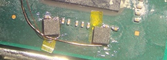

View attachment 363060View attachment 363059
You should need one of these two setups, since lites are all V2 boards. If you put one mosfet on and have problems with consistently glitching, then it's suggested to put the second mosfet just like the hwfly cable has.
or have issues with not glitching at all blue then cyan led

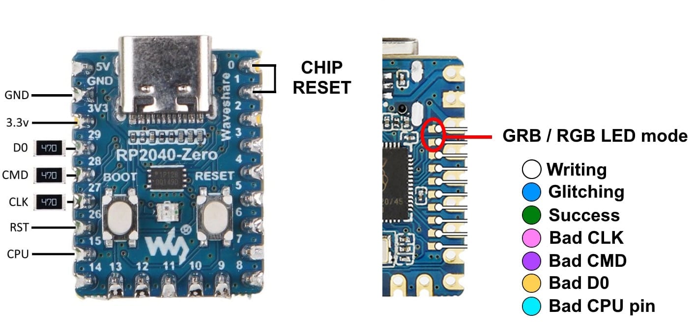

Ok thanks. I have the rp 2040 zero, after flashing the light goes green. Also after plugging it into my pc after flashing ( without booting it) the light goes blue and then white/cyan. Is that good?
I had as well green light after flashing, just solder together the two pins on the back to put the RP on RGB mode as already mentioned by rehius, so you get the RGB mode and could rely on LED color for troubleshooting if needed.
what problem happened?
Some weird sh*t for some users, don't remember exactly the problem and won't spend time digging the posts. Just flash both files and should be ok.
Do i have to flash it again after shorting ?
No need for that, this is only for setting the LED output mode for RGB.
When you install the PicoFly, by the end of glitching/training session you should get a nice green light and then the LED goes off.
