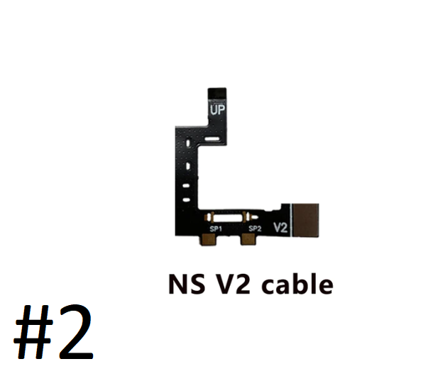

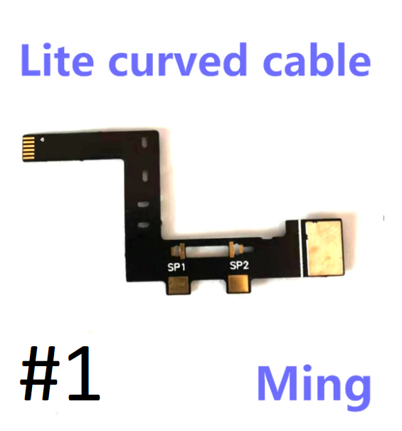

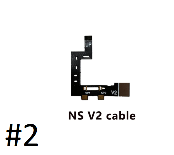

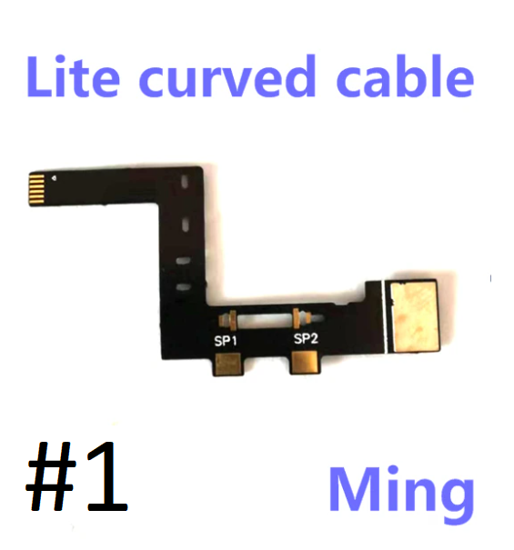

I purchased both of these flex cables to install on Nintendo Switch V2 and Lite. After doing a little more research, it seams like picture #2 will fit on all (V2, Lite and OLED)...is this correct? Thanks.
What will picture #1 fit on?
View attachment 363032View attachment 363033
There is some videos with people installing picofly on Switch Lite with V2 Flex without any problem.
That is the reason I ordered V2 Flex for my Lite project (and V2 Flex is cheaper than Lite).
