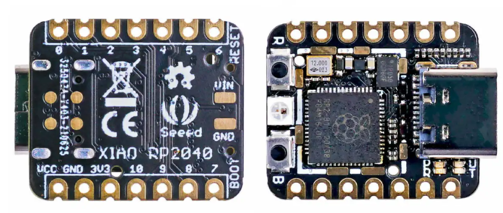

Could we please also have a firmware version for Seeedunio XIAO RP2040 as well?
It is a little bit smaller than RP2040-zero(21x17.5 mm vs 23.5x18 mm).
Also all SMD components are on the front side of XIAO, making its back side pretty flat.
The firmware for ZERO can't be used for XIAO because:
1. the RGB LED is wired to GP16 on ZERO but GP12 on XIAO.
2. GP15 (CPU) is not wired on XIAO.

There is an uf2 build for seeduino Xiao under fusee suite from Mattytrog.

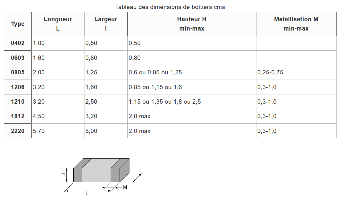

Non ha nulla a che fare con il valore.
Sono solo le dimensioni.
