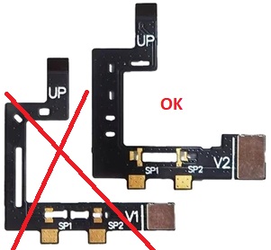

hello everyone, im interested in doing this install. i have a v1 trinket switch and have been reading about the rp2040 zero install but dont know how to start. im looking to buy a oled switch and am wondering if a certain version is better than another. also which version hwfly flex cables are best for oled? any advice is much appreciated.
It's best if you could find a Oled Switch that usees a non Toshiba/Kioxia EMMC but I dont think there is a way to know what Emmc chip is used without disassembling the console.
Even if you get (un)lucky and get an Oled with Toshiba, @rehius fixed this with the latest firmware so you should be OK.
As for the cables, any cable with the vertical connection for SP1 and SP2 will work (so Core cables, Lite Cables, Oled cables, all of them apart from V1).

thanks for the info. would a v4.1 hwfly flex cable set do? do i need a dat0 adapter? sorry for the all the questions. im trying to order a set and would like the right one
You are right, you do need a dat0 adapter for Oled. Get the yellow one with 4 anchor points, it is much more reliable than the black ones.
And yes, the v4.1 works. As I said, as long as the SP1 and SP2 pads are in vertical position you are good to go.
Since (i guess) it's your first mod I would suggest you go with the hwfly from aliexpress. com/item/1005004097100564.html?spm=a2g0o.detail.1000023.9.209c402bptEpi2
The price is ok now and its much easier to work with that picofly at this stage.

Hello everyone asking can i use switch lite flex on switch oled for picofly? Is this working or nah? TIA 😁
ahh nice to know thanks
