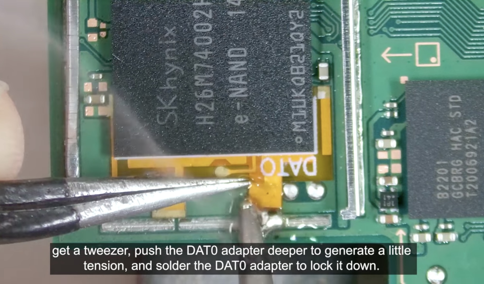

If properly installed and adequately secured this should not happen. Dat0 adapter works great! You must have pressure against the ball and adapter while securing down and is why adapters with anchors are preferred, i use tweezers to push the adapter in forward the Emmc solder ball while simultaneously soldering the anchors. But not much pressure, don’t want to damage adapter or break the small point on the adapter that makes the connection. I highly recommend the 4 anchor adapter.

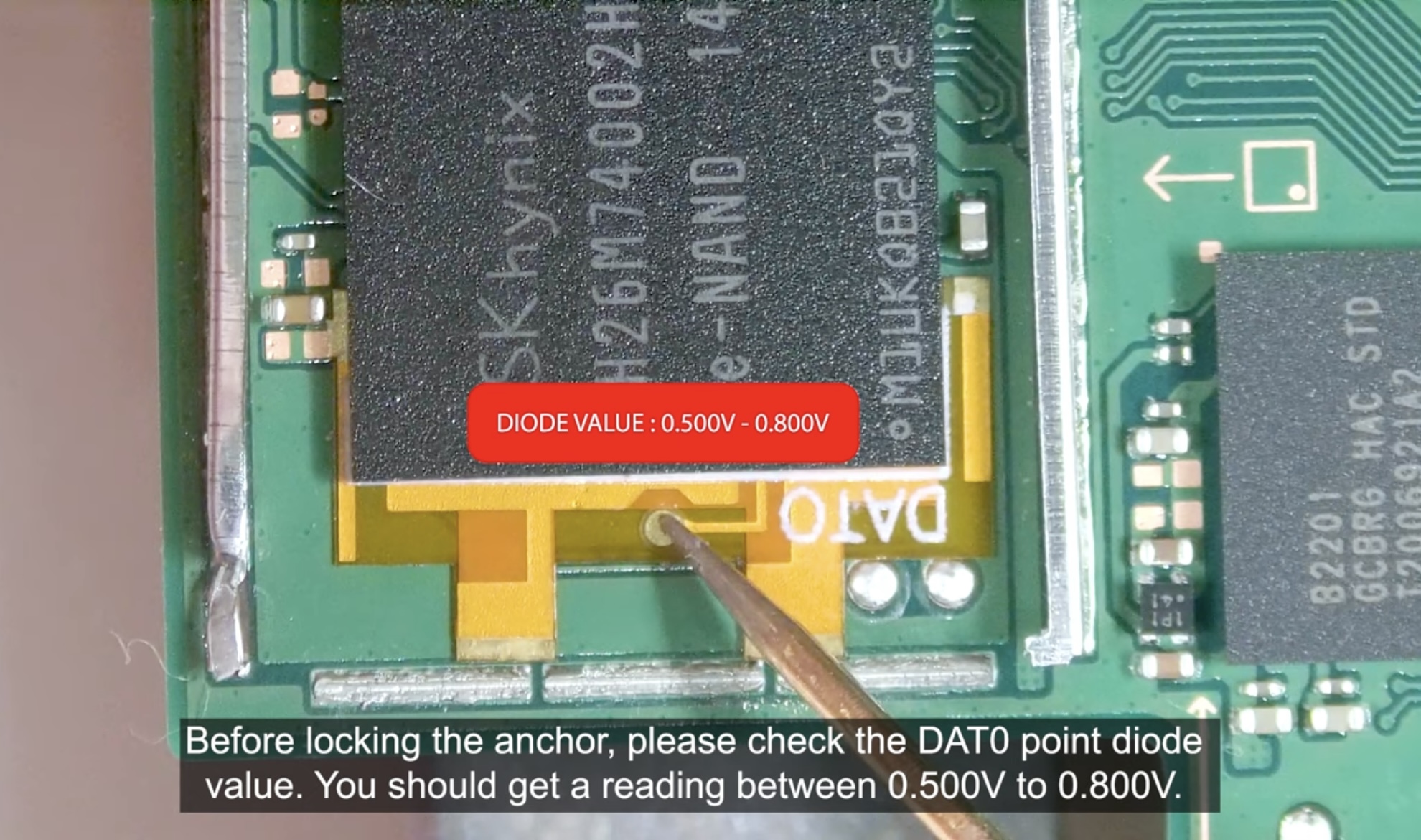

Test value of the Dat0 in diode mode (red probe on ground). Before and after soldering down!! Should be between .420V and .800V. (Edited to correct values as my own tested at .428)
Also I would recommend people check with a multimeter afterwards to make sure it's connected.
Test value of the Dat0 in diode mode (red probe on ground). Before and after soldering down!! Should be between .500V and .800V.
Thank Sthetix for the image:
View attachment 361468View attachment 361469
