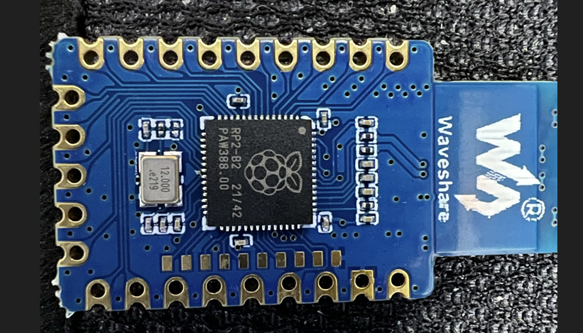

On the chip itself, it tells you the revision...
Oh yea mine is a B2 like yours. I chopped the usb on mine though.... sooooo rip
