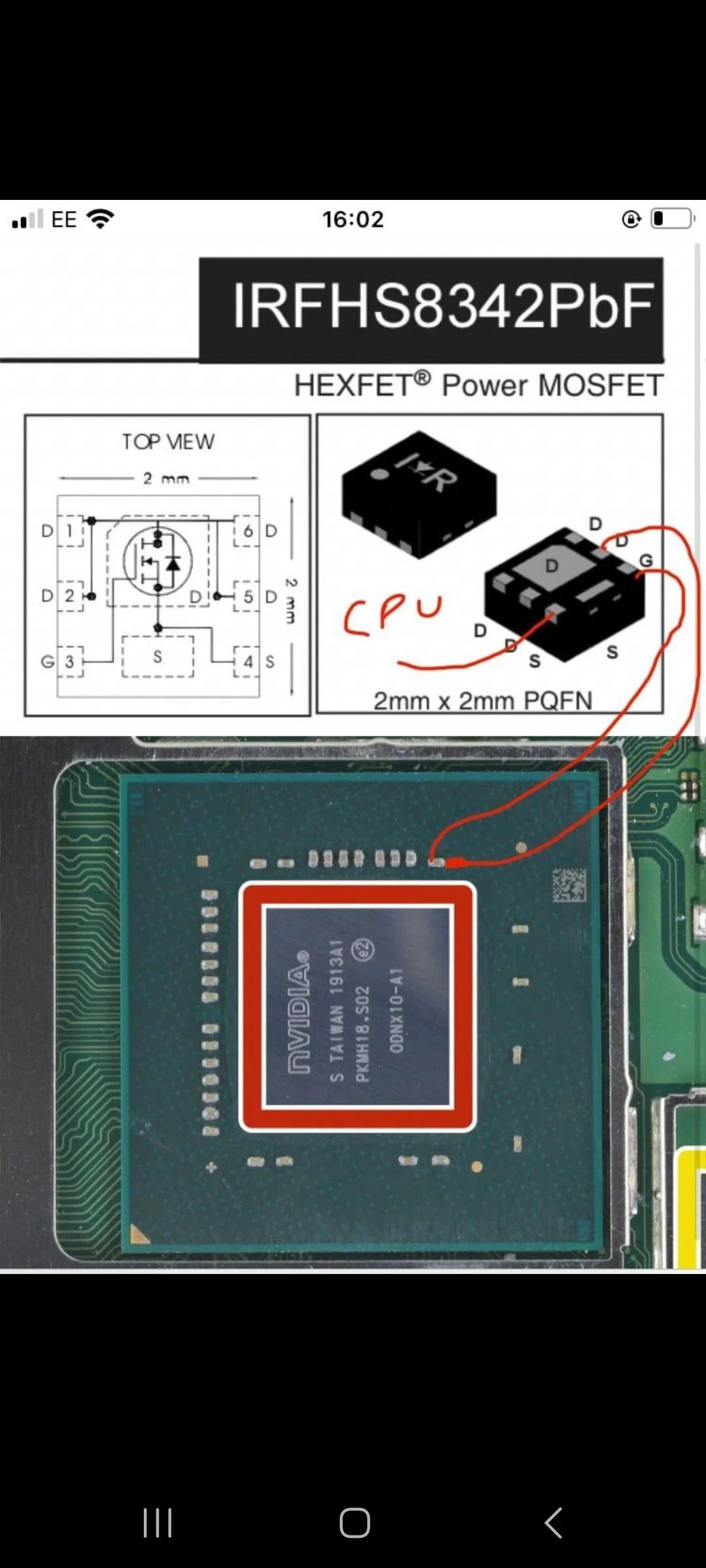

I was referring to the image below that has been flying around the forum and was on the post of Dee87 that I quoted, it seems that later he edited (and rightly so), since that connections are wrong.
First time I saw it was last week, and was asking if you could ask to edit/edit the original post, since I didn't knew who wrote it. Digging this morning, I think I found the original post and it was a question from vittorio regarding the connections here. I don't know why people took it and started using it for install, since it was just a question. Just wanted to signal this so others won't follow the same path.
The original post has the image removed, so this is good. I imagine it will continue to circulate on different posts here as it has been going on other thread as well. Until we get a complete diagrams for each console version, just remember that the schematic below is WRONG, the gate of the FET should be connected to the Pico, not to the cap.

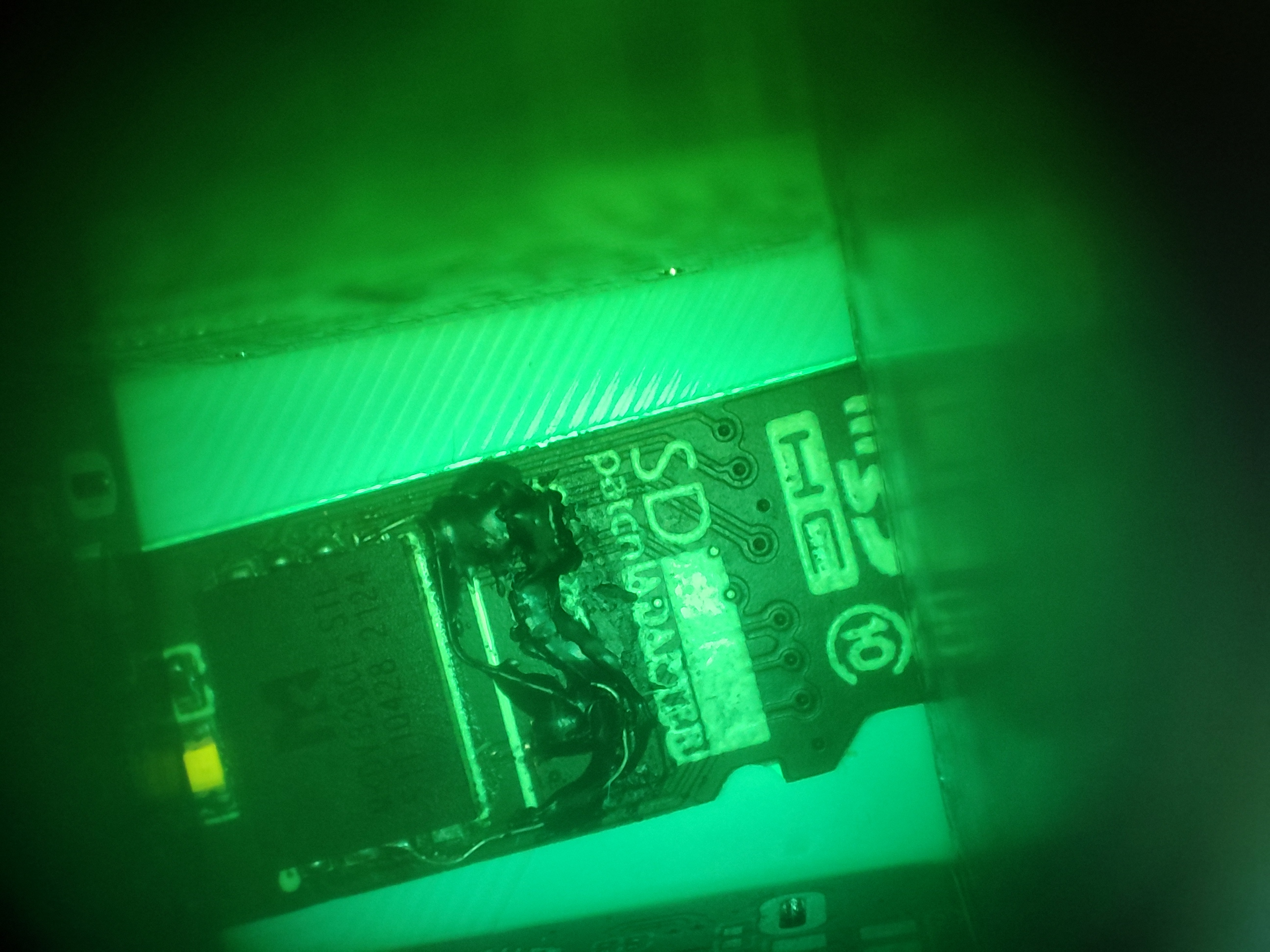

I was able to attach the wires to the pad area through soldering, but when I tried to move the wires slightly, the pads came off with the wires. Do you usually try not to touch the wires after attaching them, everyone?

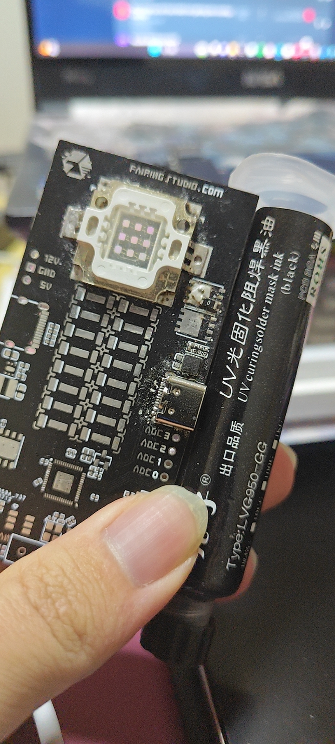

You can reinforce it with light-curing solder mask
UV LED & UV curing solder mask ink
Reactions: binkinator
I would like to reference this, but how much strength can be obtained if it is reinforced using it? Would it not move even if the wire is moved?
At least if you bend it with your hands, it generally won't fall off as long as you don't use force.
