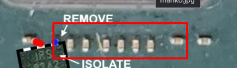

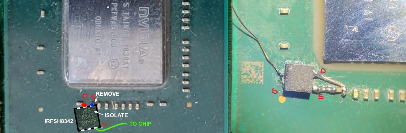

You got all that right but the resistors - They are 47Ohm not 470 and not 470k
Sorry they have the number 470 which means 47X10^0 ohms, meaning, 47 ohms.

www.digikey.com/en/products/detail/vishay-dale/CRCW060347R0FKEAC/7924025 0603
www.digikey.com/en/products/detail/vishay-dale/CRCW080547R0FKEAC/7922299 0805
I ordered 2 diff sizes to see what I like better

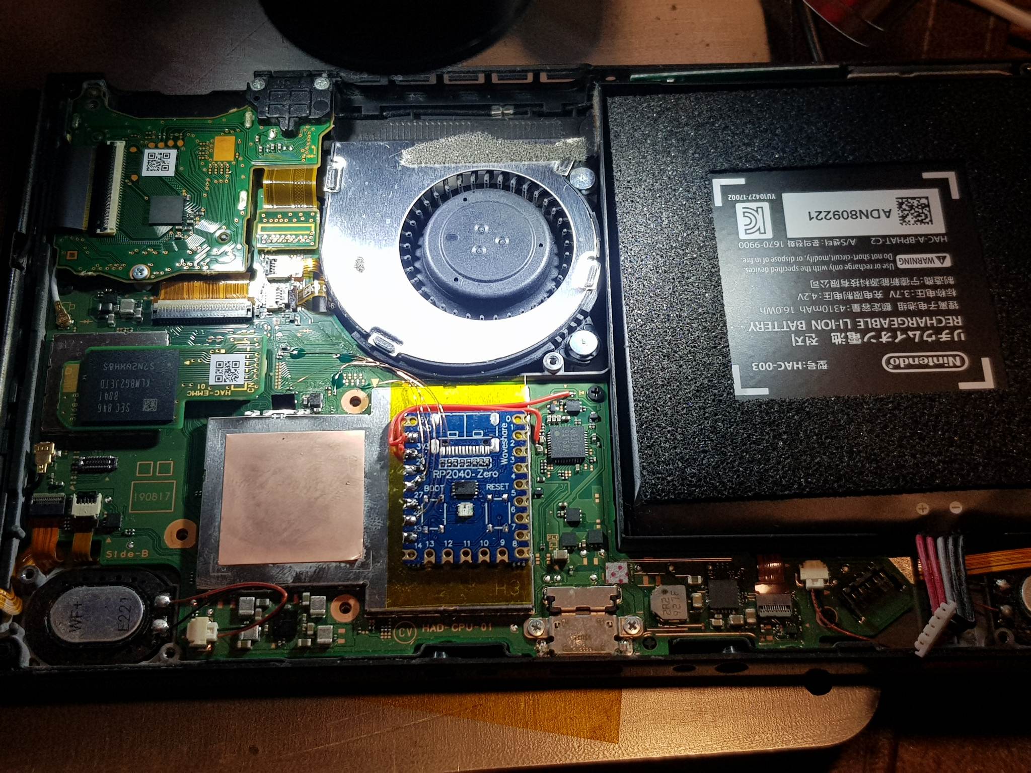

Does the pico usb c not need cc pin aswell I say this as if i use a standard usb 1.1 micro USB cable to usbc windows wont detect it
Does anyone have a pinout for us that removed the port of what we need to wire a usb cable back to the pico and to enable the missing boot button just to flash for software support in 2.6
