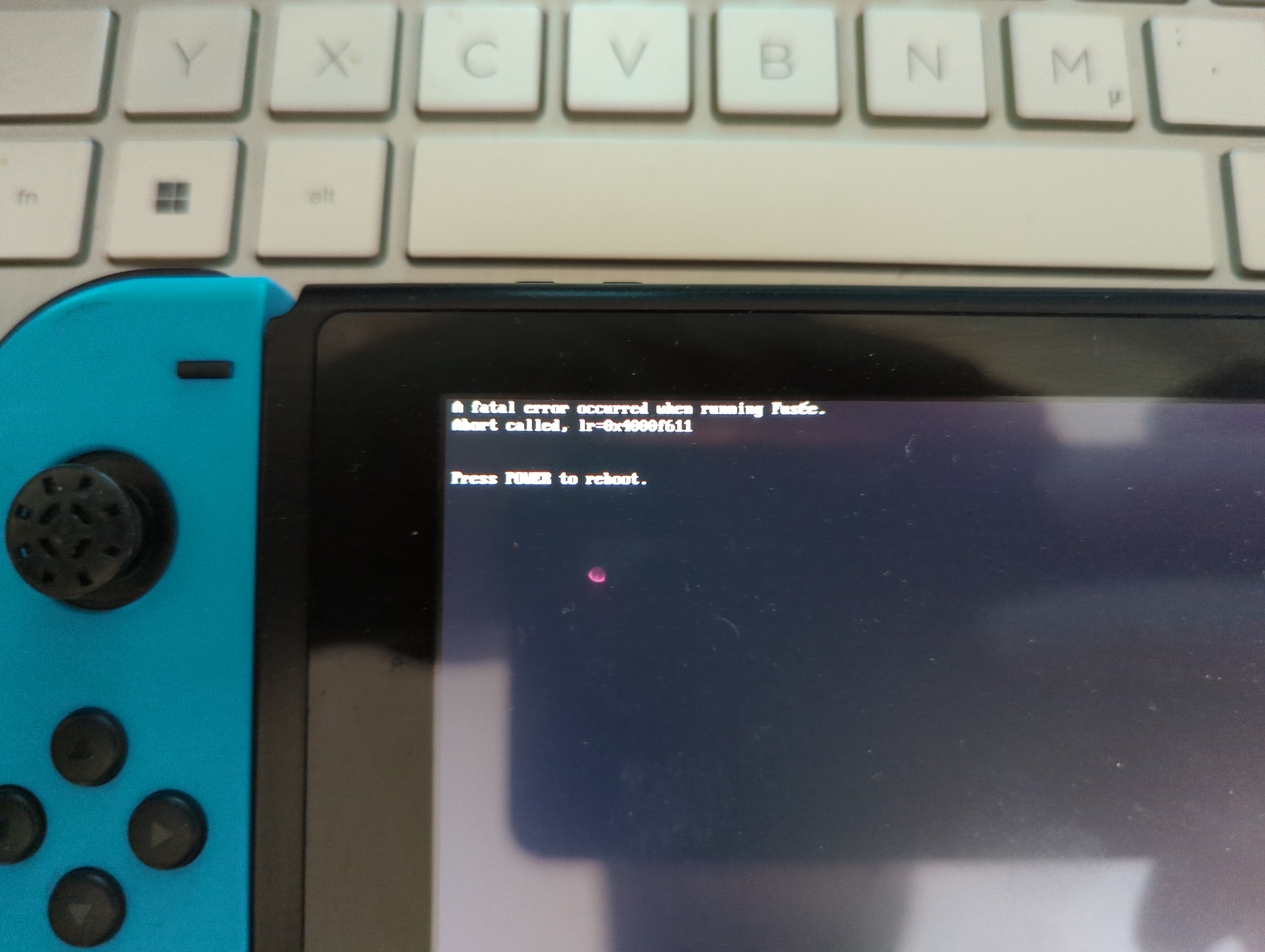

I'm trying to do the installation on my OLED but I get a blue light right after a white one and the device starts in the original cfw, does anyone know what it could be?
